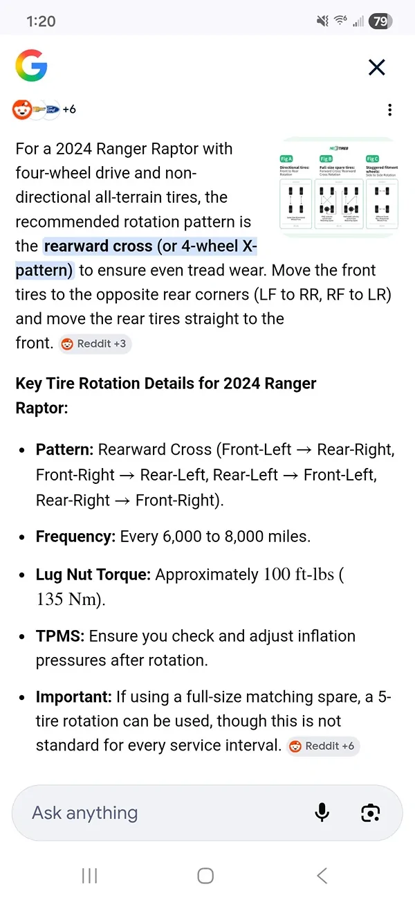

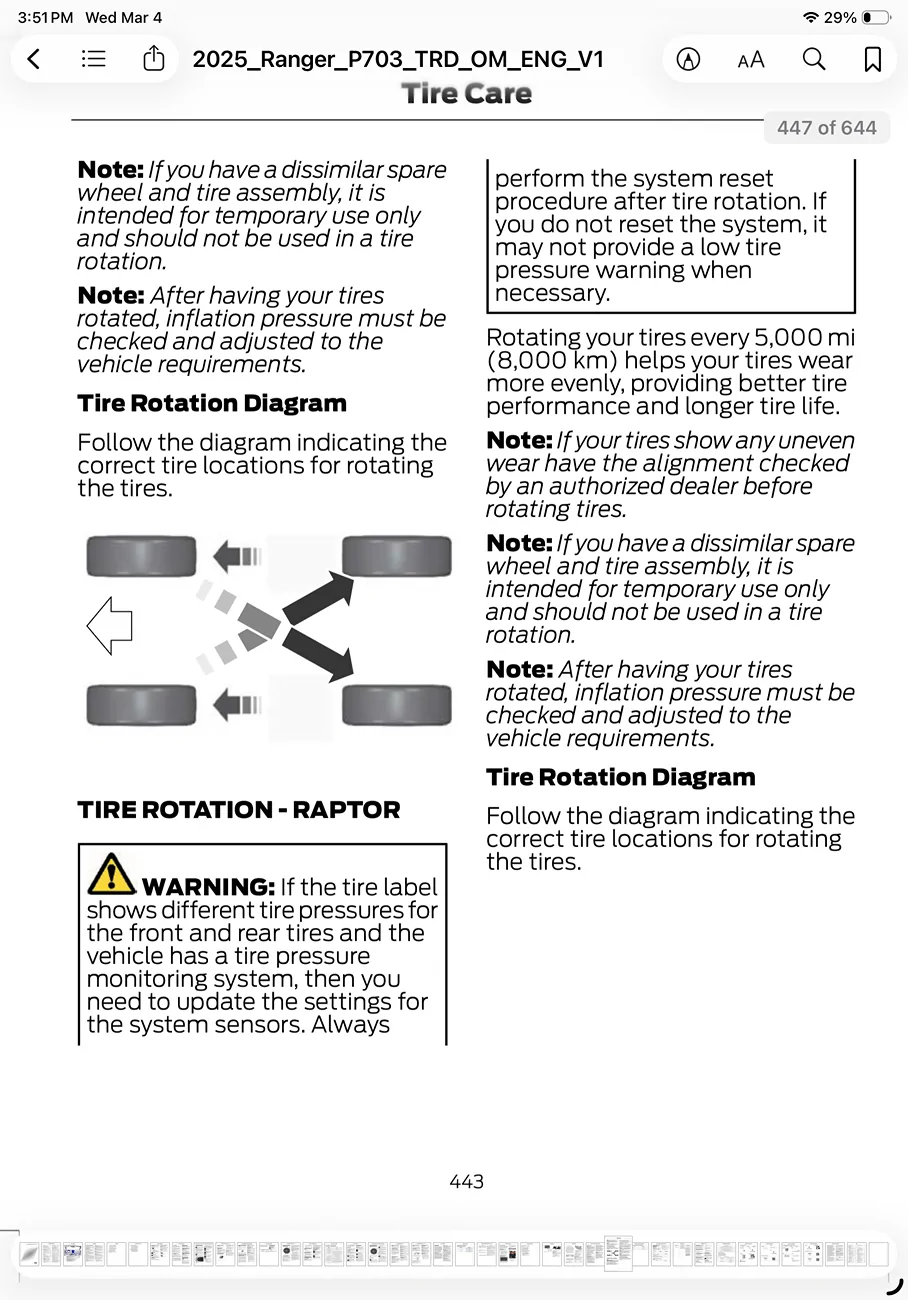

What's up all! Just curious if you guys are doing the recommended forward cross pattern tire rotation and if you're doing every 5k miles? One of my friends who works on cars sed I should just do front to back for spinning the tires in opposite directions will wear them out faster. I do know the K0'3s are not directional but just want to get your thoughts.
I did my rotation at the 10k and then 15k in the cross pattern as recommended in the manual. I found a local Mavis who does it for free.

Yes, even unidirectional tires should alway's rotate in the same direction.
Once you have done front to back and criss cross a couple times have the tires removed and flipped. Inside of tire is on outside.
