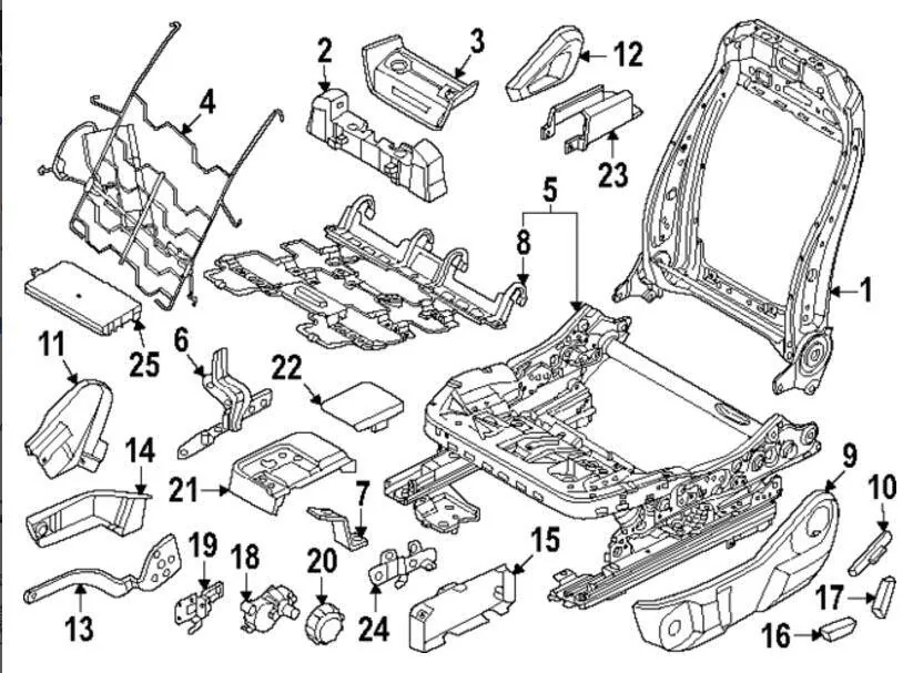

No, it does not .
I'm wondering why you say that though? Genuine question. In that diagram you posted, it looks like the #4 is the back-support to fit onto the #1 back frame, and it's the #8 that's the seat support?
