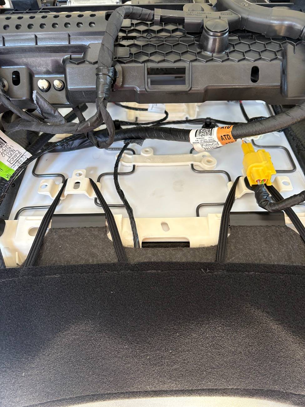

VanDam
Jacob
Nov 26, 2024
Victoria
2024 Ranger
I’m experiencing a similar issue with my Lariat. There isn’t enough support at the rear of the cushion, and the sinking causes my butt to go numb if I drive for more than 30 minutes. If you reach underneath the passenger seat, you can feel a thin piece of plastic sitting on top of the mat, providing extra support. My current solution is to find a similar piece of plastic and install it on the driver’s side. I’m hoping that adding this extra support will stiffen the seat and prevent the sinking.

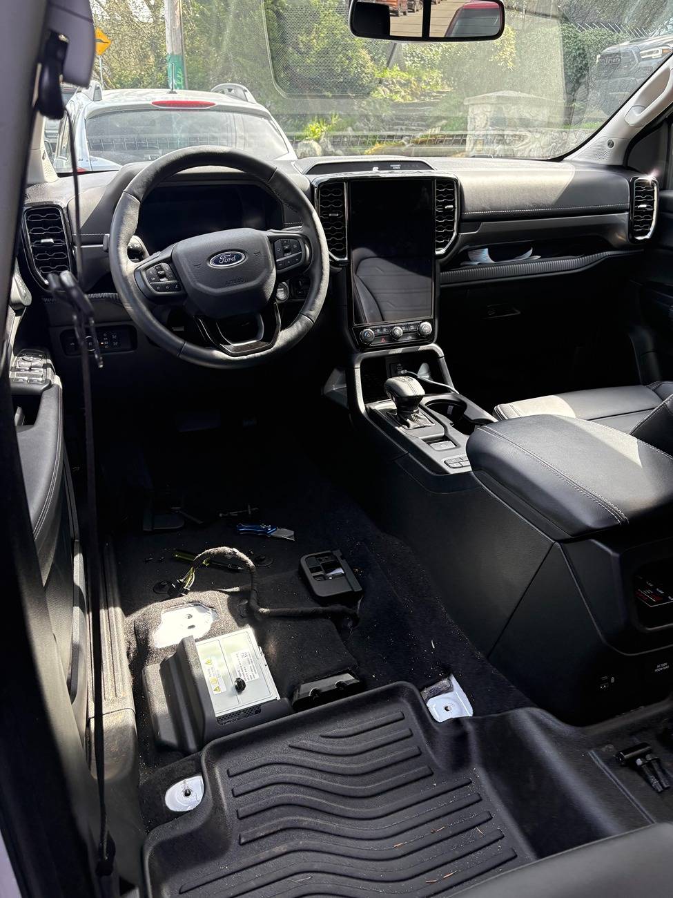

I added a sheet of 1/16" thick plastic between the cushion and suspension mat. I immediately felt more support; however, I haven't driven for any extensive amount of time.
Ford Ranger Seat base. IMG_6474
Ford Ranger Seat base. IMG_6476 (1)
Link to the plastic?? Please.
Rangerjimm
Sep 24, 2024
350
306
SC
2025 Ranger Lariat 2.3
Purchased a 2' x 4' sheet from Industrial Paints and Plastics for $24.99 and cut it to size. Only a 12" x 12" piece is needed.

I just looked under my 2025 seats. Its really weird that they have the plastic on the passenger side but not the drivers side for support? WTF?
So the foam was just sitting on the springs, w/o and liner, stock?
