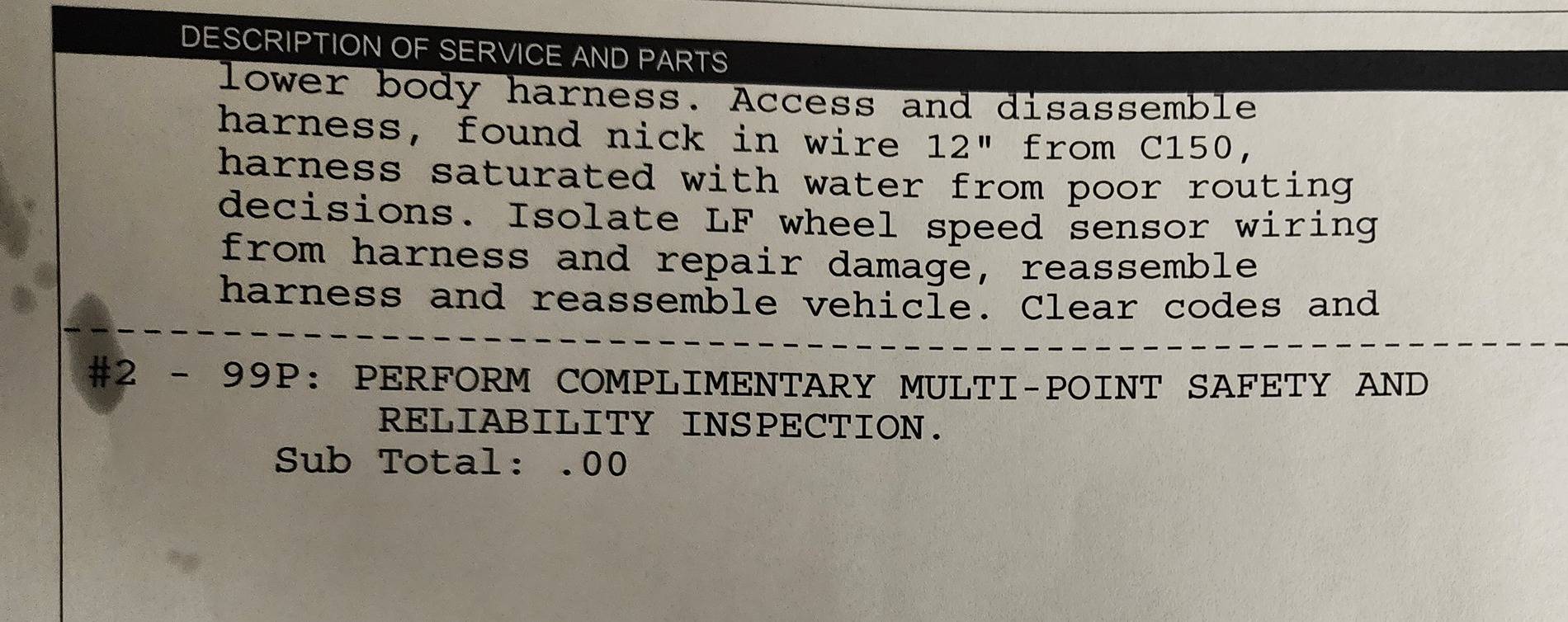

So final update:
Just got the truck back yesterday, they found there was a small cut in the lower body harness that was causing all the lights in my video. All better now!!
"Harness saturated with water from poor routing decisions". That's strange.

Interesting response. Geez.

2022 Maverick Lariat FX4
The wheel speed sensor wires on my Maverick are "protected" by black felt Tesa tape and I nicked them. And the wires are part of the main engine harness, so you can't just replace that small harness. Great to see Ford is cutting corners on 60k off-road vehicles too. ?
