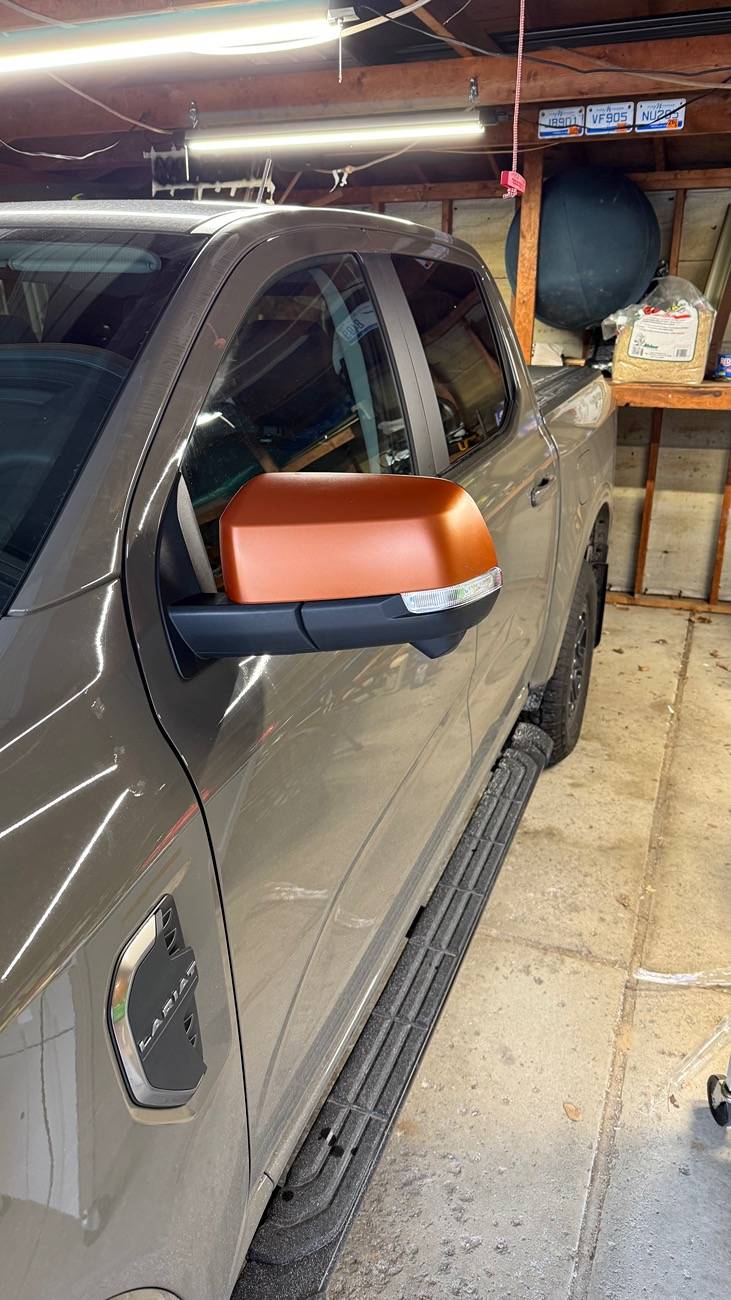

2025 Ford Ranger Lariat

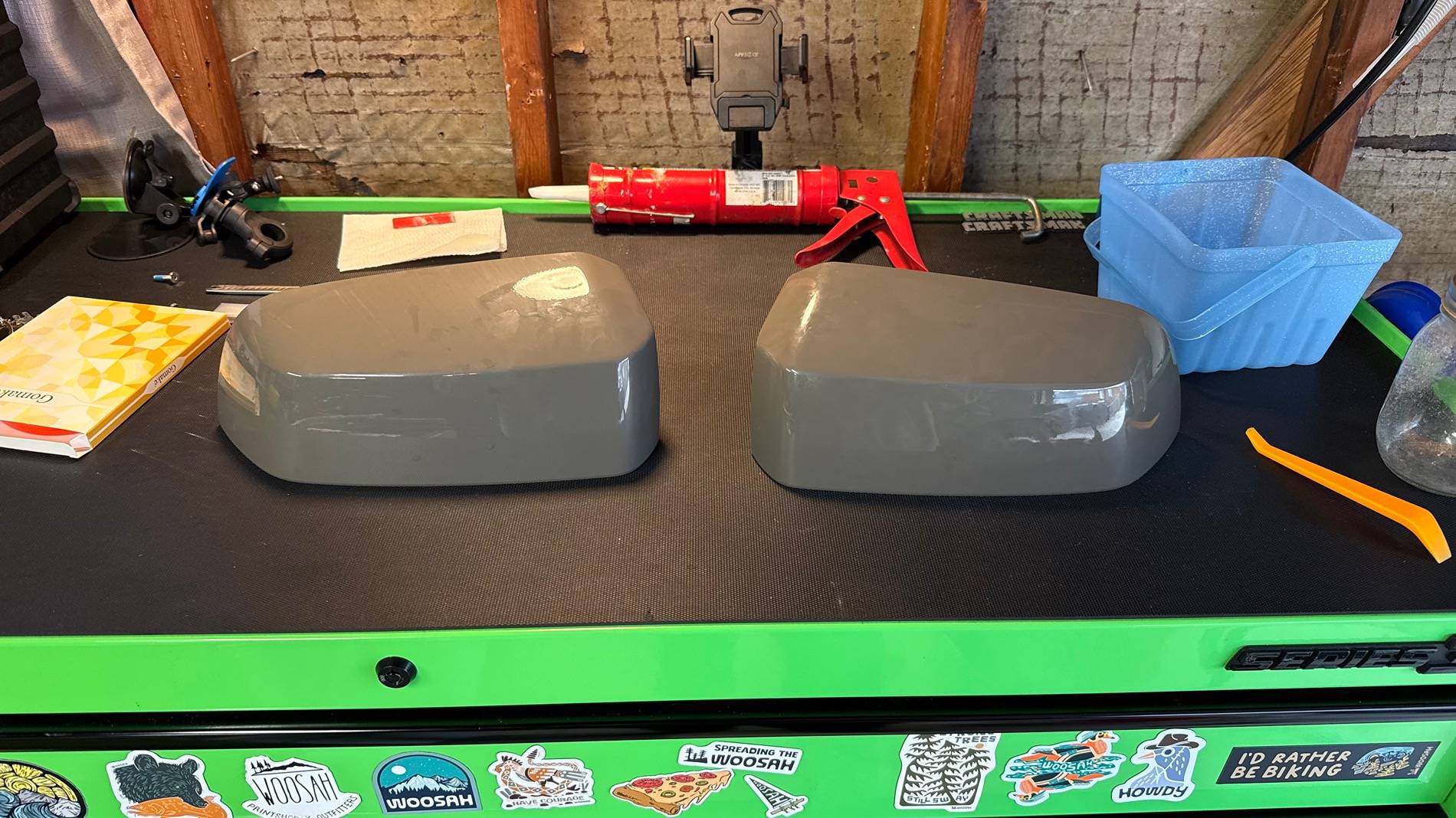

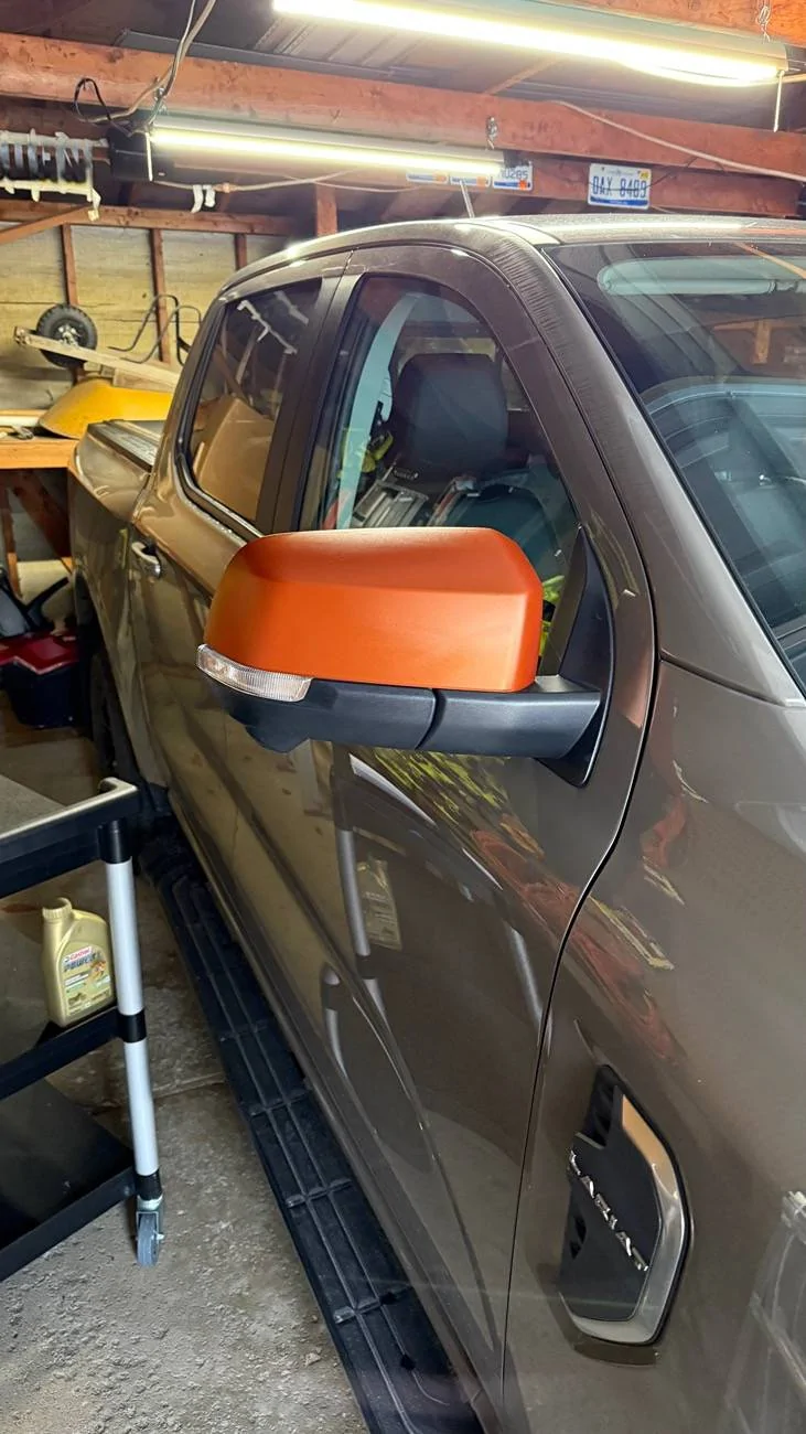

Figured out how to remove the mirror cap on the 2025 Ranger Lariat. Only videos I could find were from gen5 or Australian models. Was really easy actually and only required a plastic pick from an iFixIt kit. Wedge the pick between the skull cap and plastic mirror housing and work it around until all the clips are undone. Then slowly pry it off. Vinyl wrapped the mirrors a nice matte metallic copper. Taking the skullcaps off also allows you to swap out lights and do any maintenance work on the mirror!
