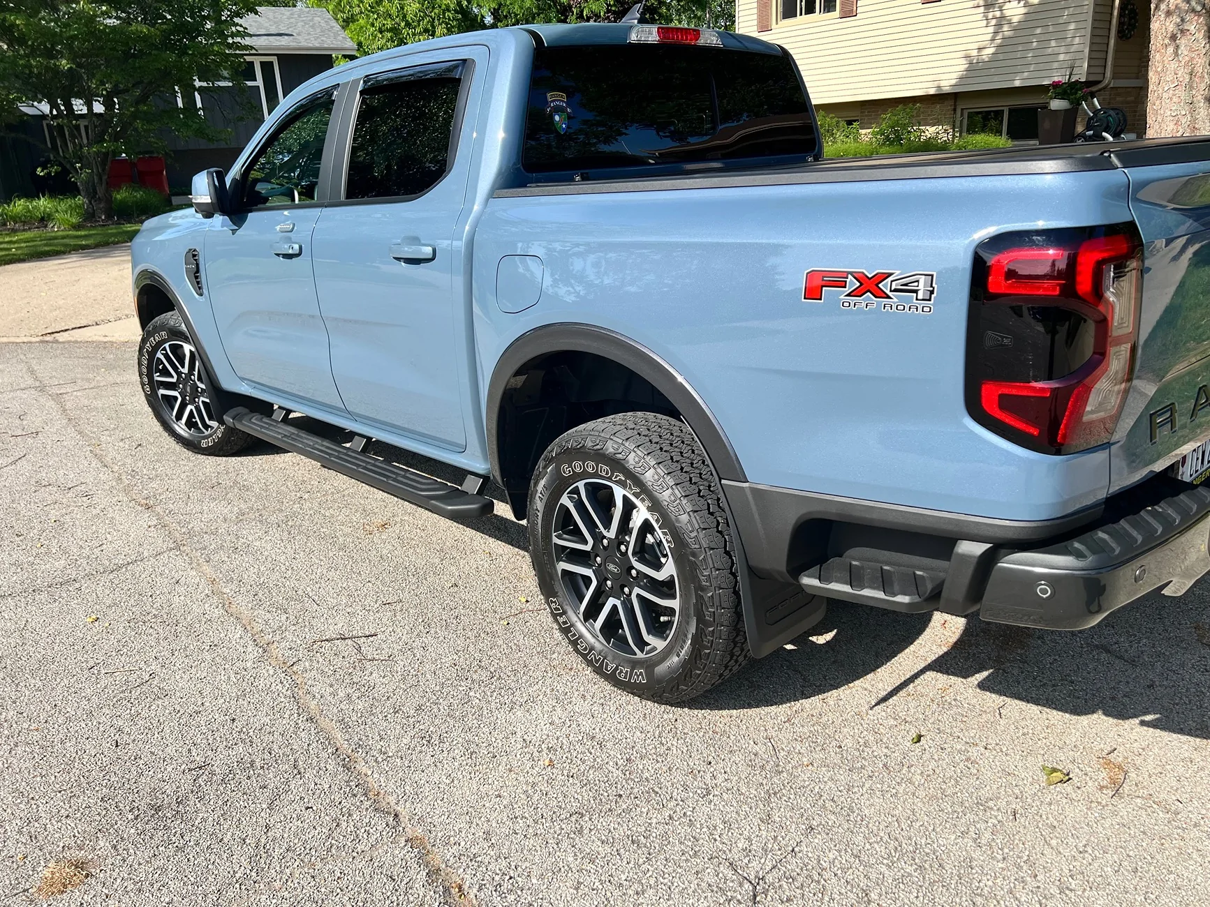

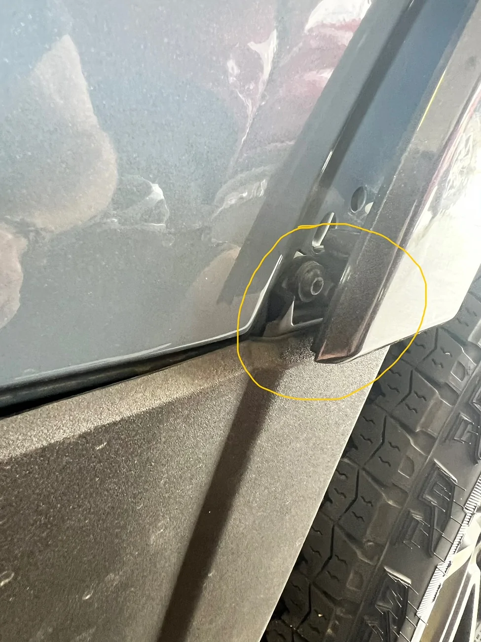

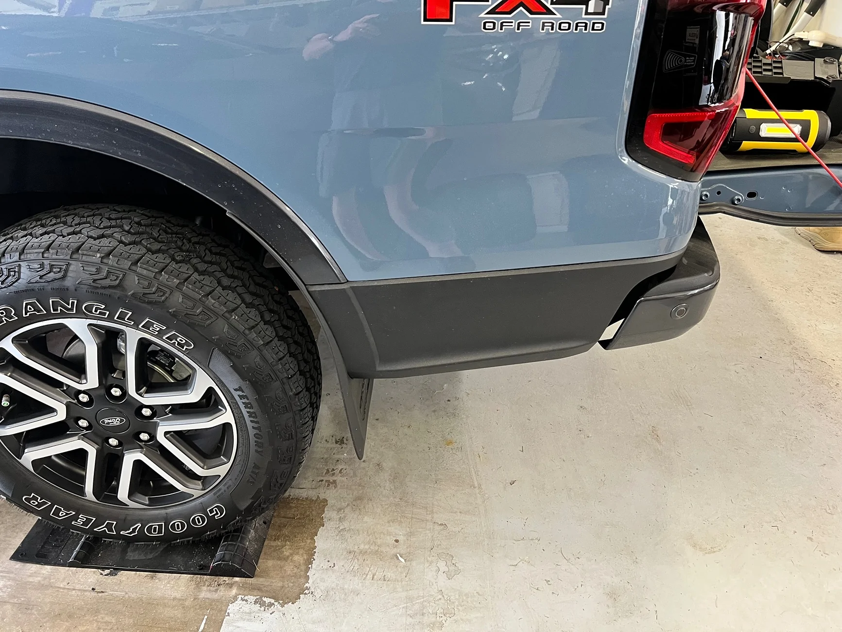

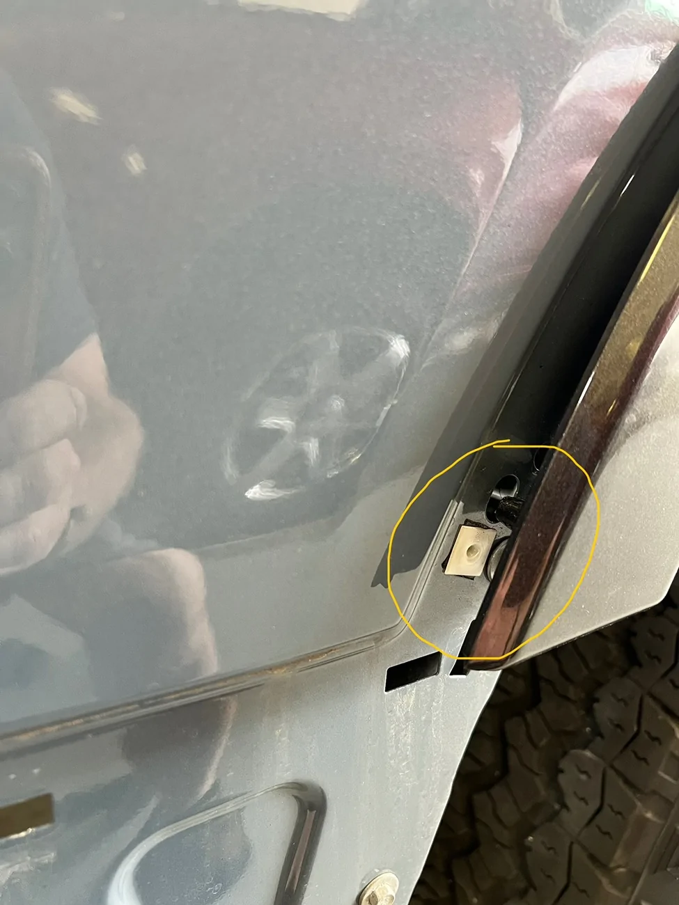

Thanks Superj for your write up. I installed a set this weekend. Went through an eBay seller instead of Alibaba.
Pretty straight forward installation if one understands even though there is good room there are many awkward angles to get to the clips to release the panel.
Also, keep in mind that you have to loosen the wheel flange in order to get to the screw that secures the front of the panel. See photos.
Lowering the bumper is not optional it’s necessary.
I recommend having some plastic push pins on hand because it’s easier to cut some out using side cutters because they won’t unscrew.
I have a second set if anyone is interested.

3,975
3,832
those look great!!
i use mine all the time. what a heck of a great upgrade those steps were.

I use mine too all the time too, I'm 6'2" with ling legs and that bumper is just that much too high

Good luck.
The screw hidden behind the wheel flange is torx 20.

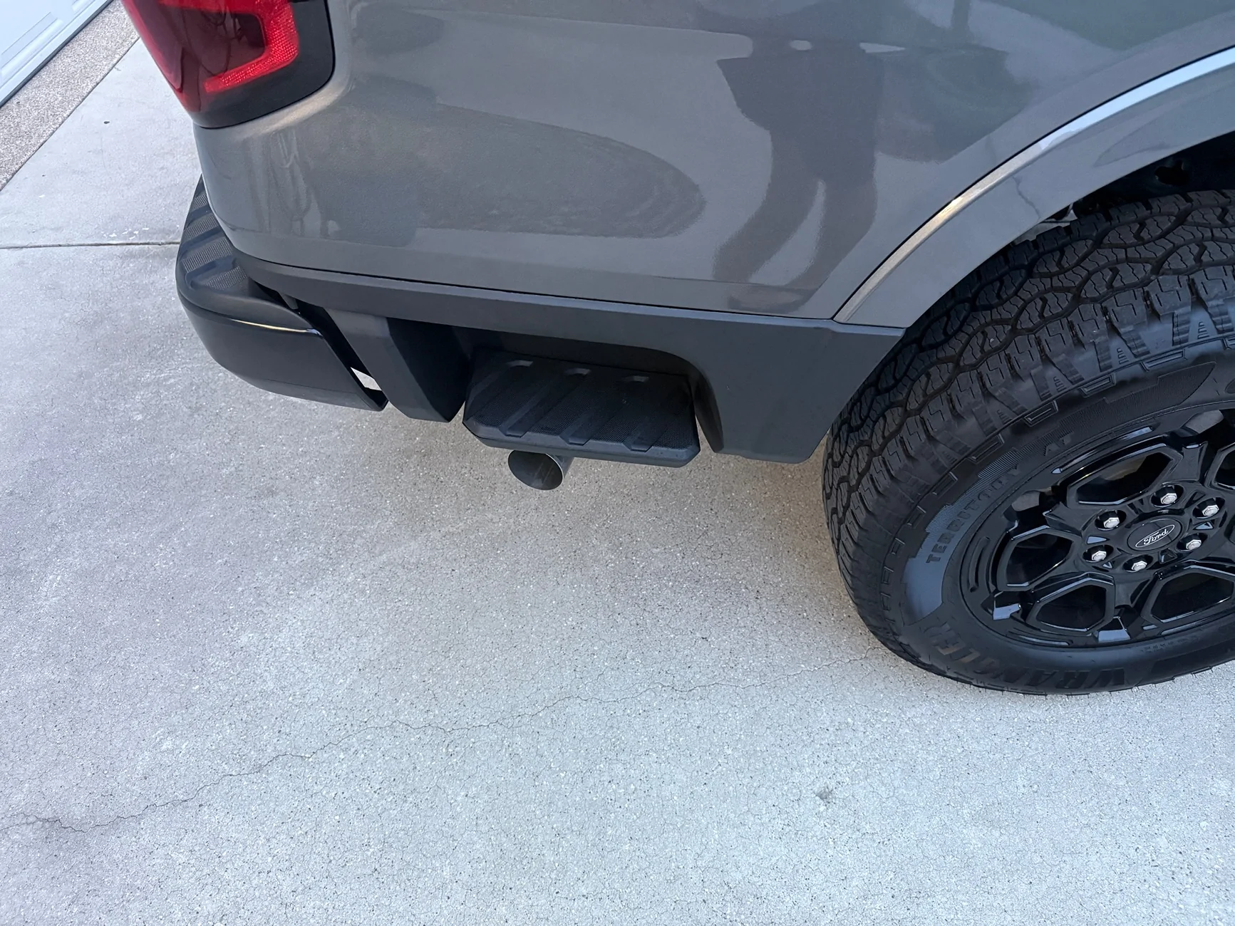

I installed a set last week. 1/2" impact made quick work of the 6 bumper bolts and the 4 mounting bolts. I do suggest transferring the foam/rubber washers that are on all of the oem white clips to the new ones. Holds it that much tighter with no rattle.
I think for the money it is a good quallity kit. Im 235lbs. It holds me up no problem...or flex.

Looks good. Where did you source the step?
That looks factory. Exactly how it should
