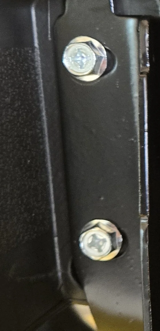

These two darker bolts are 14mm head (i think). Pull one out and check your stash or go buy some before you start.

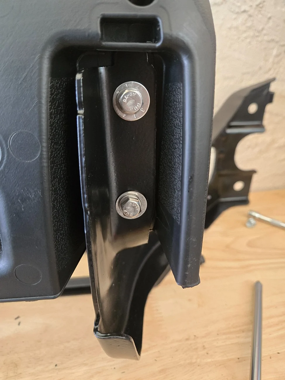

Now those bolts you bought and the two you unscrew will be used to hold your step up. I failed to take a picture but there is a tab on the step at the rear mount that slides into a slot on the truck. You can see the slot in the pic where the two empty bolt holes are. There is a locating pin that sticks off the forward mount that needs to be slid between the fender liner and the will hold the step up while you tighten the bolts. That is why you took the last push clip out of the fender liner in that pic above.
With the bolts tightened, you will be here now. See how the fender liner is still sticking out from when you popped it forward a little to put the step alignment pin in? Well, put that back in properly before you put the new plastic panel on or you are going to get more practice undoing those damn white clips from earlier. That will add some time.

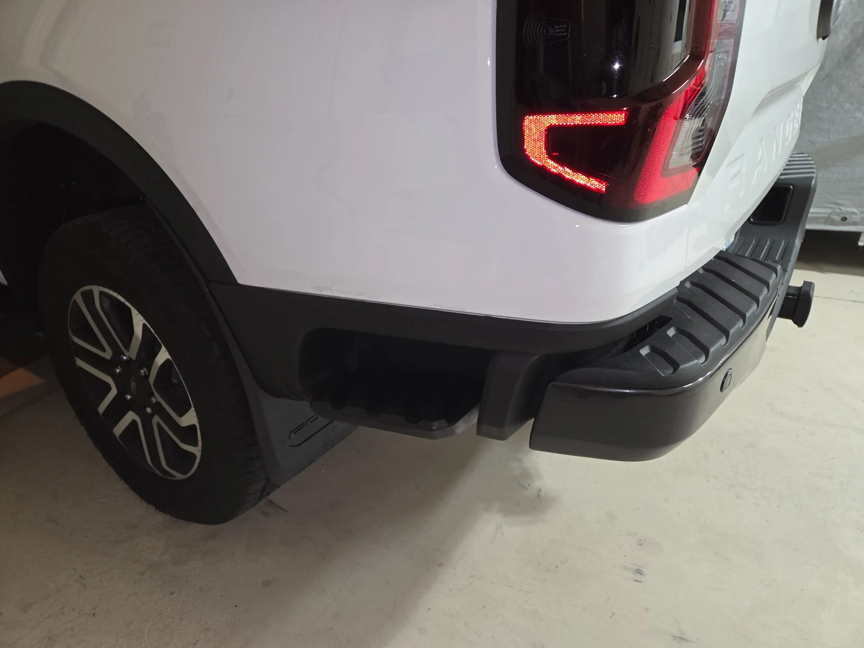

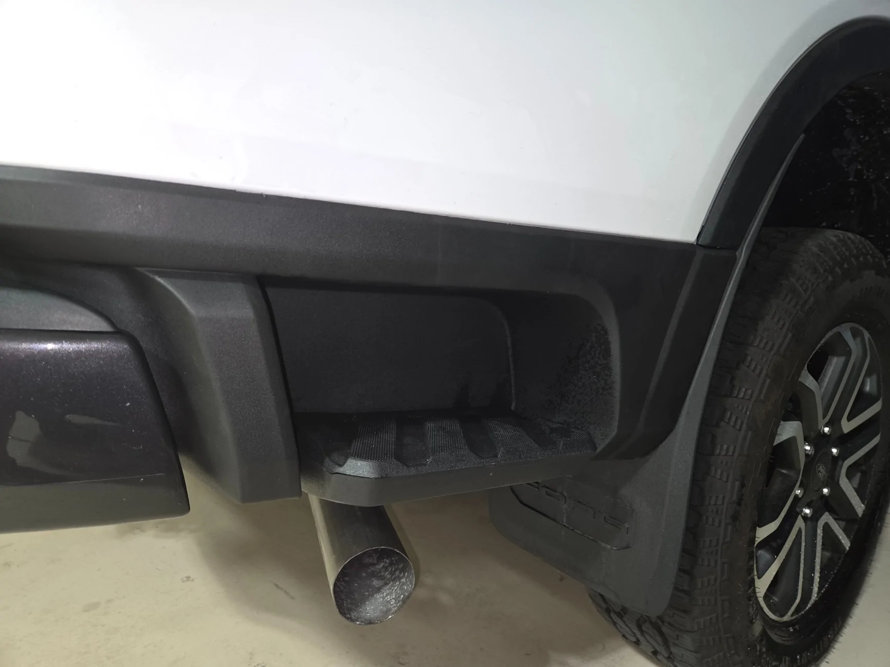

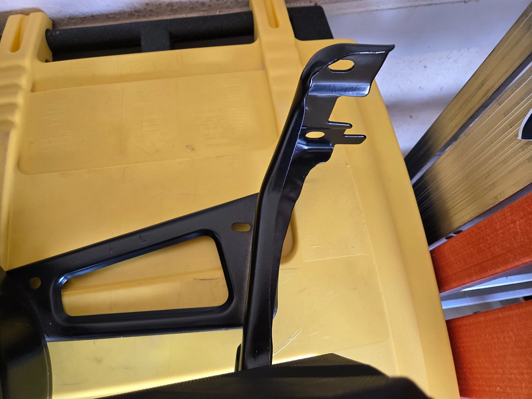

First off, a huge thank you to Jason for figuring out how to install these without any instructions and taking the time to document the process. That was incredibly helpful.
A few general observations before getting into details:
  • Eat your Wheaties before starting — the bumper/trailer hitch M16 factory frame bolts require some real muscle to break loose and tighten. Torque: 146 lb-ft (195 N·m).
  • Expect the install to take longer than you think.
  • The driver’s side is noticeably easier to install than the passenger side.
  • Don’t try to skip any steps in the process — it’ll only make things harder later.
My impressions after installing them:
  • Appearance: They look good and are very close to factory in terms of styling. The new trim piece integrates nicely.
  • Sturdiness: They’re not as solid as the factory steps. If you step on a corner you can feel some flex. A friend of mine has a Ranger with the factory steps and those are completely rock solid.
  • Build quality: Just average in my opinion. Mine arrived with missing paint along some edges, and the coating overall seems pretty thin.

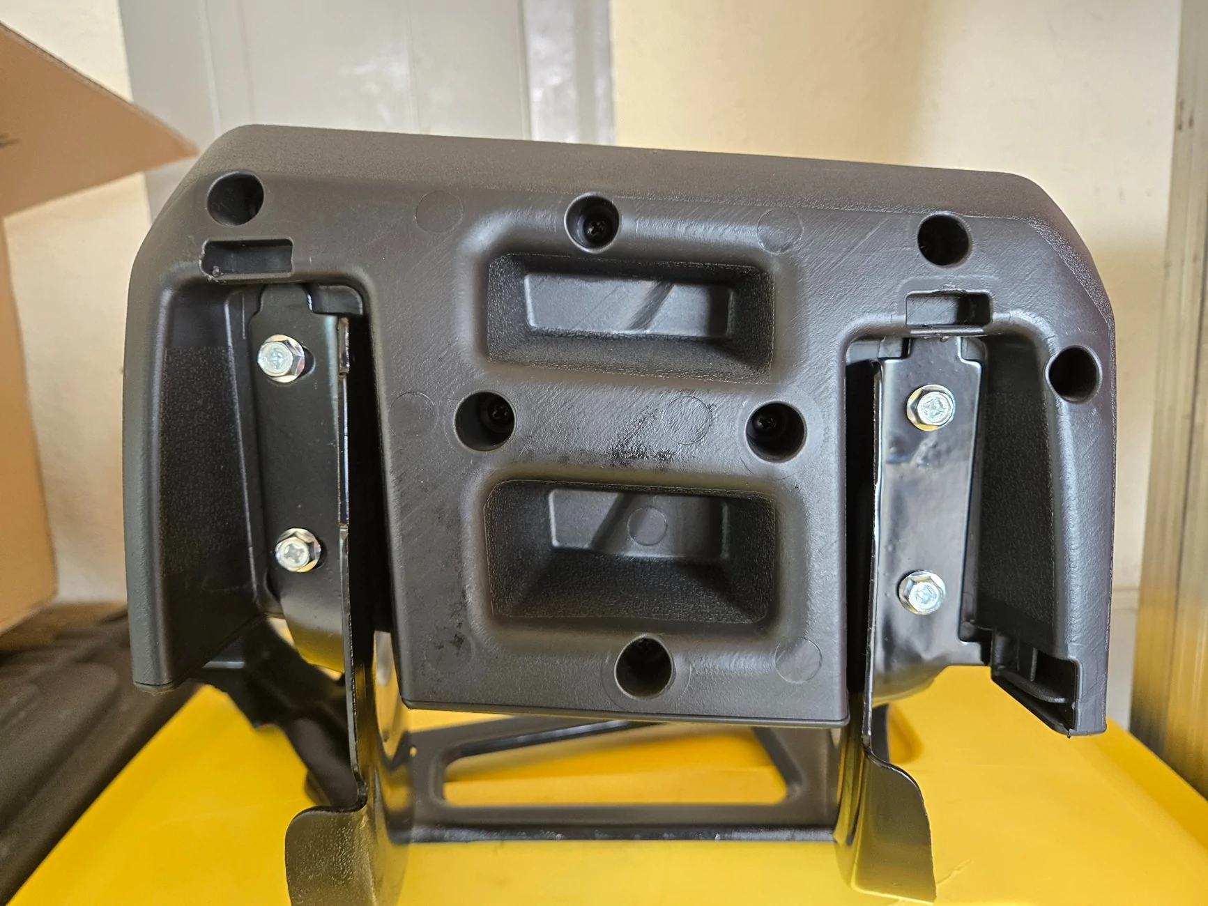

  • Construction: I took one apart out of curiosity — the step itself is 100% plastic, with the bottom section screwed into the top.
  • Hardware: The bolts that attach the step to the bracket are pretty cheap. I replaced mine with stainless steel M6x15 bolts.
One thing to watch during installation
Be careful of a small black-wrapped wire on the driver’s side. Once the bracket is installed, it sits close enough that the wire can rub against the step bracket. To prevent chafing, I simply zip-tied it to the larger wiring harness nearby to keep it safely out of the way.
Rust concerns
If you live in the rust belt, I’d be a bit concerned about long-term durability. The paint coverage is somewhat sloppy and the supplied hardware isn’t great.
To help with that, I coated the brackets heavily with BOESHIELD T-9 Rust & Corrosion Protection/Inhibitor. I’m sure Fluid Film would work just as well.
One frustrating issue
I ran into a pretty ridiculous problem during the install. One of the two factory-installed bolts (the ones Jason shows in his photo) on the driver’s side was cross-threaded from the factory.
Let’s just say my wife probably wondered who I was yelling at in the garage while working alone.
Because of things like that—and the questionable paint—I’m keeping the factory trim pieces. If these ever rust out or need to come off, I’ll want the option of putting everything back to stock.

Note on the rear bumper/hitch bolts, Ford uses large M16 fasteners because the hitch is part of the frames load path - effectively part of the truck’s rear structure. When towing, loads from the receiver transfer through the hitch crossmember into the frame rails via those six bolts.
At the factory torque of 146 lb-ft (195 N·m), each bolt generates very high clamp load. Across all six bolts, that adds up to well over 100,000 lbs of total clamp force holding the hitch structure tight to the frame. That clamping force creates friction between the hitch bracket and frame, which is what actually carries most of the towing load rather than the bolts taking the load in shear.
The bolts don’t carry the towing load directly. Instead:
  • The clamping force squeezes the hitch bracket to the frame
  • Friction between the steel surfaces carries the load
  • That’s why proper torque is so important.
When you remove them for steps or hitch work:
  • Breakaway torque feels like 200+ lb-ft
  • Clean the threads
  • Start bolts by hand to avoid cross-threading
  • Snug them first, then torque in stages.
  • Alternate left/right sides so the bumper reinforcement seats evenly.
  • Torque back to 146 lb-ft
  • Recheck torque after a short drive

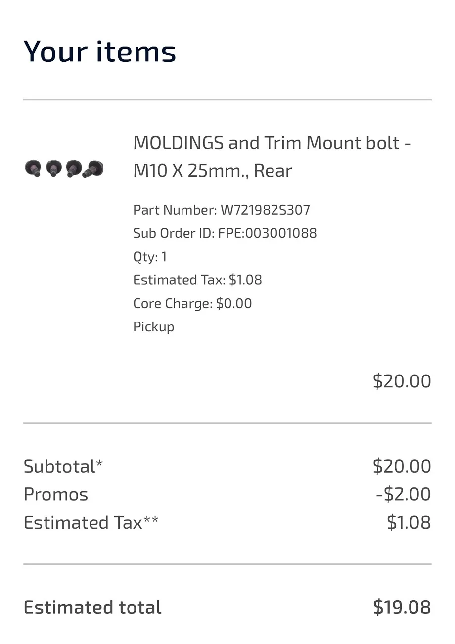

I received the steps today, now I have to figure out the right bolt size. The one's I ordered from Bolts and Nuts are way to small.
That is totally my bad. I went off another post that had multiple ford part #s listed and they described those as being the ones for the steps. I knew when I got them they were too small.
These 100% work: M10 x 25mm Flanged Hex Head Bolts
I was able to order these directly from ford and these are the right ones ;)
