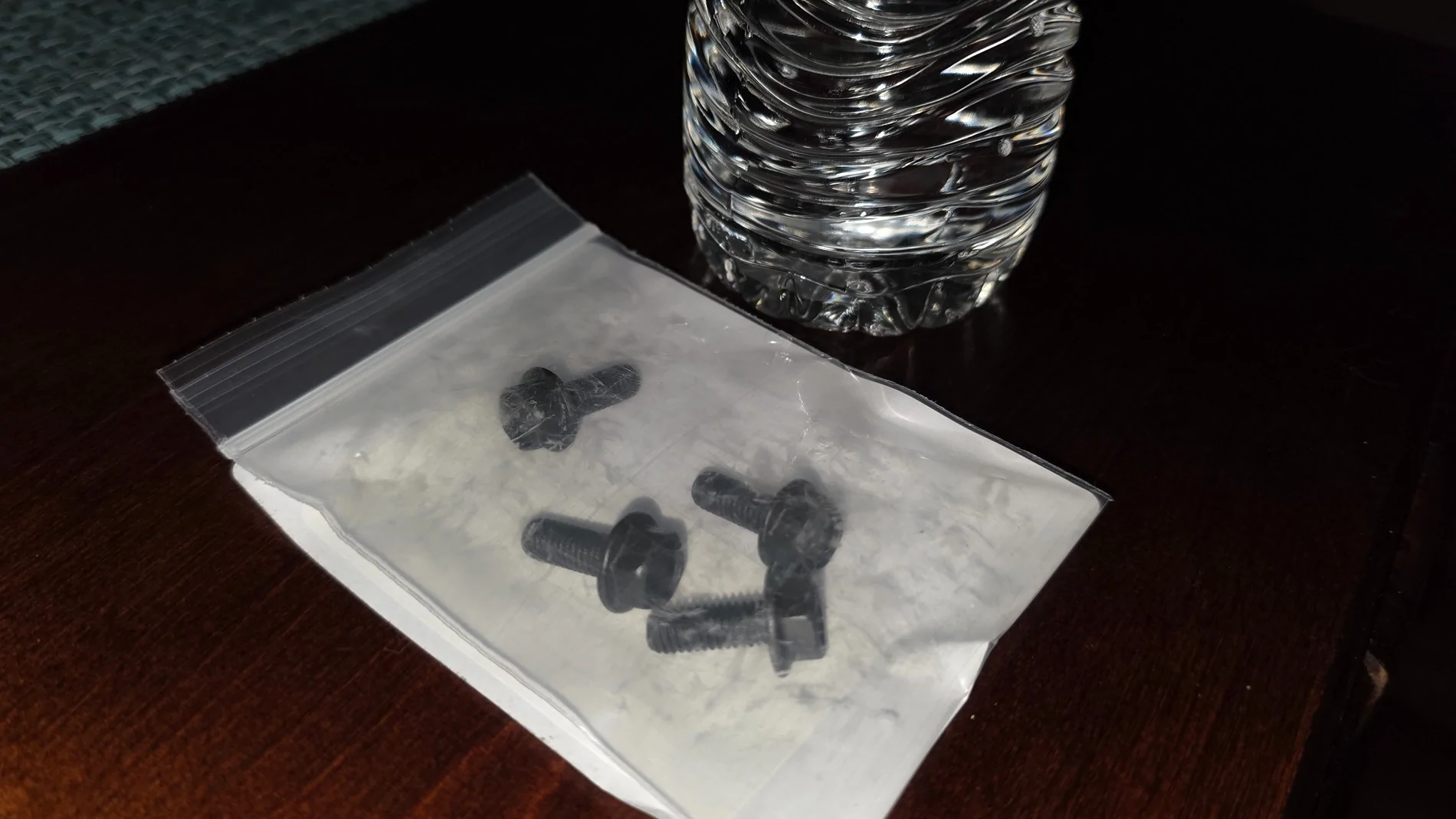

@superj , do these bolts look right? M6x16 (16.9oz water for reference) they seem small to me, but I also haven't see the running board bolts out of the truck either.
They look small to me. There are 2 on each side of the truck already.

are they a 14mm head? thats what mine were
