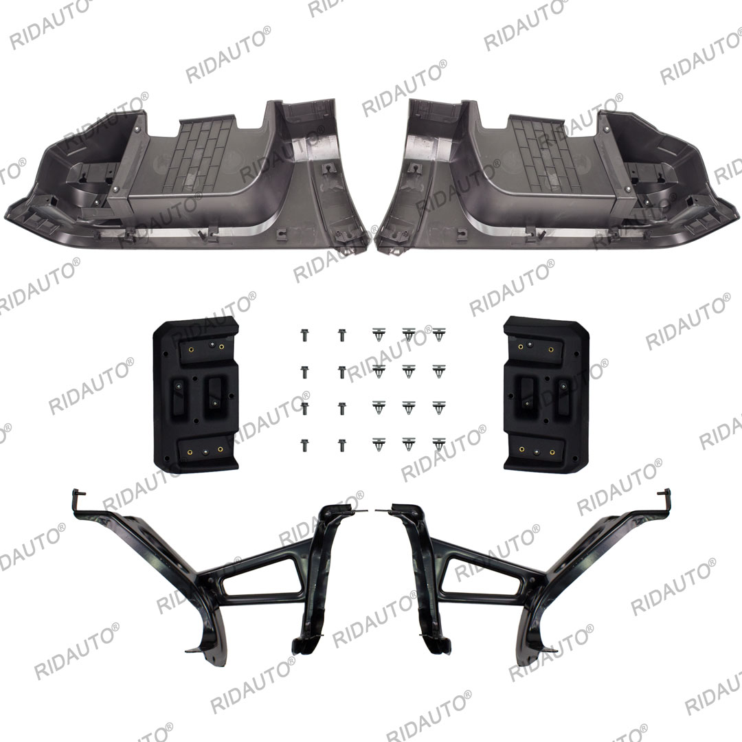

I would. Be very interested in these. I sm older.,have leg issues , hard to access the bed in my XL. But im not very handy as far as install. Looks like price is per step. . I would like to get a in bed tent for occasional camping. This would mske it much easier to get in an out.
Thats the kit, both left and right

Excellent write up Superj, I just installed my bedside steps Sunday, I ordered my step kit from Alibaba, they were $125.00 for the complete kit, but there was a $142.32 import charge on top of the shipping charge that was $37.84 and then sales tax, the total was $321.13 to my door. It took about a month to get them. very pleased with the way they fit and look, you can't tell the difference from these and the factory steps. Like superj said they are not hard to install, once you get the original panel removed the reassembly is a breeze, The only complaint with the install was why did Ford use such looong 10mm headed screws holding the panels on and then to use red loctite on the threads, that's why the body nut spins in the plastic panel, I had the same problem on one side.

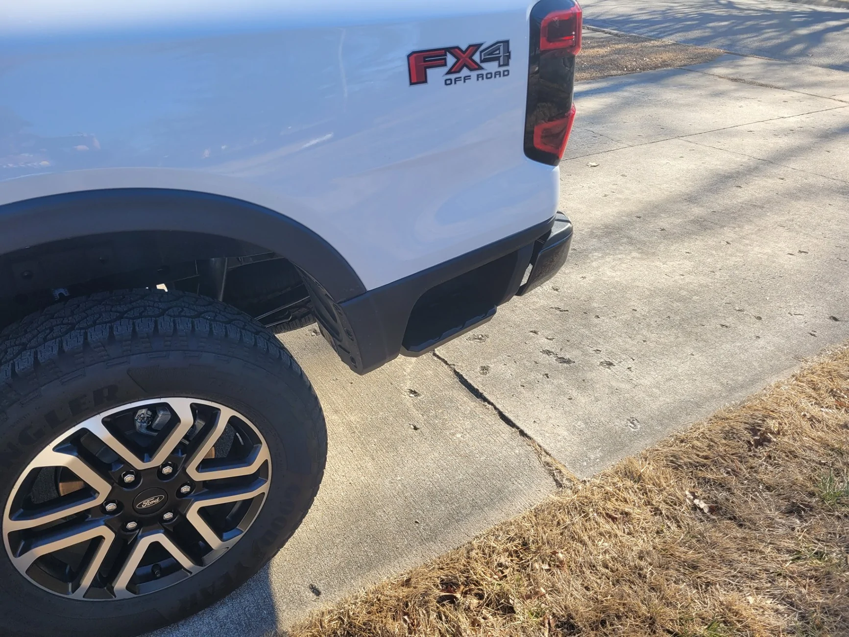

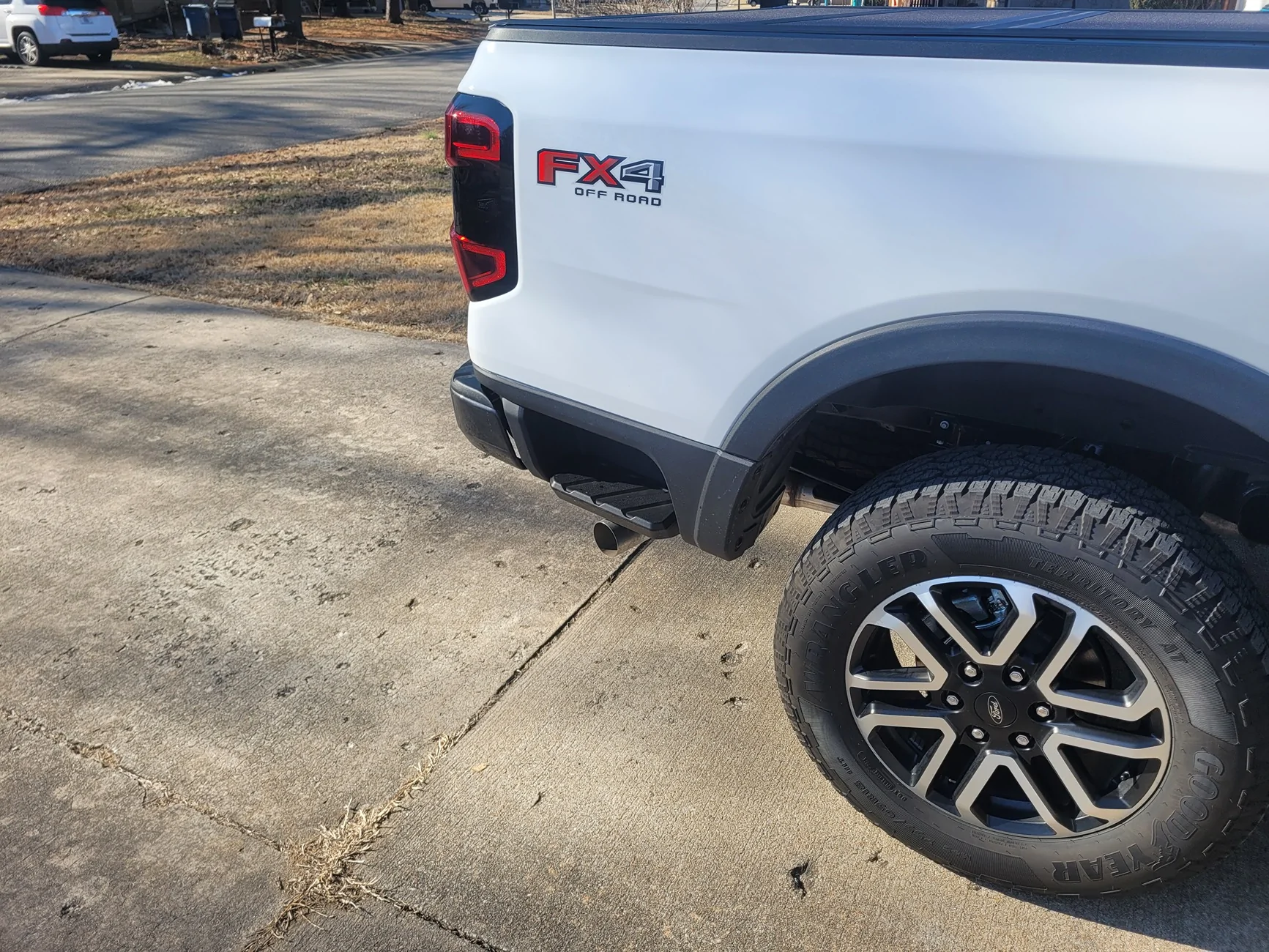

If you dont have the steps behind the rear wheels and you happen to come across a good deal getting them, they are very easy to install so dont pass up in them. They are a nice addition to the looks of the truck and the accessability of the bed. They are worth purchasing.
It takes about an hour per side to take the original smooth sided back panels off and you wont break any of those white clips. Not that you have to save the clips because the new parts should have them.
I did the driver side 3 (three!!!!) times because i was excited to put them on and forgot to put bolts back in place and found them after completly done with that side and still only took 4.5 hours and thats taking pics for this post, also.
