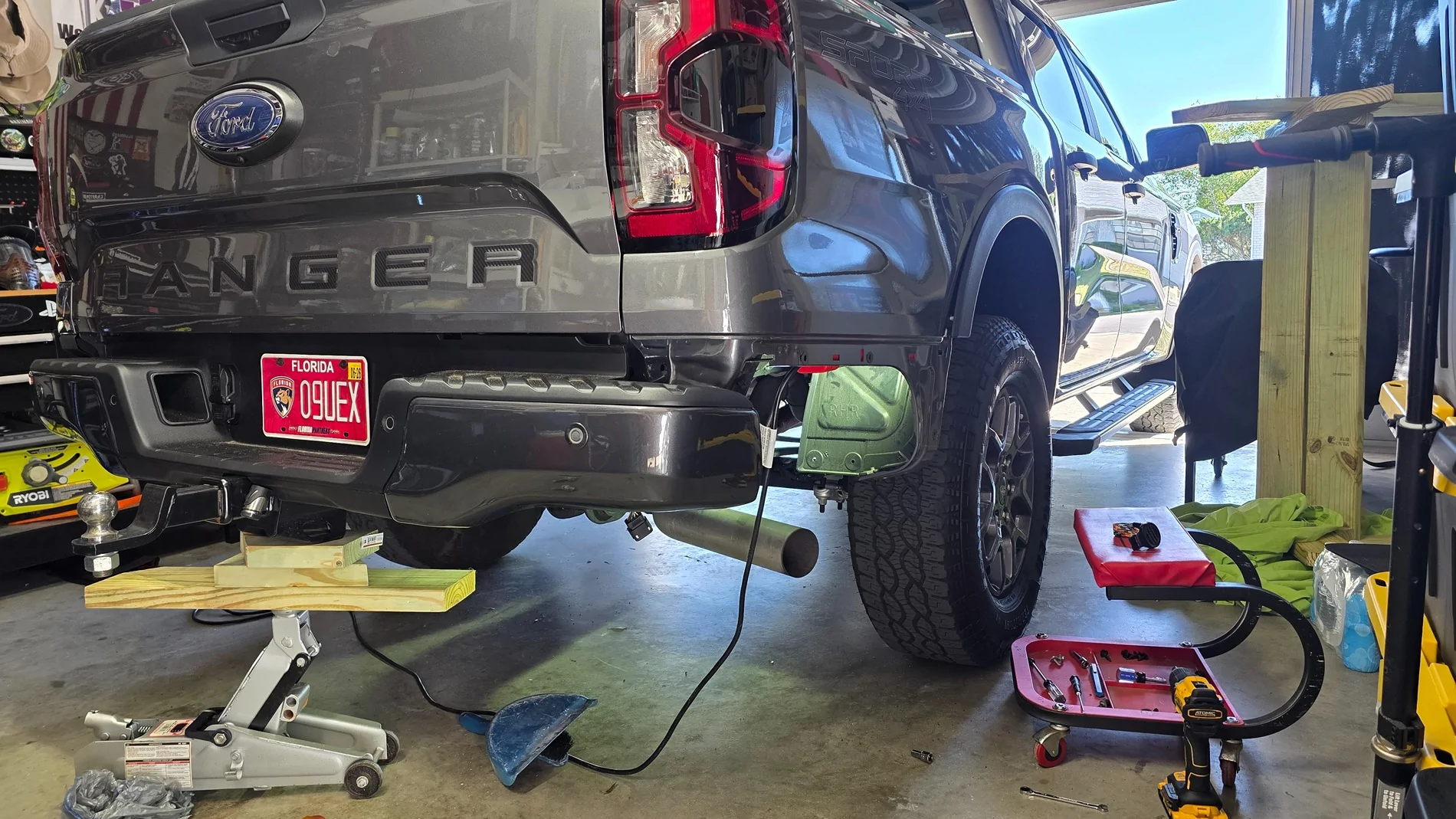

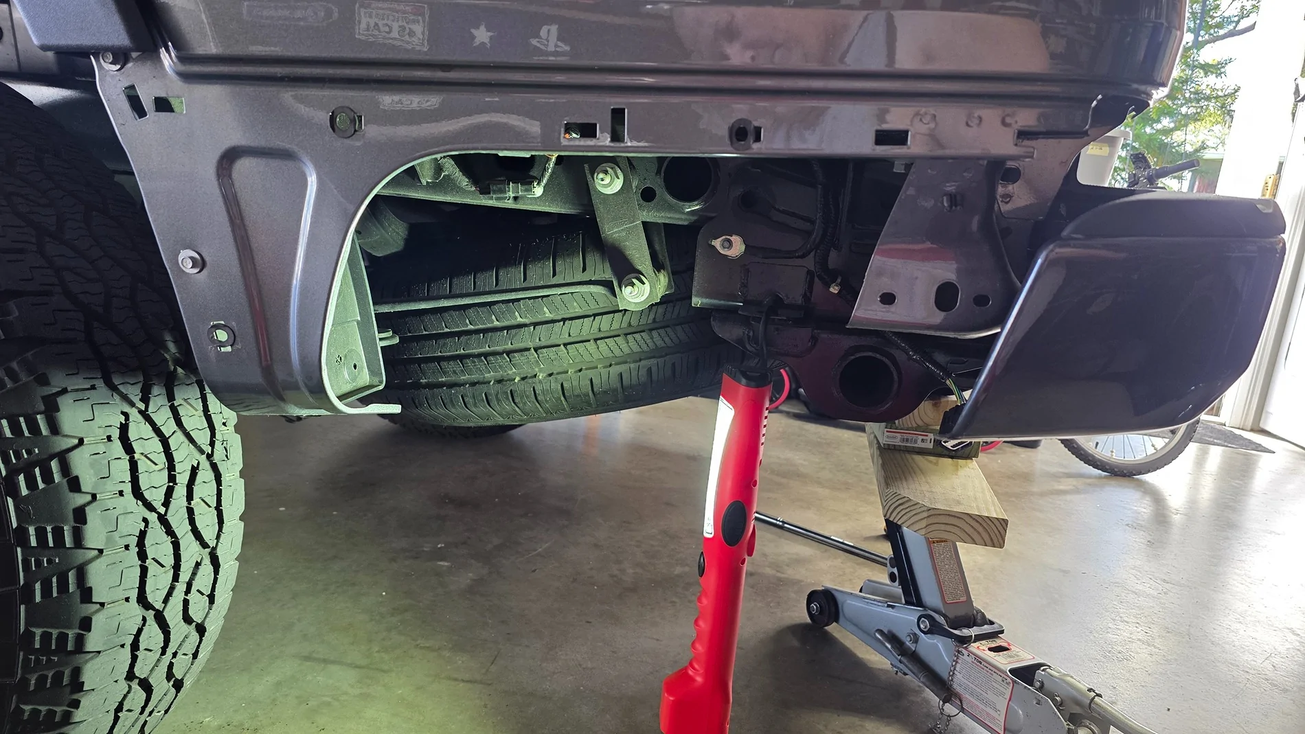

Note on the rear bumper/hitch bolts, Ford uses large M16 fasteners because the hitch is part of the frames load path - effectively part of the truck’s rear structure. When towing, loads from the receiver transfer through the hitch crossmember into the frame rails via those six bolts.
At the factory torque of 146 lb-ft (195 N·m), each bolt generates very high clamp load. Across all six bolts, that adds up to well over 100,000 lbs of total clamp force holding the hitch structure tight to the frame. That clamping force creates friction between the hitch bracket and frame, which is what actually carries most of the towing load rather than the bolts taking the load in shear.
The bolts don’t carry the towing load directly. Instead:
  • The clamping force squeezes the hitch bracket to the frame
  • Friction between the steel surfaces carries the load
  • That’s why proper torque is so important.
When you remove them for steps or hitch work:
  • Breakaway torque feels like 200+ lb-ft
  • Clean the threads
  • Start bolts by hand to avoid cross-threading
  • Snug them first, then torque in stages.
  • Alternate left/right sides so the bumper reinforcement seats evenly.
  • Torque back to 146 lb-ft
  • Recheck torque after a short drive
@josephp732
I was going to go the route of just loosening and using a jack. It sounds like your suggestion and best practice is to remove and clean etc, then re-torque. Is that correct? Marking the bolts to start is a must of course, but I want to make sure this is done right especially since I do tow from time to time.

depends on what it looks like when you are under there. mine was very clean so i just lowered it with the jack and then realigned it and tightened those bolts up like it calls for

@josephp732
Yes, I do recommend removing the bolts and cleaning the threads.

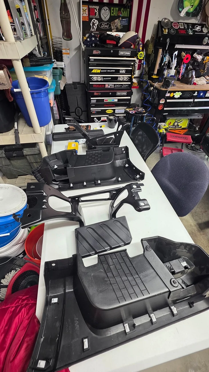

I used a floor jack with a towel under the hitch mount for support. I left one bolt partially installed and removed the other five, which gave me plenty of flexibility to swing the hitch/bumper out of the way. It’s not particularly heavy, so it’s manageable.
This approach made it much easier to remove and reinstall the trim—having all the bolts out on the working side and just one loosely installed on the opposite side really helps with positioning.

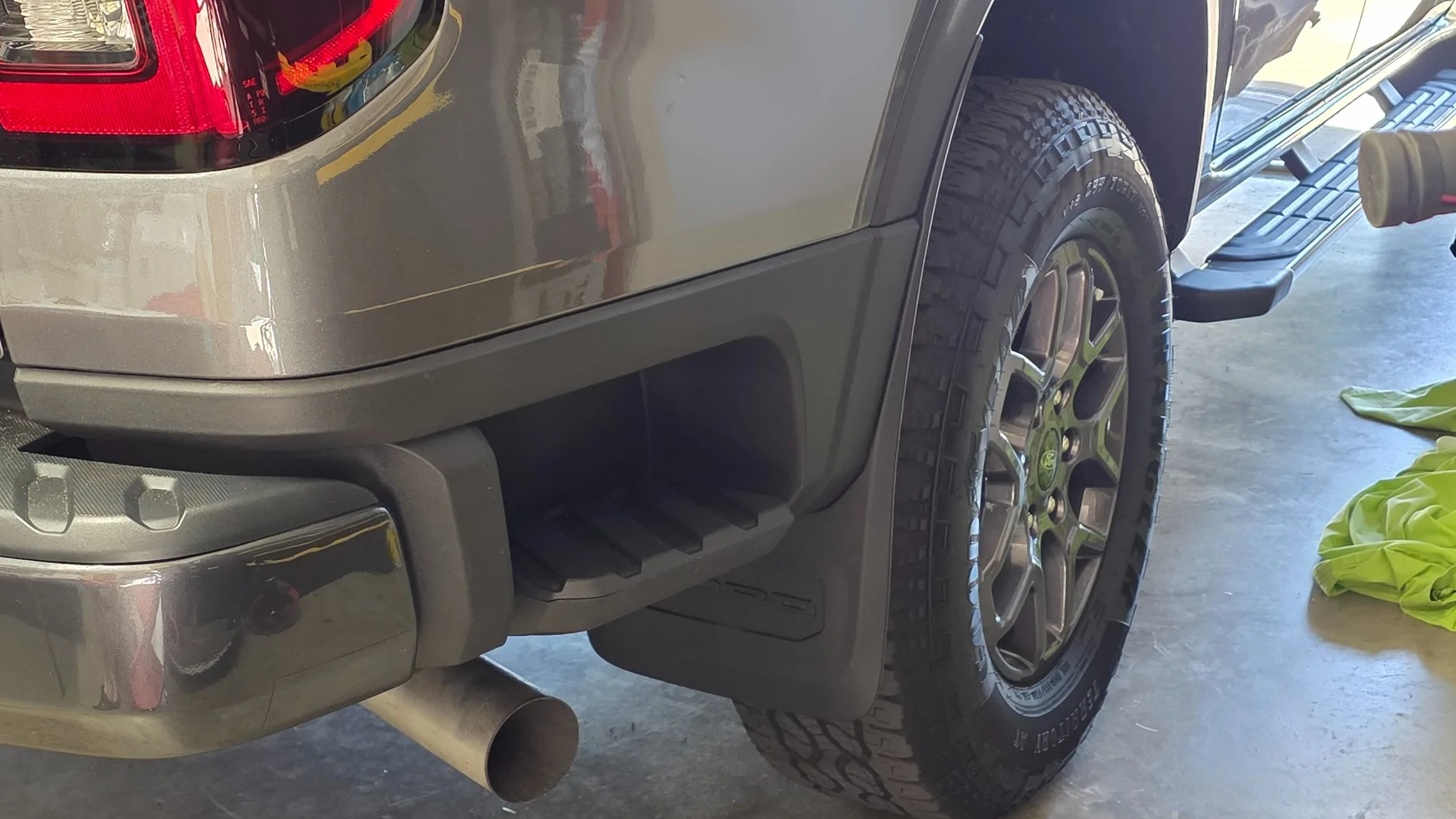

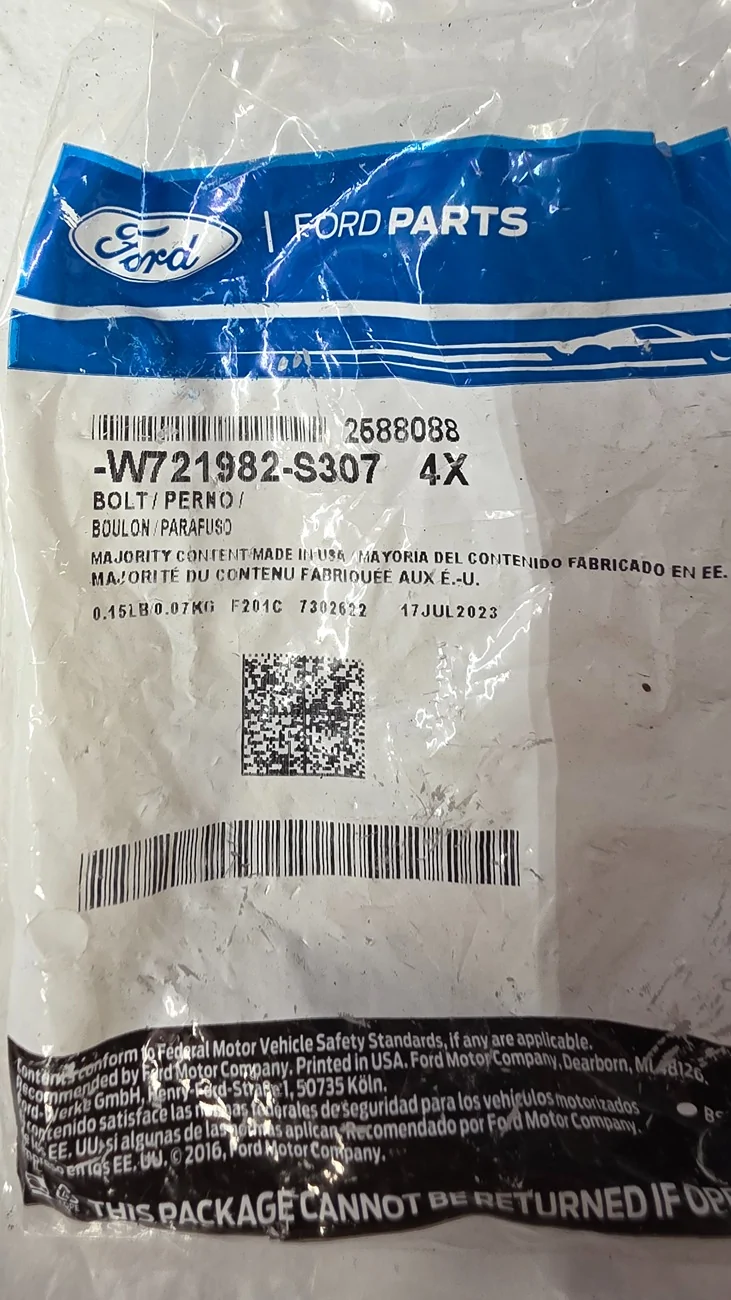

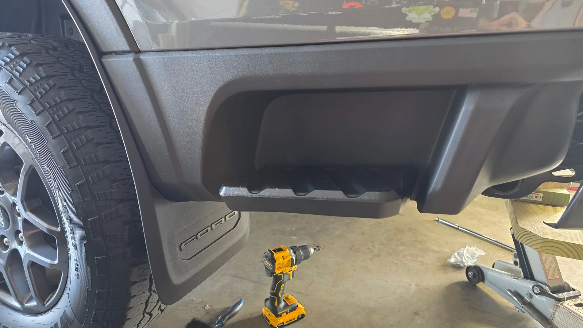

Thanks again to all that have poured sweat and expletives, and for coming up with this write up. Many expletives were expressed. Last picture is the extra 4 bolts needed (come in pack of 4)...
Ford Ranger Installing bed side steps on Ranger XL / XLT - DIY instructions 20260404_090728
Ford Ranger Installing bed side steps on Ranger XL / XLT - DIY instructions 20260404_114019
Ford Ranger Installing bed side steps on Ranger XL / XLT - DIY instructions 20260404_103401
Ford Ranger Installing bed side steps on Ranger XL / XLT - DIY instructions 20260404_094715
Ford Ranger Installing bed side steps on Ranger XL / XLT - DIY instructions 20260404_115102
