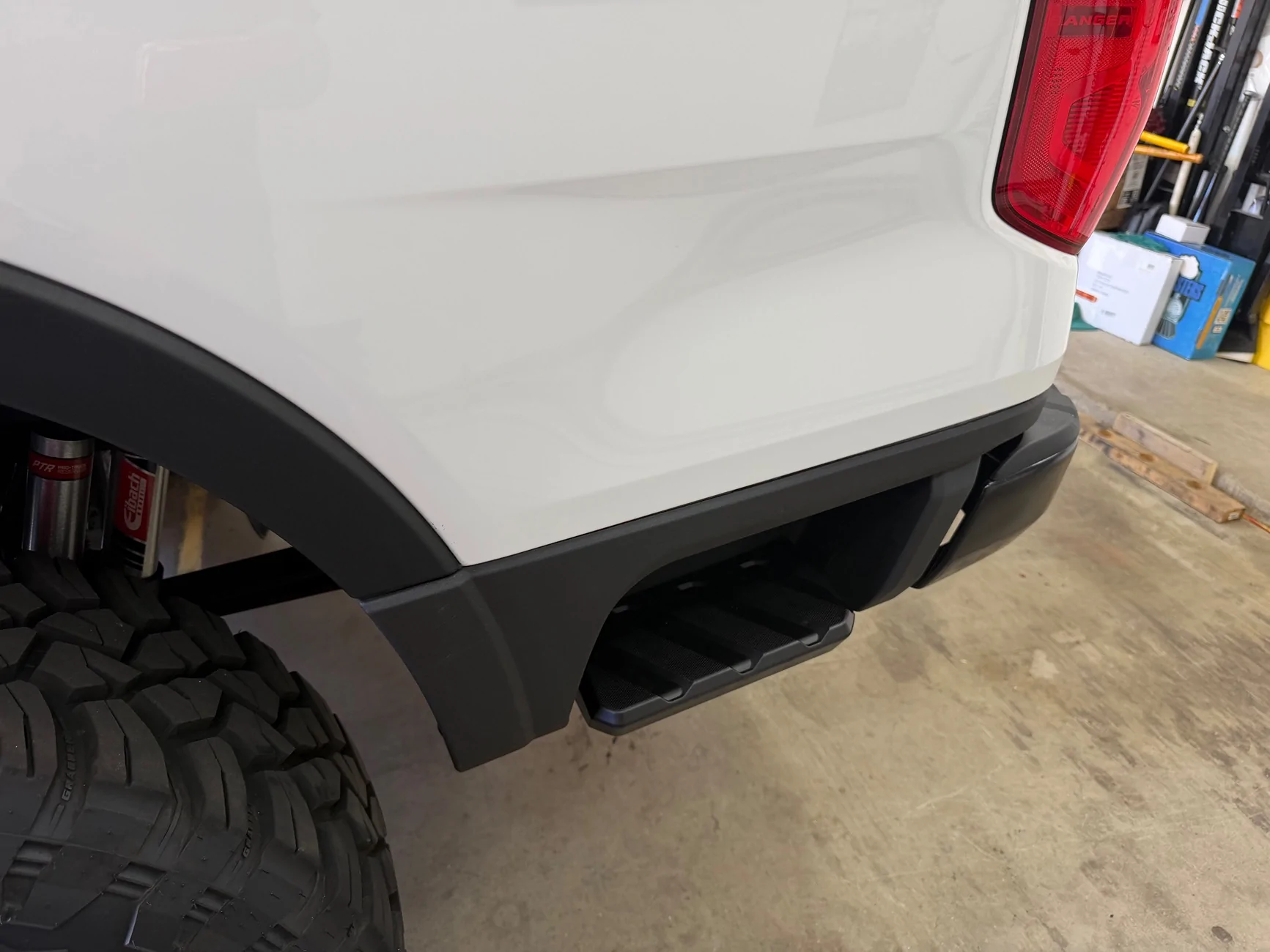

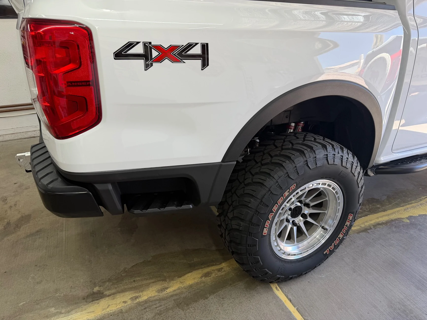

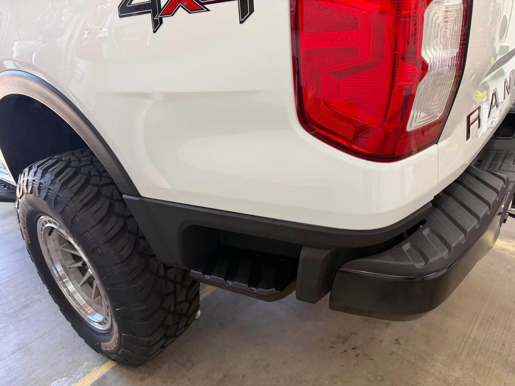

Finally took a day to install the steps. Super J your instructions and photos were absolutely priceless for the install.
This is a project that’s been on the back burner since I bought this truck last June. Unfortunately right after buying it I tore my bicep tendon, which I don’t recommend anybody does. Now looking forward to a summer full of road trips and around town stuff where I can use the steps, cheers all.

And they look great!

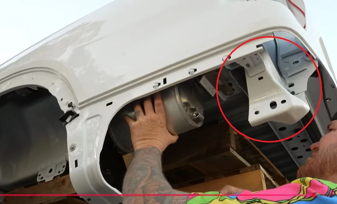

As far as getting this on a Raptor. First you'd have to be willing to cut sheet metal to make an opening for the step itself, Raptors have sheet metal behind our non stepped bumper piece. Non raptor models you'll see the sheet metal is already cutout making room for the stepped piece.
Ford Ranger Installing bed side steps on Ranger XL / XLT - DIY instructions ranger1
Ford Ranger Installing bed side steps on Ranger XL / XLT - DIY instructions ranger2

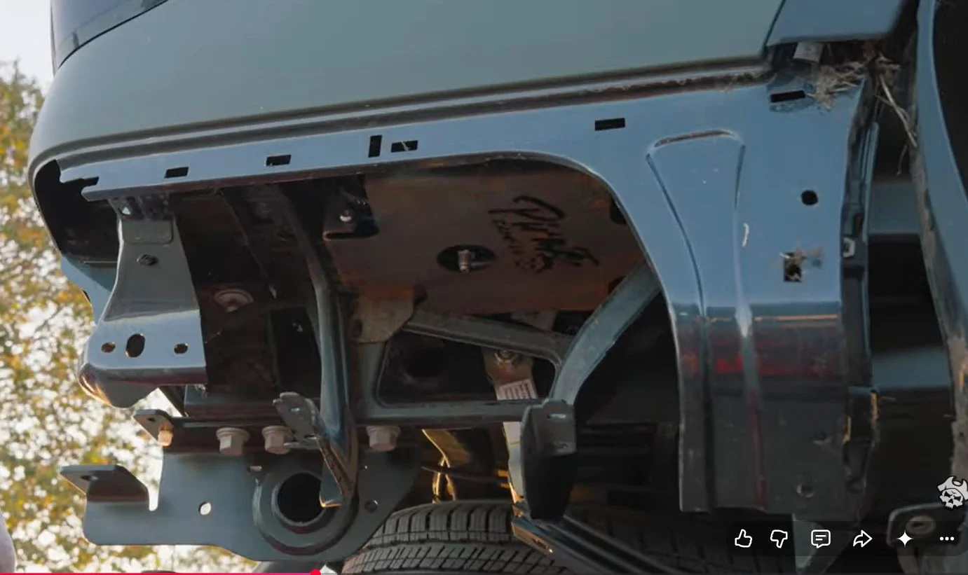

Another concern are these mounting reinforcement spots in the rear the side stepped bumper needs to mount. I'll have to look under the Raptor to see if this is there or not.
Edit: Raptors appear to have it. How exact it matches hard to tell unless things get taken off.
Ford Ranger Installing bed side steps on Ranger XL / XLT - DIY instructions ranger3

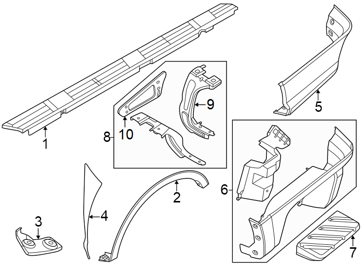

Maybe they're purchasable and included with step #6? msrp ~$177 Can't tell what that extra part is in the diagram seen on the left.

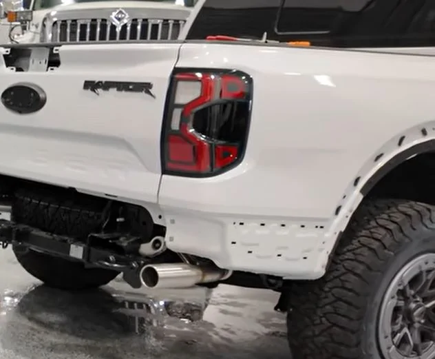

Third the exhaust. Perhaps there are fitment/rubbing issues.
Apparently it can work tho.*
*I don't know if this is a legit Raptor or stickered.

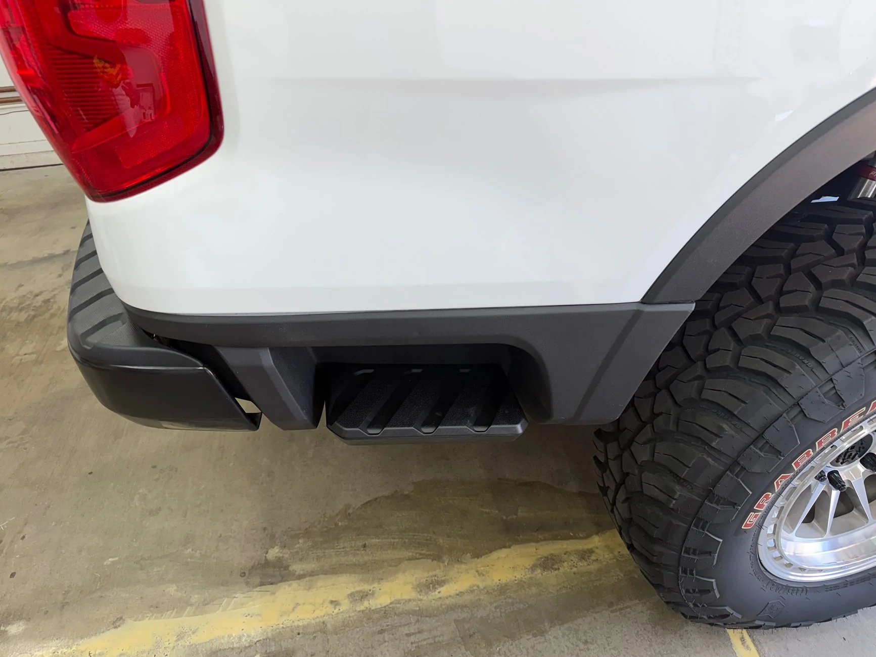

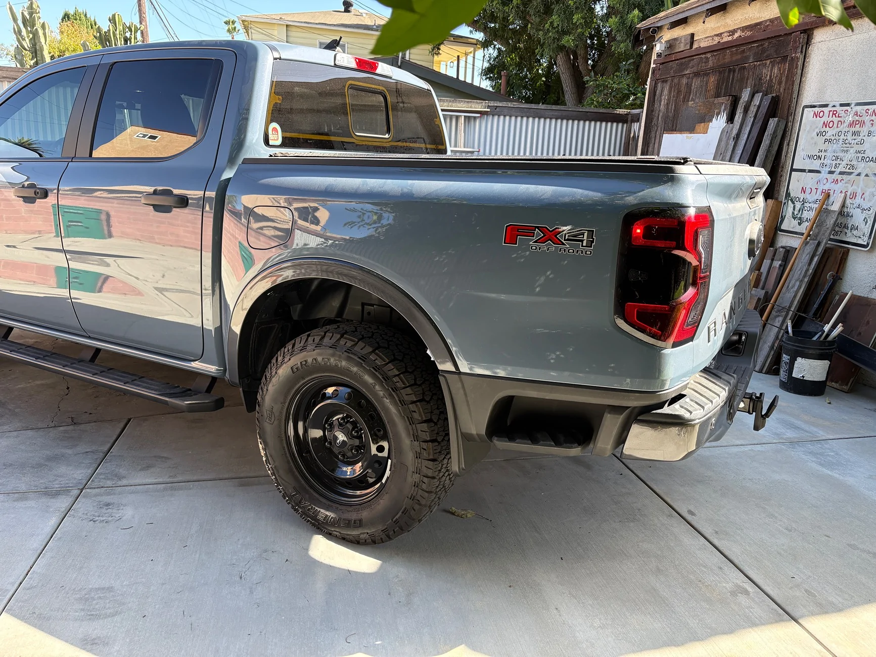

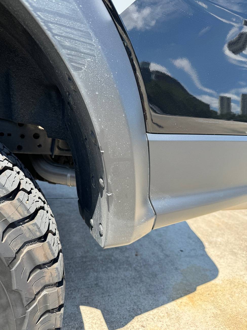

Add mine to the list of swapped.
Thanks for the tips Superj,made the swap a piece of cake.
The only little hick ups for me was a couple of the brackets were tweaked during shipping where the forward locating pin is.Simple fix to adjust,and realign.
Love the look and functionality.
