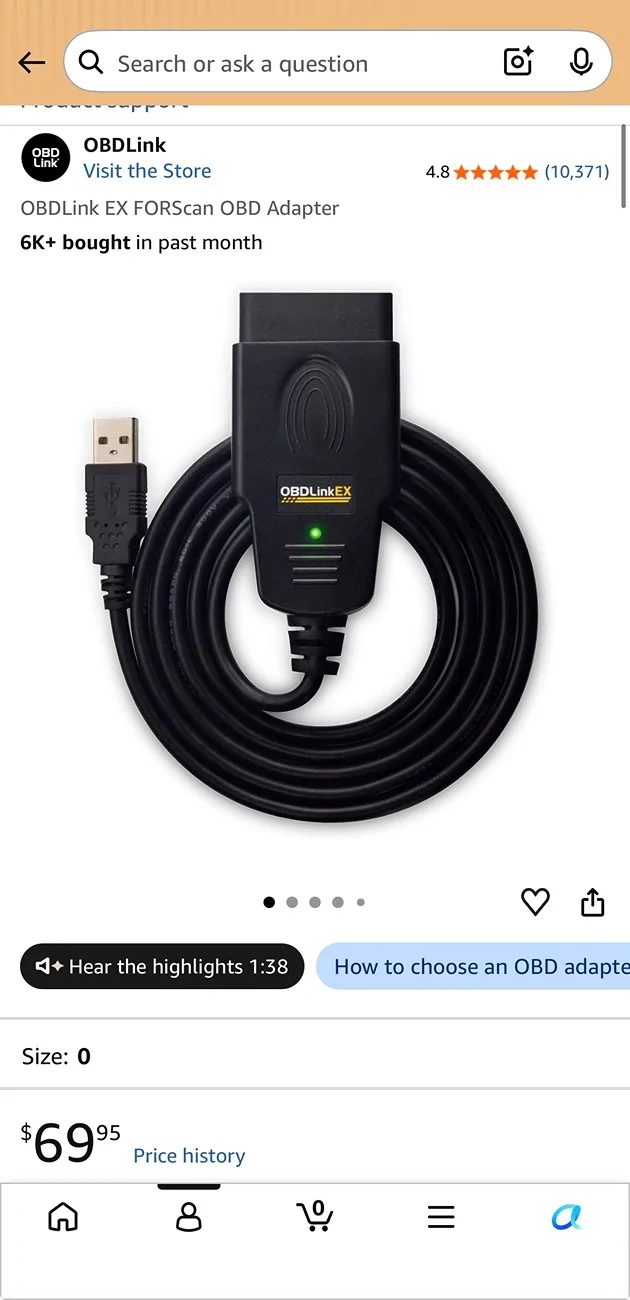

Yep, piece of cake. Assuming you have an ODBLink EX (or similar) and FORScan.

I don't have ether.
Maybe someone in your area is knowledgeable but it’s relatively easy. Just follow that video.
You can get the ODB from Amazon for $70 and you can download FORScan and get a 2 month extended license for free. You will need it for many things like adjusting ride height (VDM) after a lift & bigger tires so the truck knows its new level for ride quality and correct shock performance.
