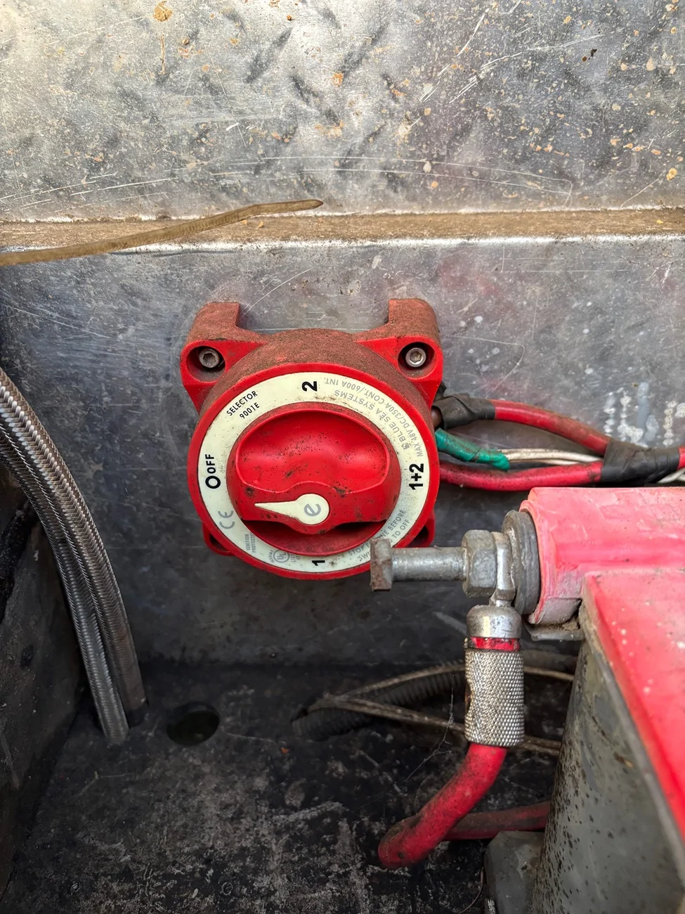

Like a battery kill switch or something?
YES but without that much hassle.

You would have to mount that in a not so obvious location and run battery cables to it. Not an easy task. Plus, a battery kill switch cuts ALL power. Not sure OP wants to lose all remote functions and all presets.
