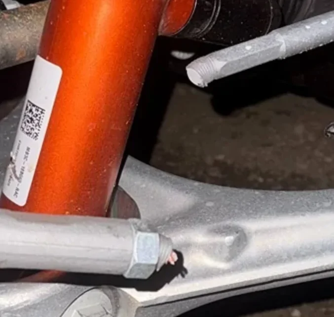

The "dimple" is standard.
The marks on the bottom left, I'm not sure. It looks like casting? Tough to find another picture of another one of that point online and the truck isn't with me.
For a critical component like this, you would think they would use a forged component. Is it aluminum? It's hard to tell as the color looks so similar to the control arm.

Looking at that, it looks like something either pushed in on the tie rod from the front, like perhaps an obstruction, or pulled backwards on it. Nothing else would bend it like that.
Pressure on the wheel could never bend the rod that way. Wheel pressure would damage other things first or damage other things along with that rod bend.
The major stress on that rod from wheel or steering force is overwhelmingly compression or tension (stretch), not bending. Being bent, something had to pull or push at right angles on the rod.

After reading all this, I think it's fairly obvious that the damage to the tie rod was originally caused in transport by someone improperly securing the truck and way overtightening a securing strap or chain. One other option is that in moving it around or onto the truck it ran over something to cause serious damage.
I had a 1982 Bronco hit a short stump hidden in tall grass at about 10mph and the damage to it was very similar to what this looks like. The mechanic I took it to was a highly known and respected race car and truck mechanic and the list of parts he replaced was crazy. I didn't have to pay for it because he had already agreed to buy the truck after hunting season. That truck had survived 264,000 miles of very extreme use both in Colorado mountains and here in North Florida when we hunted deer with dogs. It was brutally tough and never needed anything but maintenance. That stump in one short few seconds did more damage to the whole front suspension than the tortuous 264,000 miles I had subjected it to up until then.
Regardless I'd get on the horn with Ford Corporate and insist that a genuine Ford Technician look at it and recommend repair along with replacing any and all parts that could have been stressed/damaged up to and including the tie rod failure.
These trucks are very highly specialized and your average dealership mechanic will have absolutely NO idea how to diagnose, much less fix, all the problems caused by this catastrophic steering failure.
SERIOUSLY do NOT let the dealership touch this truck without a Ford Corporate technician having a look and giving recommendations or even importing a specialist to look it over and maybe even do the repair themselves. I had one look at a problem I had with my 2019 F-150 Raptor once. The local technicians were very grateful to have his input.
This is a full on race truck and I would have a serious problem with ever trusting it again if it were mine and if I didn't get a truly qualified technician to either perform the work or at least oversee it.
The part of this theory that doesn't add up is this: If the damage was existing at delivery and bad enough to cause a break like that, it would have been noticeable as it would have tracked horribly from day 1. I think, like @embedded rock first suggested, that there was some kind of a steering failure leading to the mishap and when the truck went sideways into the ditch the wheel was forced hard against the side of the ditch and bent/snapped the tie rod.
The worrisome part is that the dealer may find nothing wrong with it besides the broken tie rod and may call it "driver error" or "accident damage".
This is the direction I am leaning towards as well. From what I did see/notice, assembly paint still in place indicating to me that the alignment had not been altered from the factory. Had something been bent at transport, the truck would have been squirrelly with some wild toe parameters.
It's the bend at the failure point that has me scratching my head.
And this is squarely where I've been sitting since Saturday. My gut has been turning waiting for the "well, this is your fault" phone call.
All told, the impact when the truck came to a rest was effectively square in that the truck body was parallel to the ditch plane, but the wheels (or at least the steering wheel.......) were likely in an opposite lock from the spin as I attempted to counter. Again, the impact in the ditch was really nothing - certainly not something that I would have expected to snap a tie rod.
As it sits, I have not received a follow up call of where we're at. Maybe more news tomorrow...

That Tie rod had to to be damaged elsewhere, prior to your turn where everything went sideways. If you haven't bashed anything with it since you purchased, maybe it was chained down improperly during transport or someone hit a barrier at the dealer lot? Or maybe it fell off the ramp while unloading and someone was scared to speak up? 🤷‍♂️
You only need to upgrade the rack and rods if you are going with 37" tires or more IMO, the stock setup should handle up to 35's as long as you aren't an idiot while wheeling and don't abuse the front end (constantly cranking wheel in deep ruts, against rocks or other heavy resistance, or if a tire catches\snags while at high speed or during heavy impact)
Something to consider if you upgrade the tie rods but not the HOSS...is that the rack case then becomes the failure point, which is far more costly and not field swappable. If it happens in the bush you'll looking at a hefty tow bill plus a new rack. Ford designed the raptor to snap a cheap tie rod before the steering rack.
IMO either upgrade both, or simply be aware of the limits of stock setup and carry a spare tie rod while off road.
Good point. There should also be some kind of additional damage even cosmetically, possibly to ball joints or even the Fox shock. Tie rods have very high tensile strength but the weakest part is the threaded area and it broke near the nut. It is also possible that lane centering was on and the vehicle made a correction that caused it. Don't know what effect lane centering has on dirt roads where the road sides are not uniform or the sensor finds it, doesn't find it, then finds it again etc. And as you say the dealer may claim it was driver induced, not a part failure, thus no warranty coverage.. Still trying to wrap my head around a RR built to withstand a lot of stress and strain snapping a tie rod like that.
