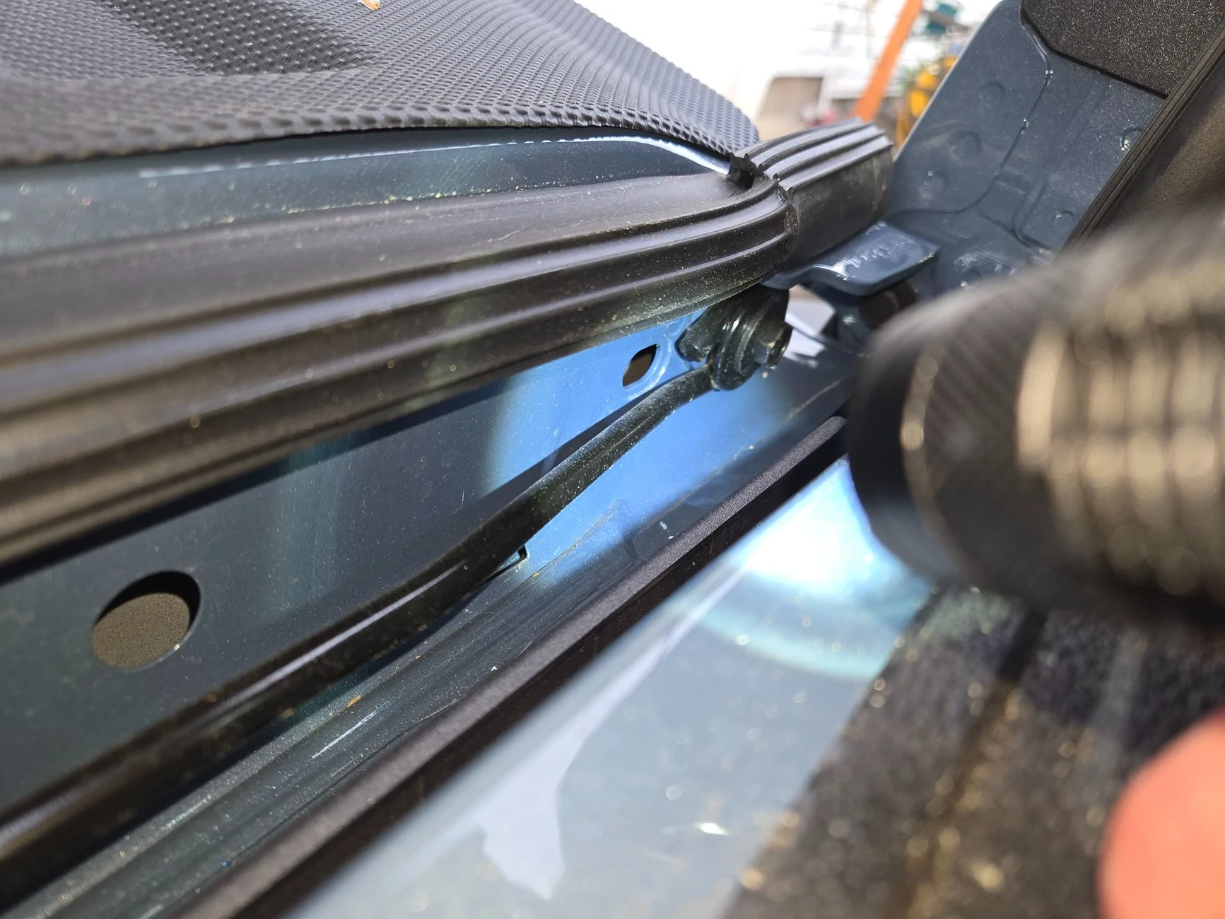

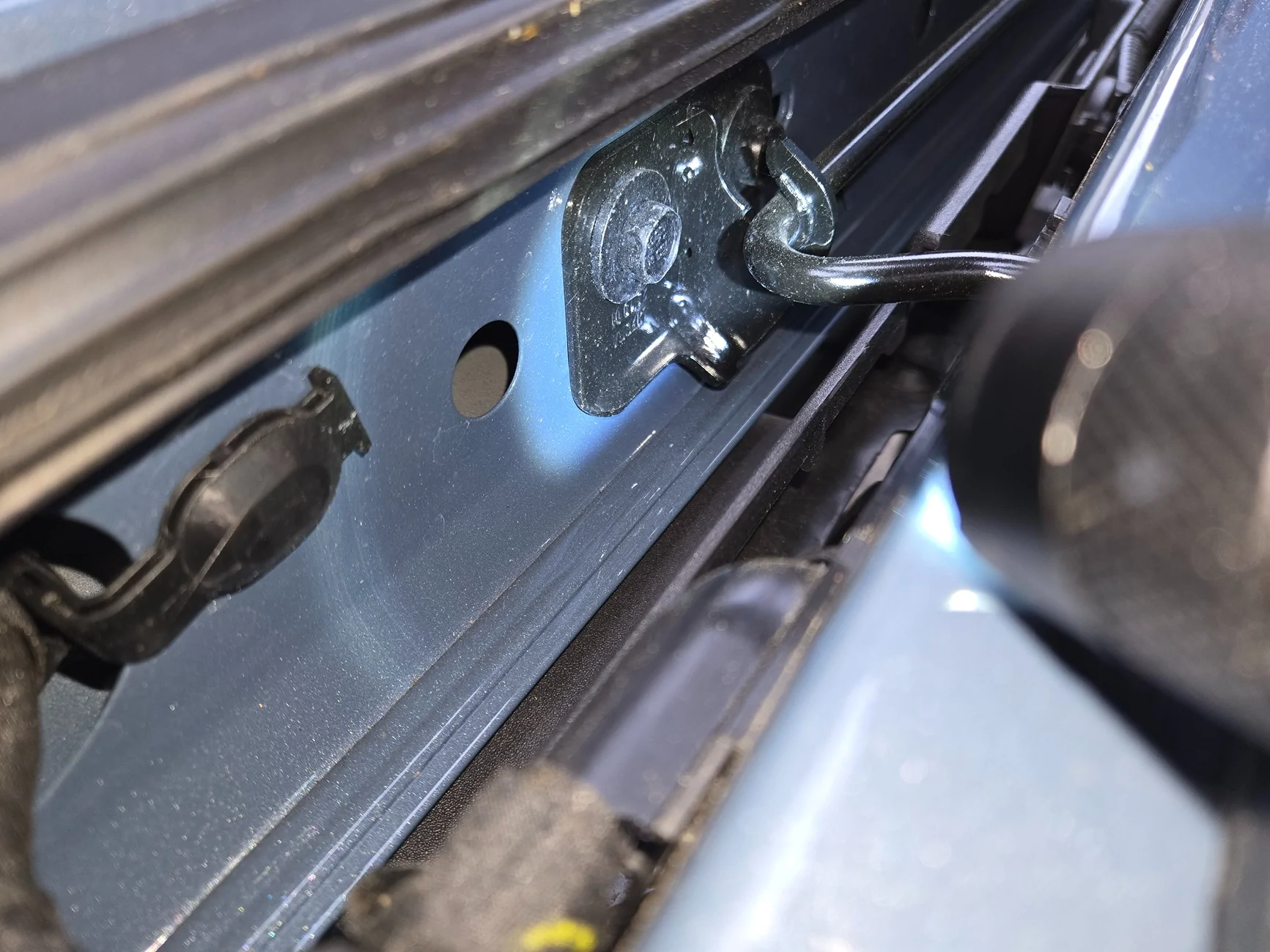

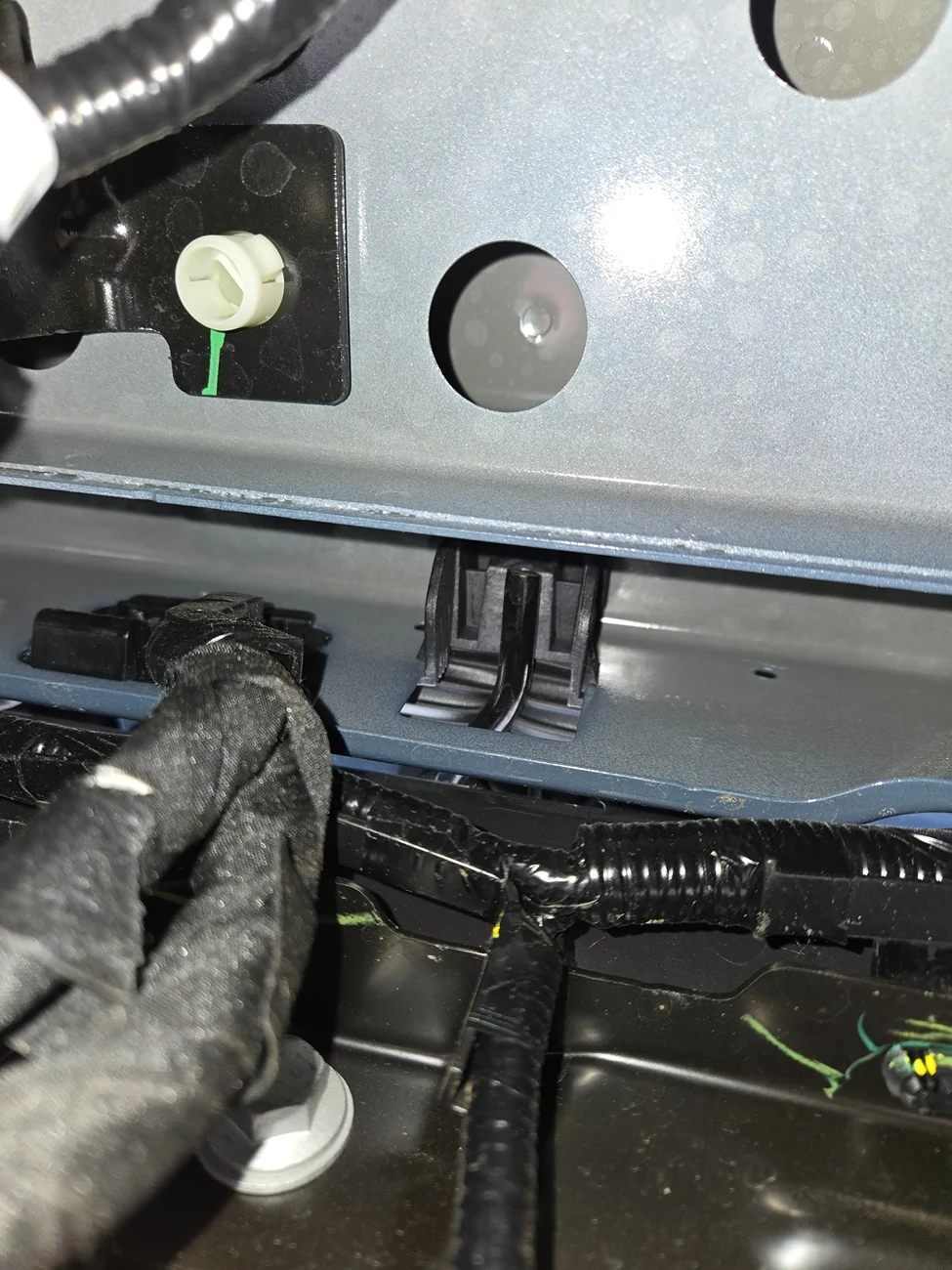

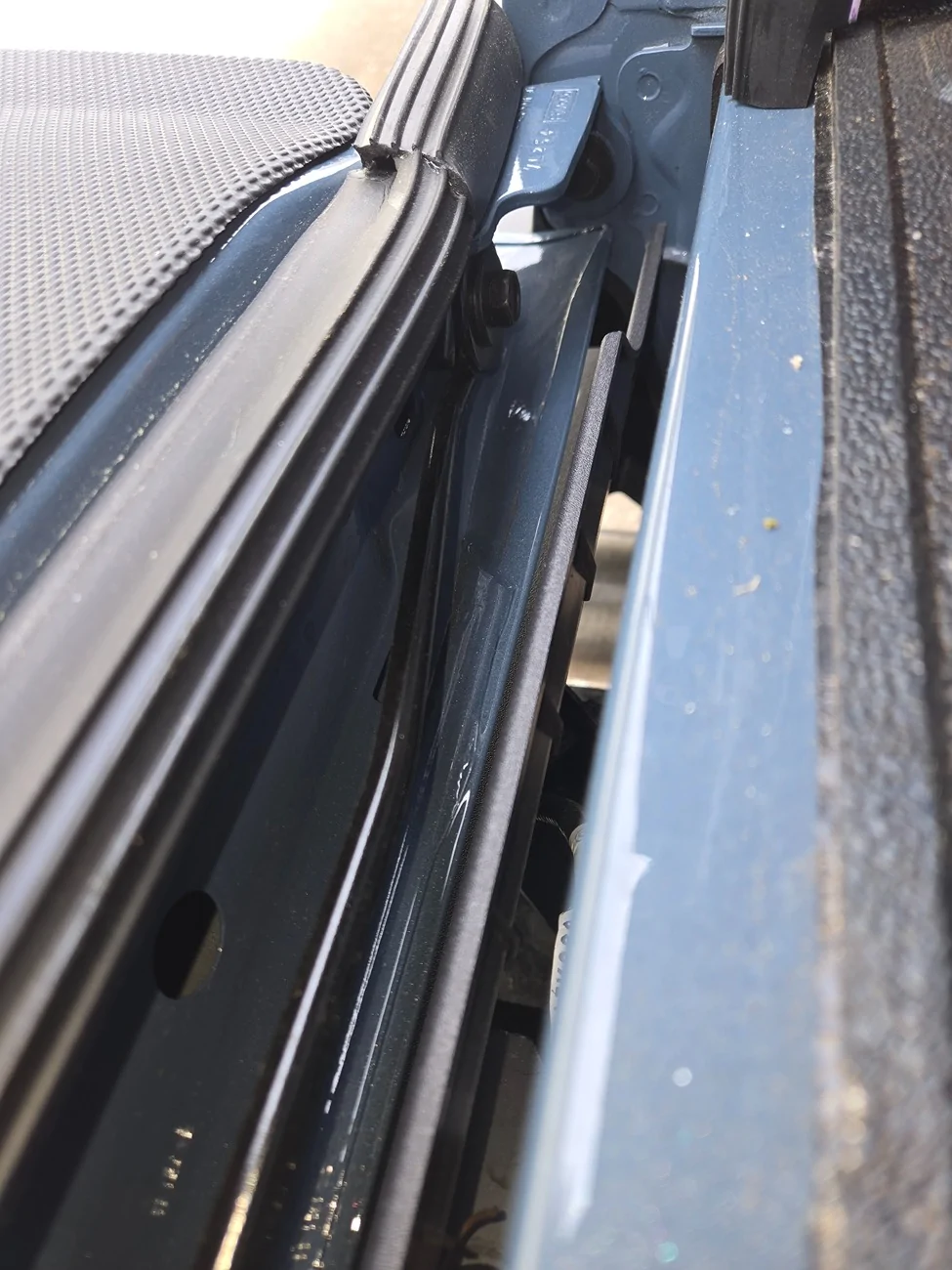

Hello!
Dealer threw in a spray-in bedliner to my purchase of my 26, but of course, the bedliner shop did not reinstall the torsion bar on the tailgate. I saw in another thread the warning about the making sure the plastic clip on the passenger side where the rod goes into is still there, I still have that installed I believe. I know they took the tailgate off because I had to retighten all the hardware they barely put back on.
Would someone mind taking me a pic of where/how (and with what hardware) the rod installs on the driver side and how it goes on the passenger side? Pics of both sides would be great. I don't want these yahoos leaving off a piece or doing it wrong when I go back....I need to go back prepared! :)
TIA!

Not much to see...

Ford Ranger Tailgate torsion bar pictures needed, please help! 20260515_181308
Ford Ranger Tailgate torsion bar pictures needed, please help! 20260515_181253

Better.

Better...
Ford Ranger Tailgate torsion bar pictures needed, please help! 20260515_183042
Ford Ranger Tailgate torsion bar pictures needed, please help! 20260515_182536

Thank you! Took me a min on that last one but I got it.

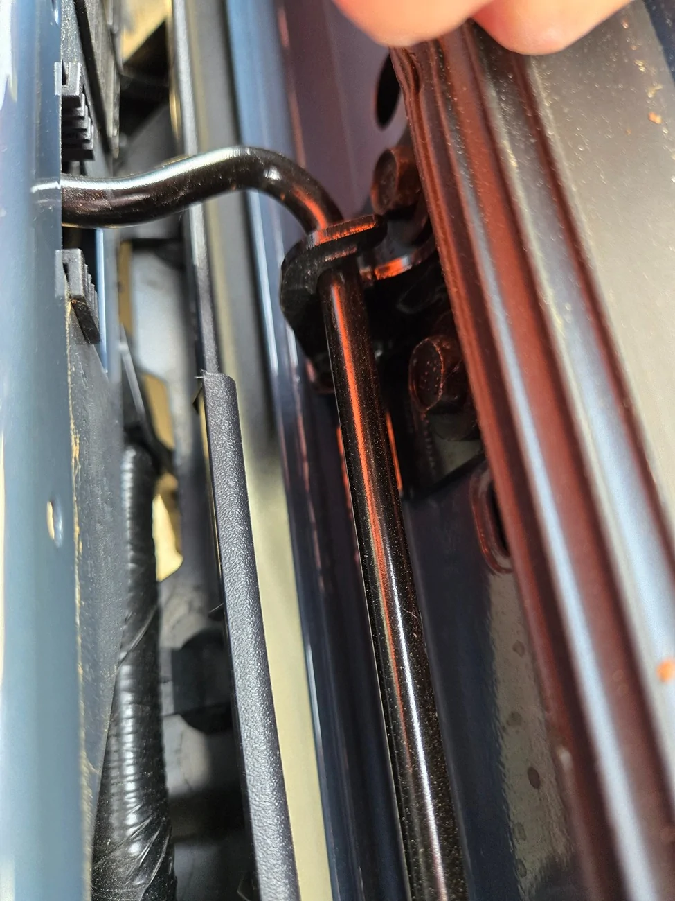

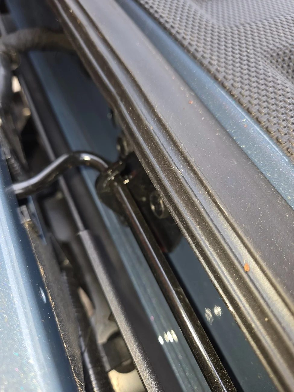

On the driver side bolt down of the rod, is that a large black washer under that bolt head? Talking about the "base " of the rod where it's looped and a bolt goes through....

Doesn't look like it. Wait, under the bolt head yes.
Painted body steel, rod eye, large washer, smaller washer, bolt head.
I suspect the smaller washer is captive to the bolt head.
Ford Ranger Tailgate torsion bar pictures needed, please help! 20260515_195447
Ford Ranger Tailgate torsion bar pictures needed, please help! 20260515_195458

Perfect, thank you! Guaranteed theyll have that rod somewhere and magically not have the washers. Bolt is there of course since it goes through the hinge bracket. Mine is installed washer free.
