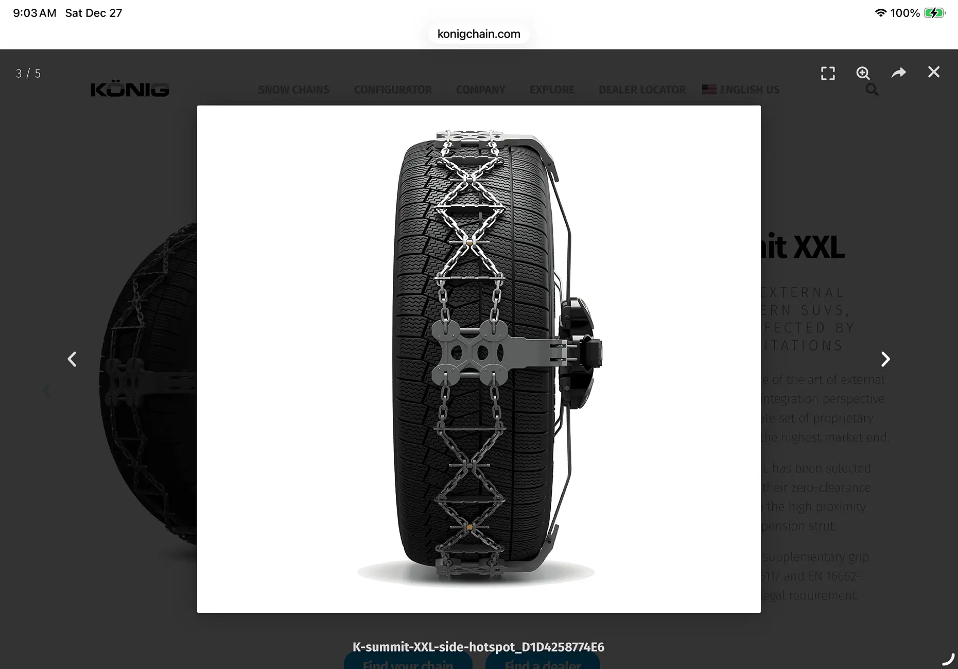

Hi,
I assume that 4WD and diff locks should typically be sufficient for the climbs, but on the descends chains might be clever.
Thus, I got myself a set of König K-Summit XXL (for 285/17-17), even though the price is high. According to the videos I saw online, installation seems pretty easy and they shouldn´t scratch the rims. As I never used them yet, this is still to be proven!
Remark: I carried chains in my previous 4 WD truck/cars during winter trips in the mountains all the time and never needed them, even in heavy snow.
As usual, it is better to have it than to need it... 😉
Cheers

Hi,
Cheers
Interesting. They install on the outer face only? I need to find that video you mentioned. Edit: looks easy enough to install. Why did you go external only versus a wrap style?

Here you can find a video for info.
or here
