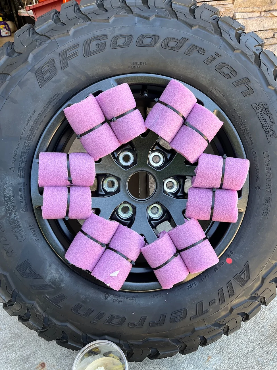

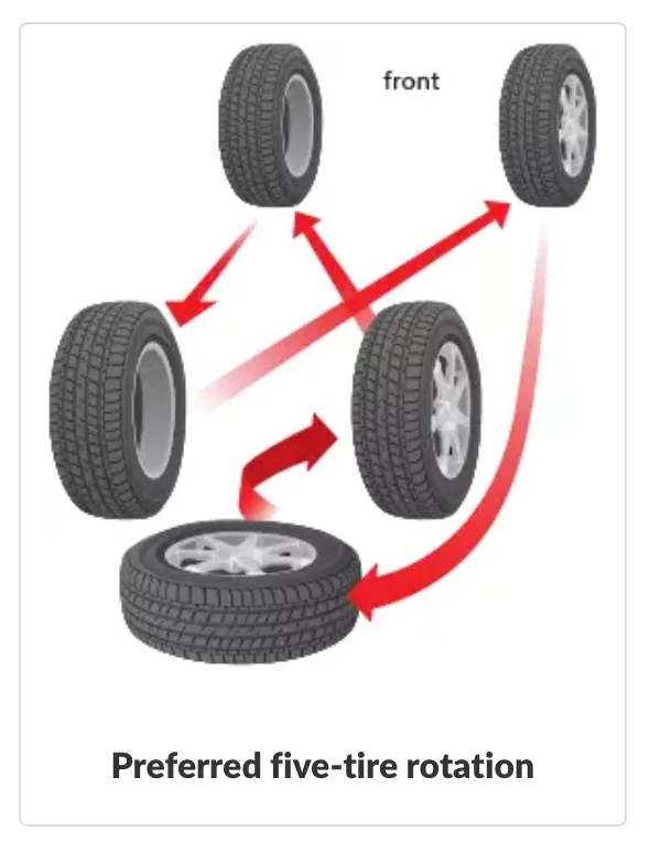

I picked up a matching spare for my RR from Ford, it was only $120, and another $50 from Discount Tire for the TPMS. So spent about 1/2 the cost of what it would cost to replace the full sized K03.
From Discount Tire's website.... Although on my Subaru Forester I just do a counter clockwise rotation and everything is looking good after about 45k miles with the Geolanders 015's.
Ford Ranger Spare Tire decision Image 8-12-26 at 16.52
I did get a little crazy with protecting the spare so it won't get scratched up while under the bed, even though there is some rubber strips in the spare mounting locations. Just hope I don't have to deal with it along the side of the road. :LOL:
Ford Ranger Spare Tire decision IMG_0348
Someday you'll need the spare and won't have something to cut those wire ties...
Then you'll discover they held road grime and it chafed the crap out of the finish. And now it has corrosion because it couldn't dry out....
