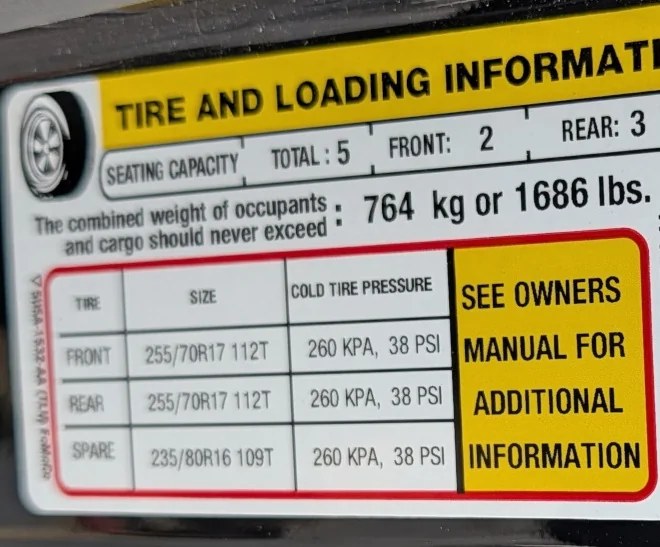

I have a 2018 Ford Fiesta and every winter the Tire Pressure Monitor goes off and the tires are fine. I realize pressure goes down a bit in the winter due to the cold weather Today the Tire Pressure Monitor went off on my 24 Ranger. I brought the monitor up and all 4 tires show 32lbs, but said my right front and right rear are low. These pressure monitors are junk.

The warning for low pressure is going to be a delta from the pressure they were calibrated at. If they’re giving you a low pressure warning at the same pressure, the tires were at different pressures when they were calibrated.
What’s the recommended cold pressure for your truck?

I went in for an oil change at the dealer and to have the Tire Monitor reset. All 4 tires were brought up to 35lbs when I picked the truck up., and the Tire Monitor light was not on. I'll check the door sticker tomorrow.

I just checked the two stickers on the door frame and they bother said 38 lbs, so the dealer inflated my tires to 3 lbs under. I'll bump them up to 38 lbs
