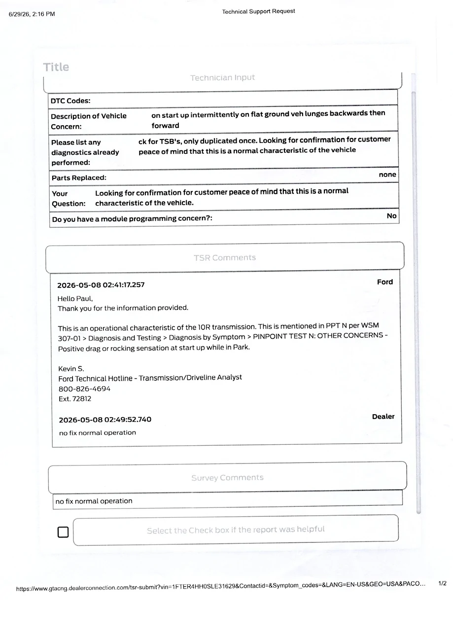

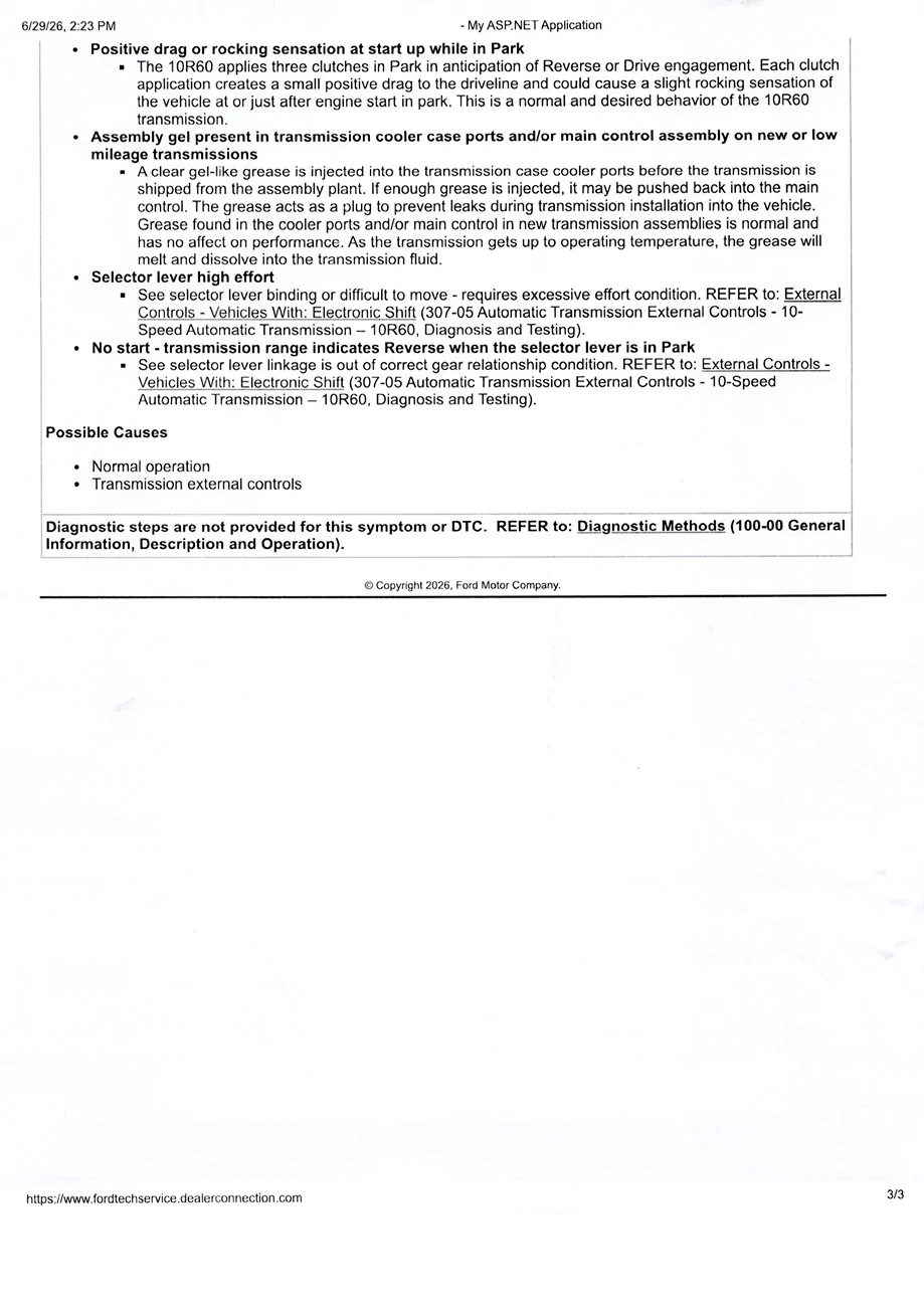

I took my truck in for the recalls and warranty needs, I brought up to the dealership the transmission concern. Per Ford technical department, what we are all experiencing is "normal" for these transmissions. See the attached doc from Ford.
Ford Ranger Transmission “banging” noise and jerk Ford trans 1
Ford Ranger Transmission “banging” noise and jerk Ford trans 2
Ford Ranger Transmission “banging” noise and jerk Ford trans 3
