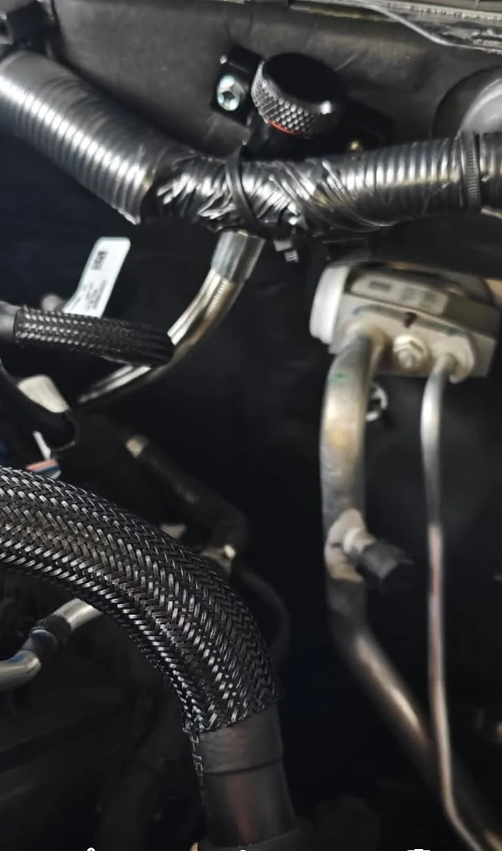

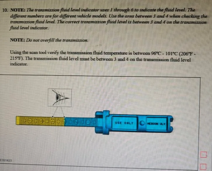

Wanted to post for those interested. Install is kind of self explanatory, just be advised, make triple sure your transmission is at the proper level, you will need to mark the stick after installation for a full mark. Stay away from hot exhaust and no sharp bends keep a nice gentle angle. For pre-measurement the end to end length of outer housing is approximately 36 inches. Not including trans end fitting and mount end.
One I used.
https://www.amazon.com/dp/B0DJ93B3BV?ref=ppx_yo2ov_dt_b_fed_asin_title
Many different vendors, so your choice on where and what to buy, it will say for F150 but the numbering is 22200 price varies. Used one my older F150.
Ford Ranger Under-hood Transmission Dip Stick TransCheck
Ford Ranger Under-hood Transmission Dip Stick transDip1
Ford Ranger Under-hood Transmission Dip Stick transDip2

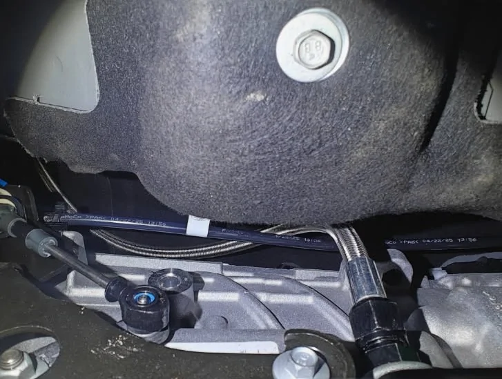

Look on drivers side toward rear portion of transmission just behind the bracket and shift cable. 19mm wrench, small dip stick is under the cap see pictures. Mines 2025 fx4, its there!
**Be advised you can lose fluid if you remove it and vehicle is not running like its suppose to be checked.**
I got mime up to temp to check on level ground. Then let it cool back off. Jacked up drivers side of truck until I could get 4X4 blocks under the wheels so I did not lose fluid to install the under hood one. Hope this helps!
Ford Ranger Under-hood Transmission Dip Stick picdipstick
