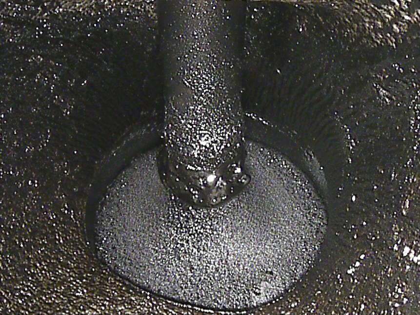

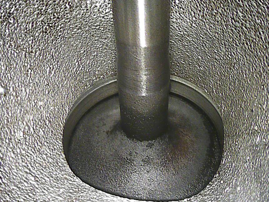

Carbon build up on GDI intake valves;
Ford Ranger US Raptor Best Oil Catch Can? IMG_0107
Ford Ranger US Raptor Best Oil Catch Can? IMG_0106
There is no other maintenance to be performed for carbon buildup, except inductions service cleaning or manual walnut blasting. The latter is expensive and requires a partial engine tear down if done correctly.
CC’s on both CCV and PCV sides, virtually eliminate the (condensation, fuel and oil vapor from the crankcase) which cause the carbon buildup in the anffected areas of a multiport system like the Ecoboost.
Here’s something else to consider; Ford Accessories offers their own version of the CCV and PCV catch cans for several Ecoboost engines including the; 2.7 TC V6, 3.0 TC V6, and 5.0 Coyote V-8. I believe they also know a little something about Ecoboost carbon buildup as well, considering their selling accessory catch cans for these specific engines.?
This is the ECOBOOST Induction service from BG; https://www.bgprod.com/reference/ford-3-0l-ecoboost-gdi-engines/
https://fordauthority.com/2021/07/watch-a-tech-tackle-ford-ecoboost-carbon-deposits-video/
There are many reference to Ecoboost Carbon Buildup. A simply internet search will provide them.???
