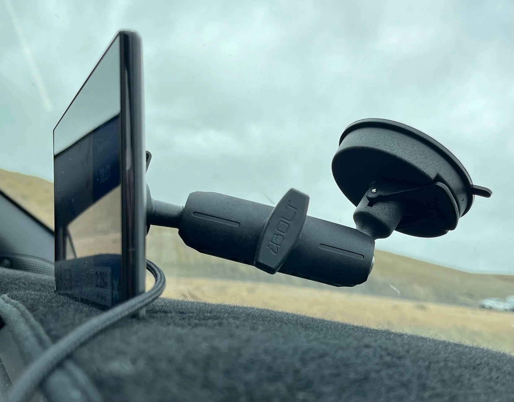

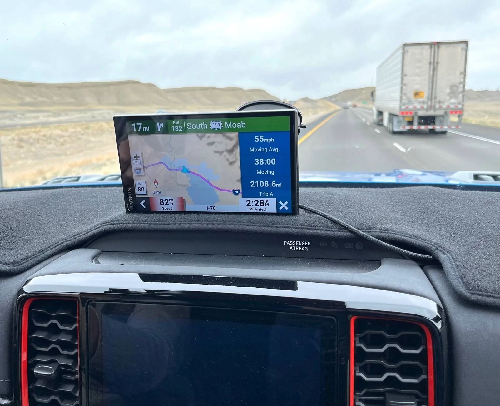

The TireTrakker will monitor tire temperature, sort of, a low tire or bad bearing or dragging brake will heat up the air enough to be visible on the display, which should fit OK in the lower left corner of the windshield
I don’t tow with this truck, the gps is positioned front and center over the dash with an aftermarket heavy duty 1” ball suction cup mount, a 6” extension plus a matching 1” ball to Garmin ball adapter for the gps mount itself. The unit rests solidly on the dash mat and does not move at all. With the driver’s seat up high I can see right over it. A shorter driver or a low seat will give some blockage.
I just took these pics, we are an hour north of Moab, yippee! I am not driving!
EDIT:, the driver does not see any of the mount parts, at all, just the display.

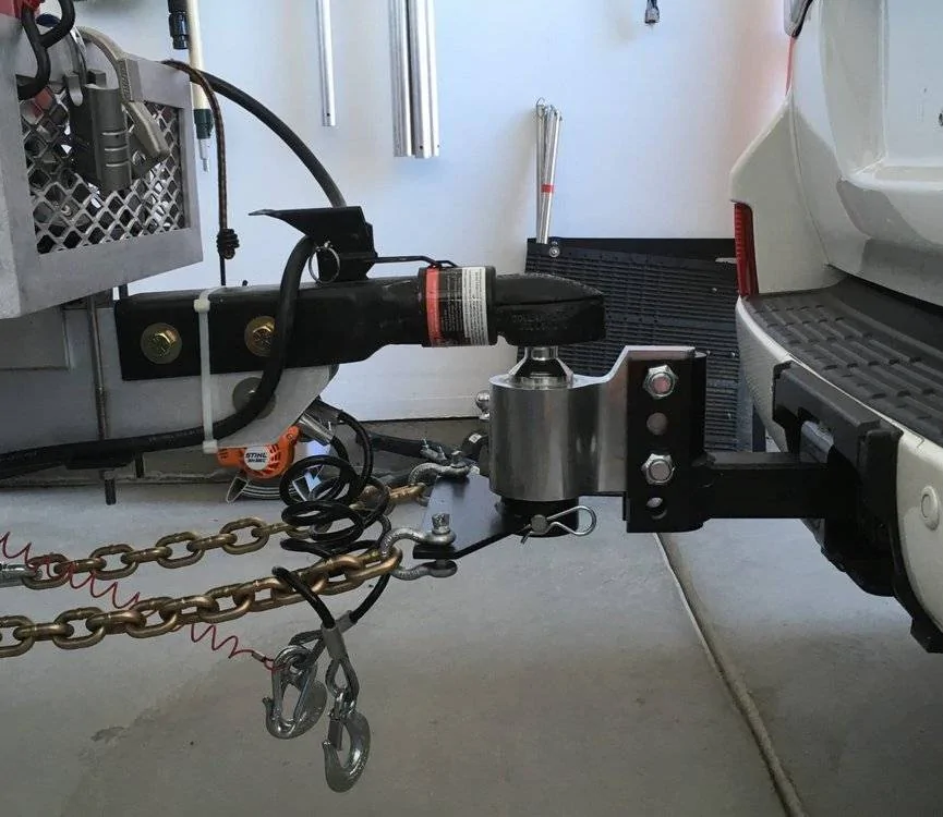

At first i was looking at the Anderson, but i think I'm going to end up going with the Equalizer 600. It is probably slightly overkill (compared to a 2-point like the fastway e2) but i'd rather be safe than sorry for the distances we will be driving.

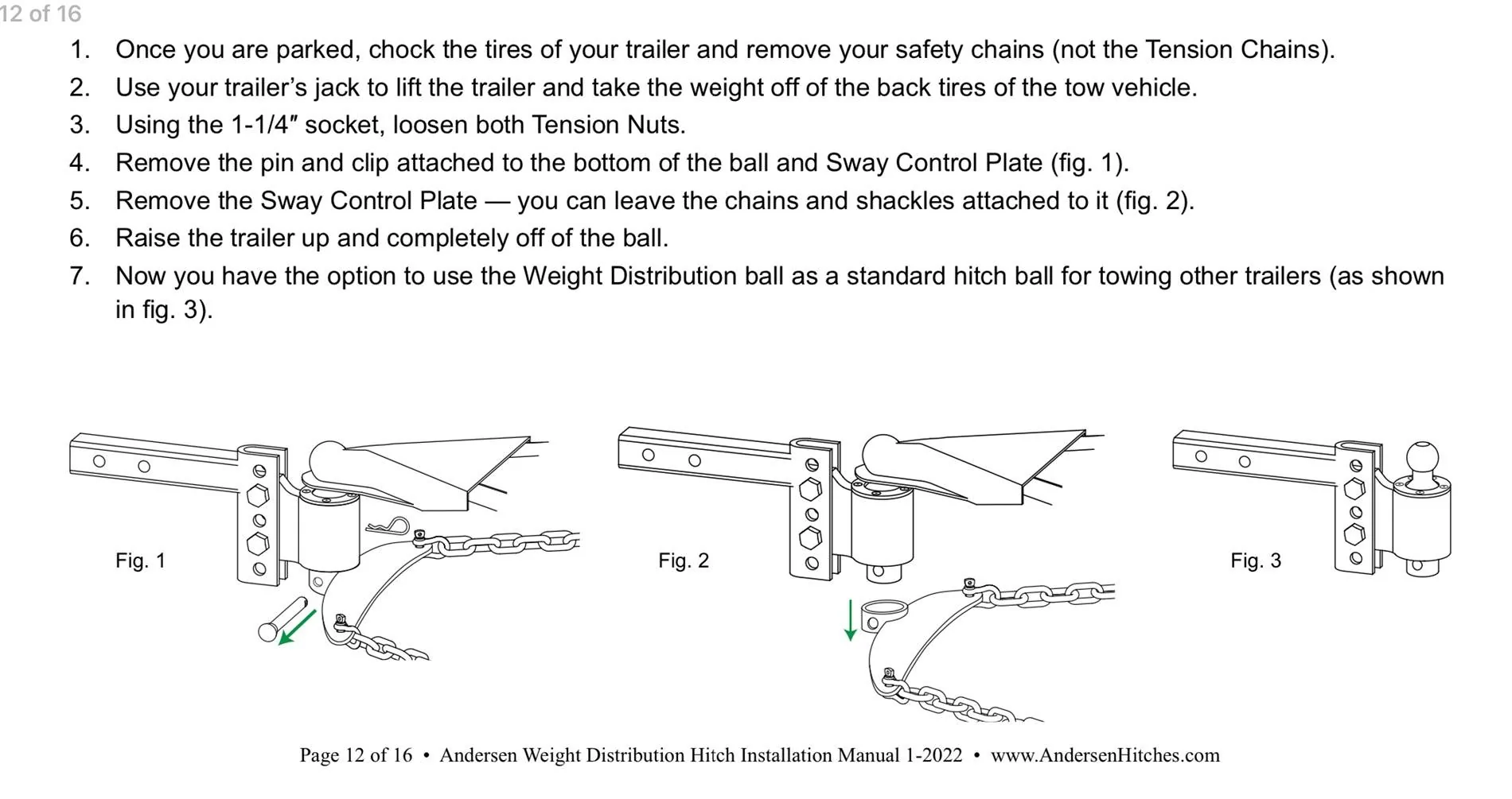

Your Ranger has a very limited cargo capacity compared to a full sized truck, the Equalizer 600 is over 100 pounds, the Andersen is the same price and a better product IMHO and only weighs 52 pounds. and it looks elegant! Heavier does not equate to safer! That weight saving will be really useful for long trips. I used an Andersen extensively with a 6000 pound Oliver over a seven year period and it was superb.
It will work great with your 3500 pound T@b and will be MUCH easier to hook up and store. For example, the support plate (AKA whale tail) can be easily disconnected by opening and then raising the coupler using the jack, to provide some slack, removing the connecting pin, and then moving it under the tongue. You do NOT need to loosen the two big adjuster nuts! Support it and the two chains off the ground with a short bungee cord looped over the tongue (and when towing, the same cord will hold your safety chains up and off the pavement…) Drive the truck forward two feet, then adjust the tongue to your desired level position. See the instructions, they are informative.
https://download2297.mediafire.com/...WD+Hitch+installation+manual+2022-Low+Res.pdf
I don’t know where the other hitch is made, probably China, but the Andersen is designed, manufactured and very well supported in Idaho Falls, ID.
Check for Andersen sales online vs your dealer, most RV STEALERS … err dealers, charge way too much for accessories, over MSRP sometimes…. You would need to make sure that they would still install and adjust it it at no charge (if they are not making an extra $200 off the hitch sale.) Camping World sells them for $749 plus free shipping, but you can get 10% off by signing up for their emails….
Thanks for this. I have heard a lot of good things about the Anderson, I just wasn't sure how good it was at WDH. I know it seems to handle sway very well. If you used it with that Oliver trailer, I assume it should work pretty well for us. I will probably end up going with it instead. I did have concerns about how heavy that EQ-600 was on added tongue weight. I know it would still be within our bounds, but it is a bulky thing and would cut into added cargo space quite a bit, especially given I want to eventually mount some bikes on the hitch while we tow.
And yes, already noticed the dealership prices. The EQ-600 that they recommend and install by default (unless you bring something else) is "marked down 10%" but they still charge $980 for it..on amazon it's about $750. They did say that anything I bring they install complimentary other than " Hensley brand" because it takes multiple hours to install compared to any other normal hitch.
