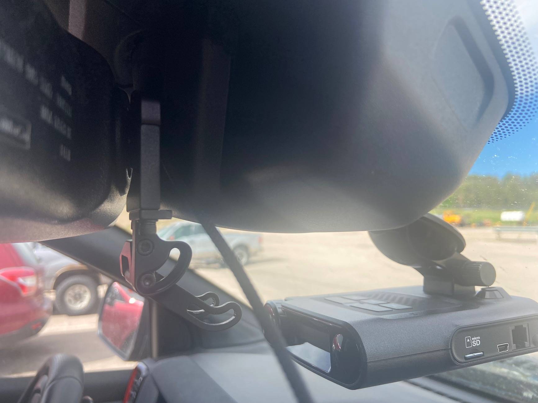

I customized my blendmount because my maxcam wasn’t getting gps most of the time. I had previously tried swapping in my redline detector with no change, and using suction cup mount for maxcam (worked).
Here’s a pic of the original mount setup, with the detector forward on suction cup.
Ford Ranger What did you do to your Ranger Raptor Today? IMG_0786
I didn’t like how far the mount stuck down below mirror. I had removed the short body link the mount came with during install, but didn’t think it would push the mount forward far enough to be worth trying.

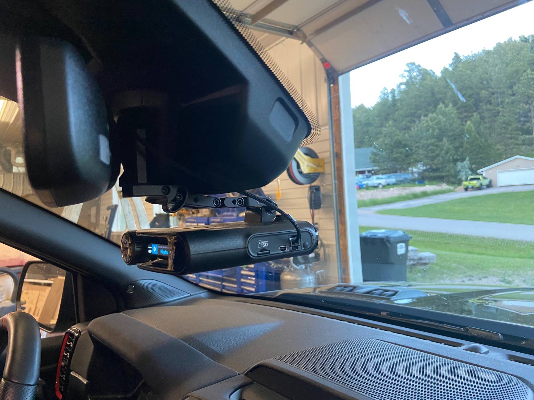

I ordered a different pivot bracket and a couple long body links, to move the detector higher and forward. Here’s the new setup.
Ford Ranger What did you do to your Ranger Raptor Today? IMG_0808
Gps issue is fixed. I hope I don’t have vibration loosening issues with the long mount setup and extra pivot points.
If you don’t mind the detector sitting lower, i would expect the factory mount to work with just a long body link added to move detector forward.

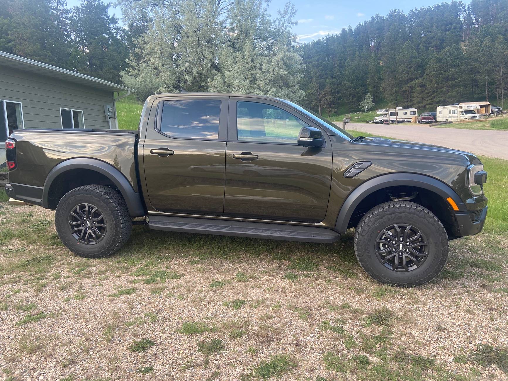

Powder coated wheels/skid plate (dark chrome bronze.
Paint matched Raptor emblem.
Ceramic tint 360.
Paint protect protection film.
Decal removal (Raptor sticker)
Painted silver bumper to black.
Shorty antenna.
Custom 3rd brake light.
Custom hitch cover.
Ford tail gate emblem cover (black flag)

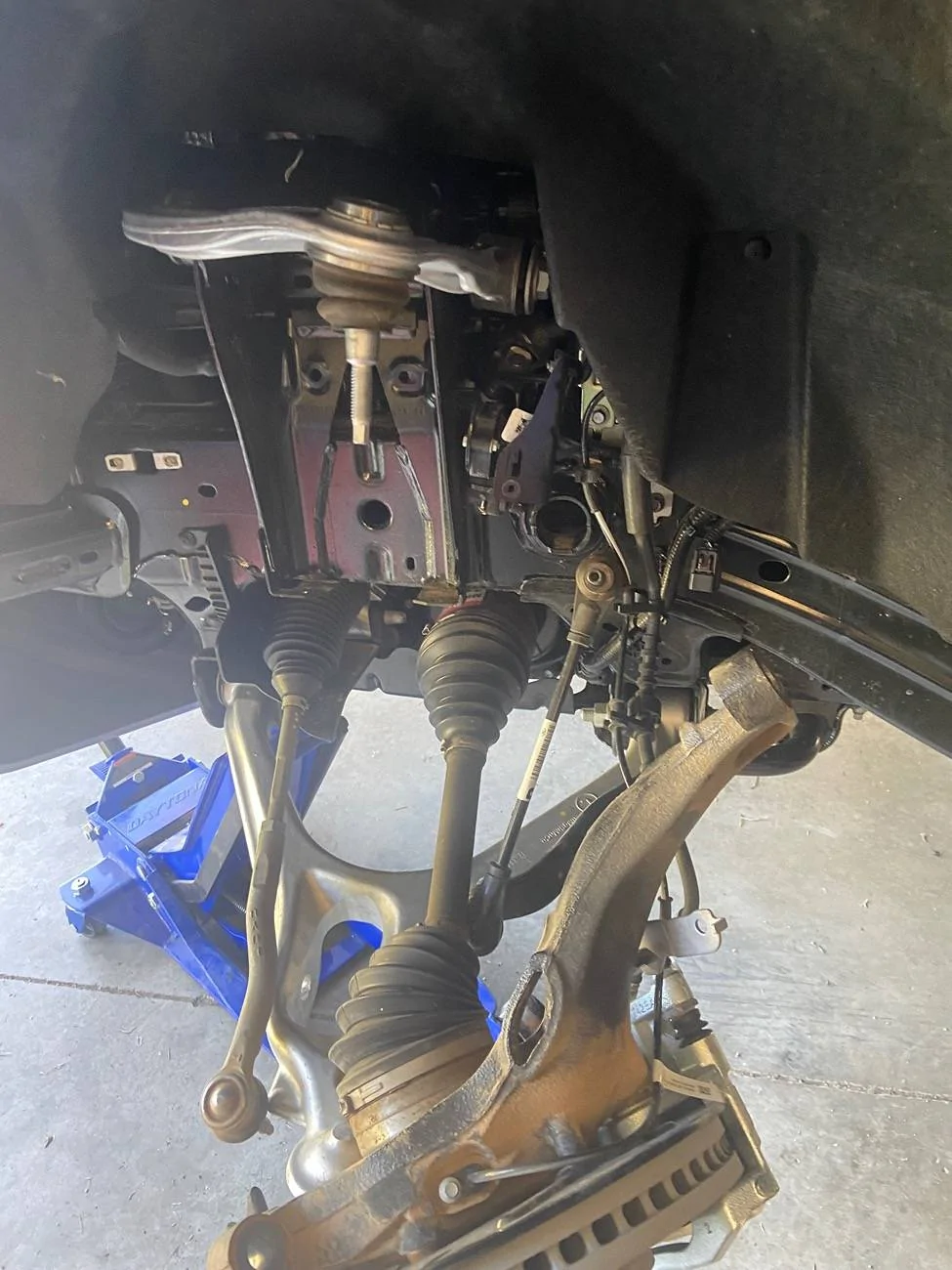

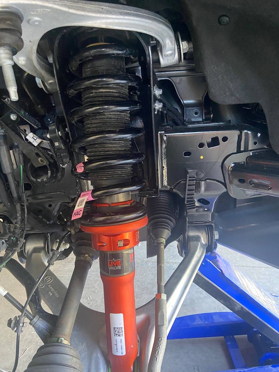

Installed Foutz 2” perch collars.
I was planning to wait to see my final height after installing an arb summit bumper and 35gal gas tank, but neither seem to be in a hurry to release in America.
Since I’m going to rapter assault school on the 18th-19th, we decided to make it a week vacation, heading to moab afterwards.
Going to hit some trails, including Hells Revenge, so decided an extra 2” clearance up front isn’t a bad idea.
Install was generally easy for a coilover removal. Bottom strut bolt is crazy tight, and inboard strut top bolt is a bit cumbersome without pulling fender liner.
Spring compressor was a fight as always.

No, I left the fender liner in. I was able to get enough movement on a 15mm ratcheting wrench to break the inboard nut loose, then wedged my hand in far enough with a stubby 15mm ratcheting wrench to remove it. Minor carpet burns from fender liner. Passenger side is a bit worse due to roll pin location.
The second pic is as far as it was stripped down.
Mine has progressively gotten worse which I don't understand. It was working fine up until last week. Now it doesn't seem to like GPS at all. Could be the dash cam in the way more than anything. Which links did you end up adding? I might have to try and push the detector forward some.
