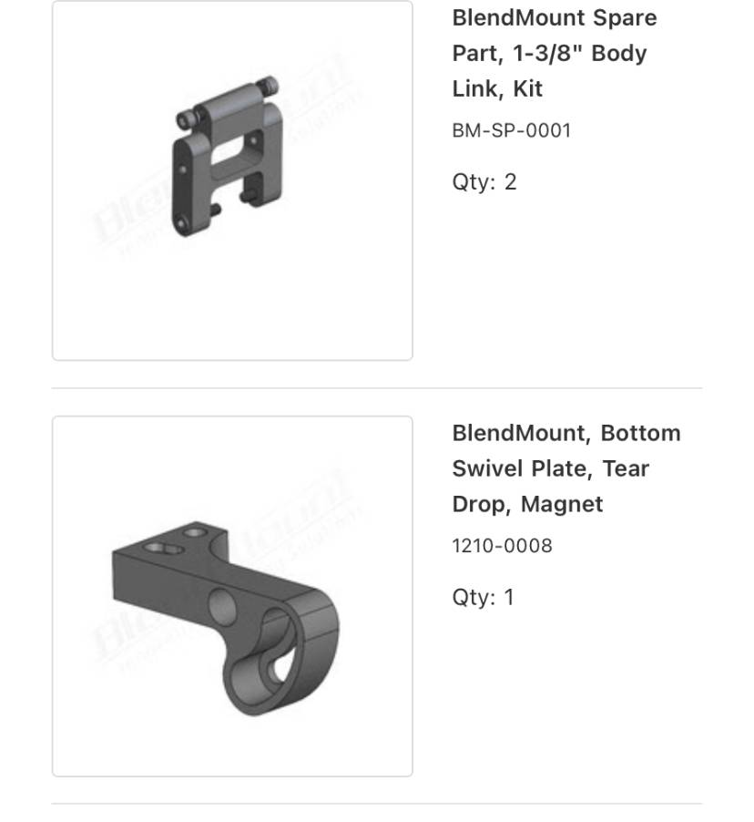

The different pivot won’t work with your hybrid cam setup. I only used one of the long body links I ordered.
Ford Ranger What did you do to your Ranger Raptor Today? IMG_0830
For anyone else interested, the different pivot is very close to the plastic wiring cover, so modify at your own risk. Also, you will need a different length socket head cap screw. Thread is 6-32, I forget length.
Body link is on the website under spare parts. You’ll need to call to order the pivot. Just give em part number from pic.

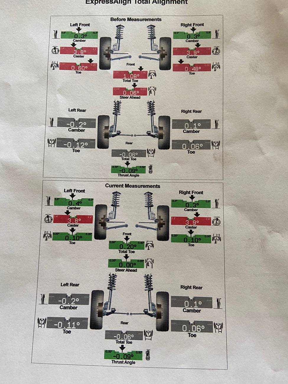

Oh it will be out - toe for sure.
Ding ding ding, we have a winner.
Ford Ranger What did you do to your Ranger Raptor Today? IMG_0831
Confirmed alignment is needed after perch lift. That would be very hard on tires.
The specs are for 23 tremor.
I was able to find specs for braptor. Caster would be safely in spec for braptor. I’m gonna start a thread for rraptor specs.

Anytime you remove the tie rods/ball joints etc you will mess toe up. Won't affect caster or camber usually.

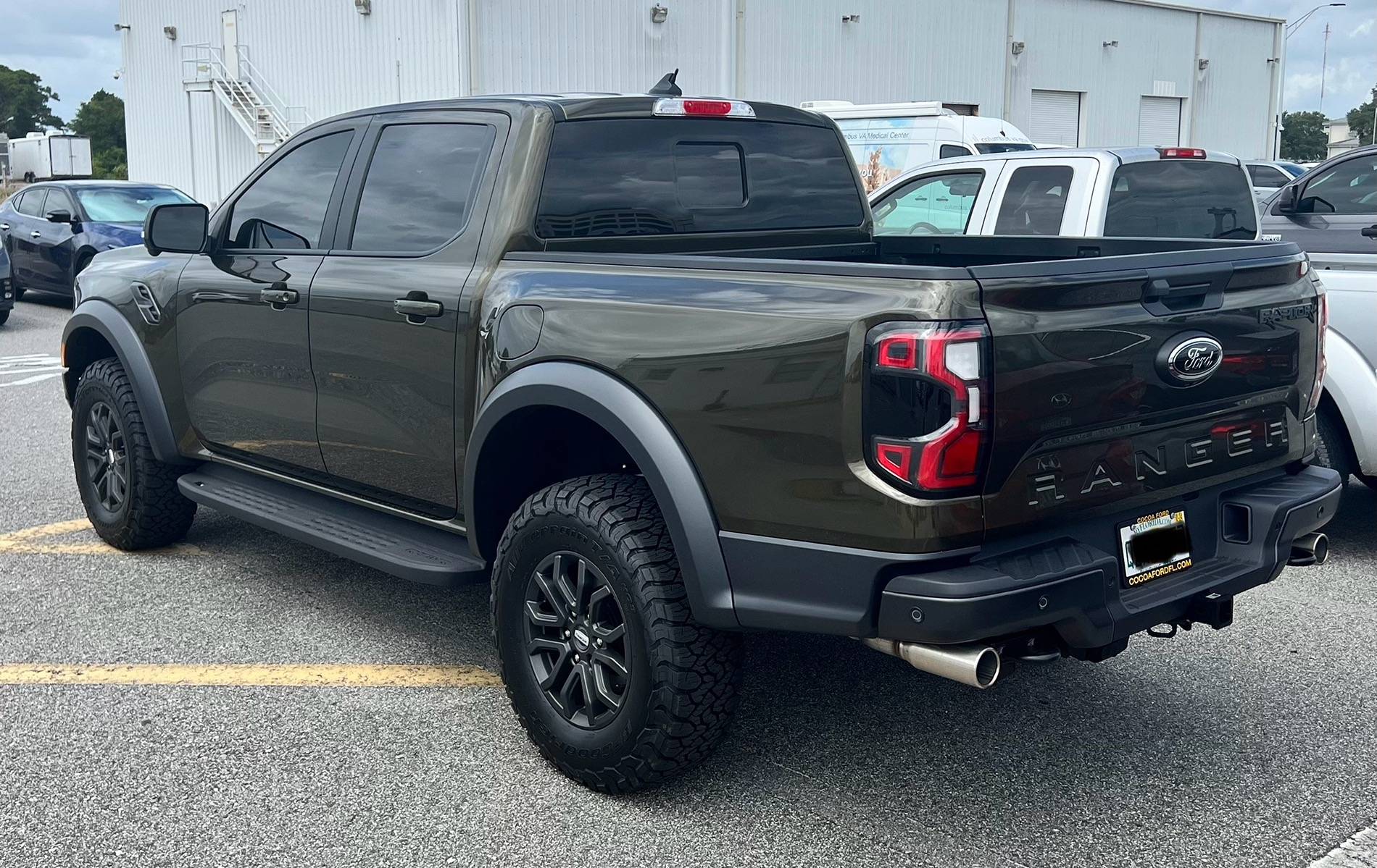

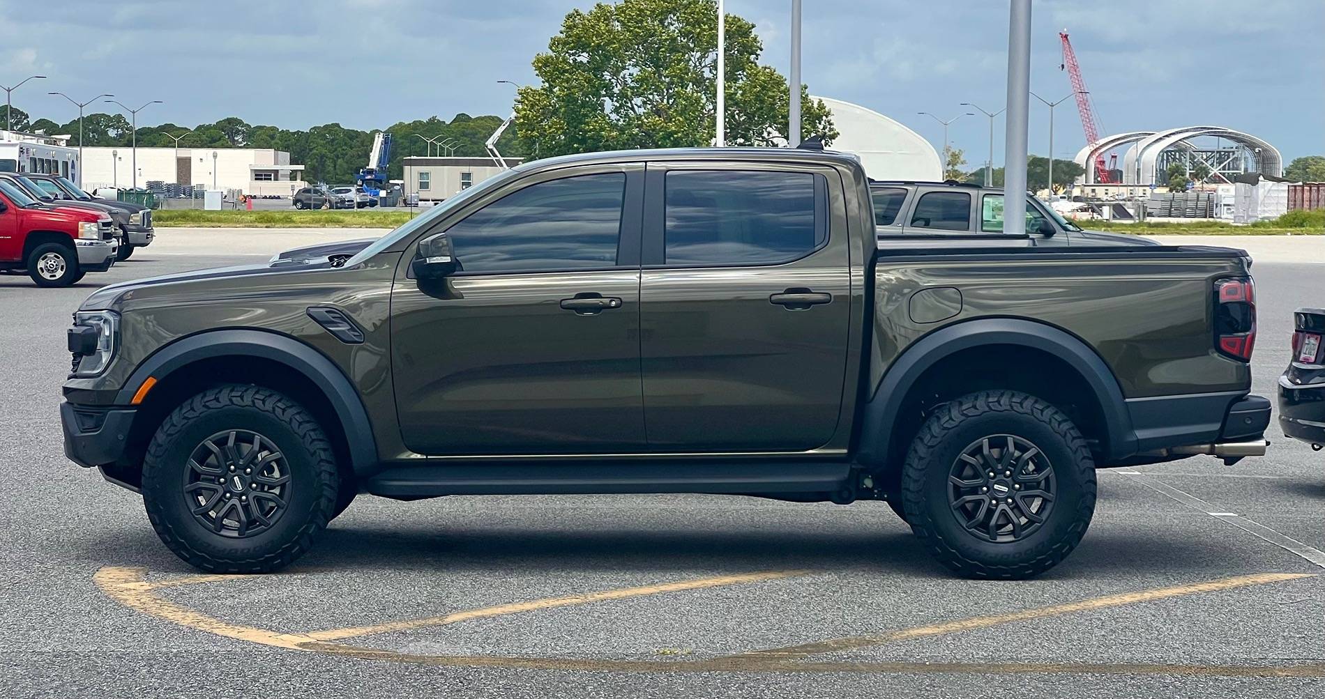

Tint looks nice. Not sure how nanny state Florida is on tint, but those tint levels are less VLT than the tint law there.

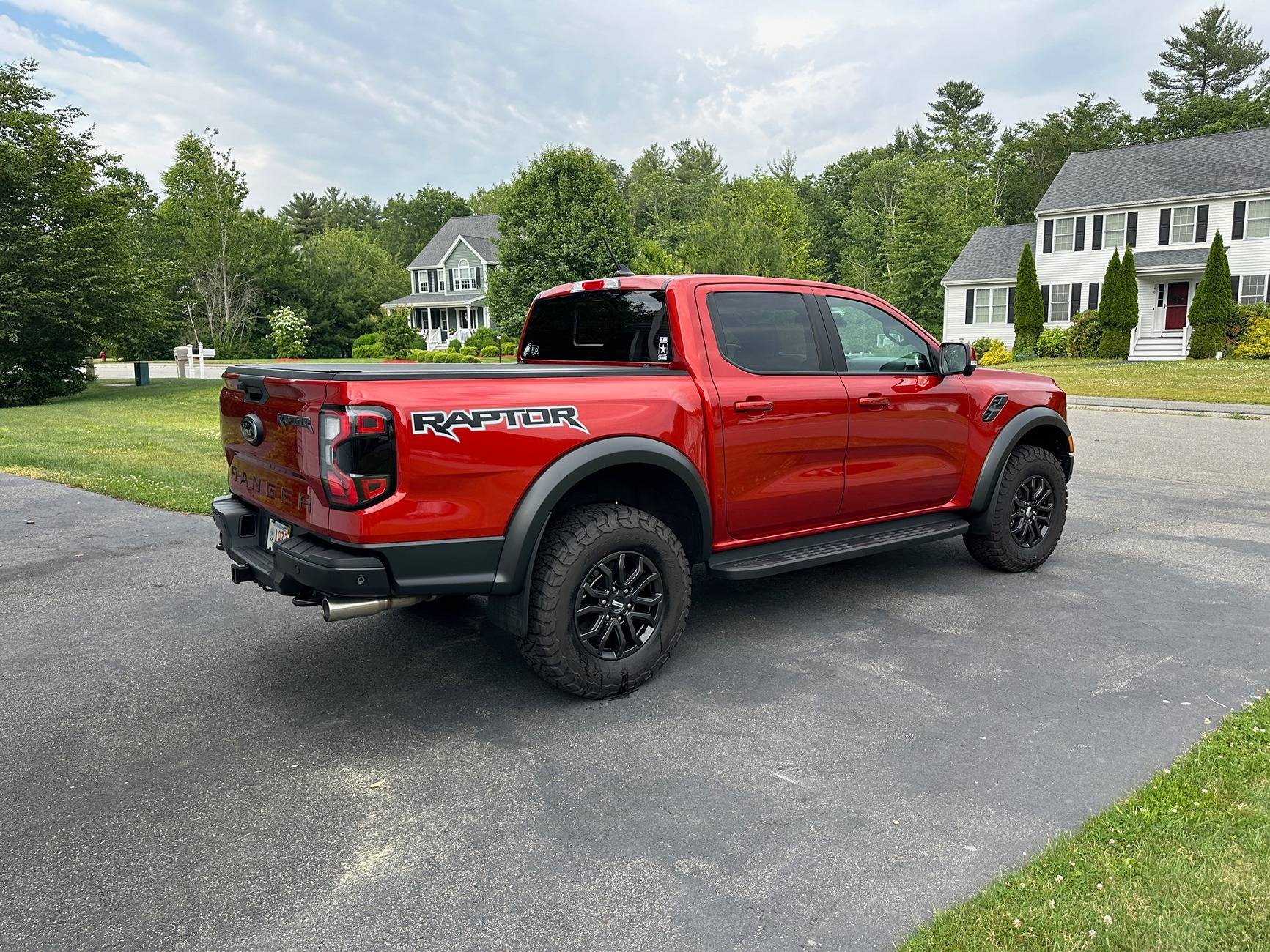

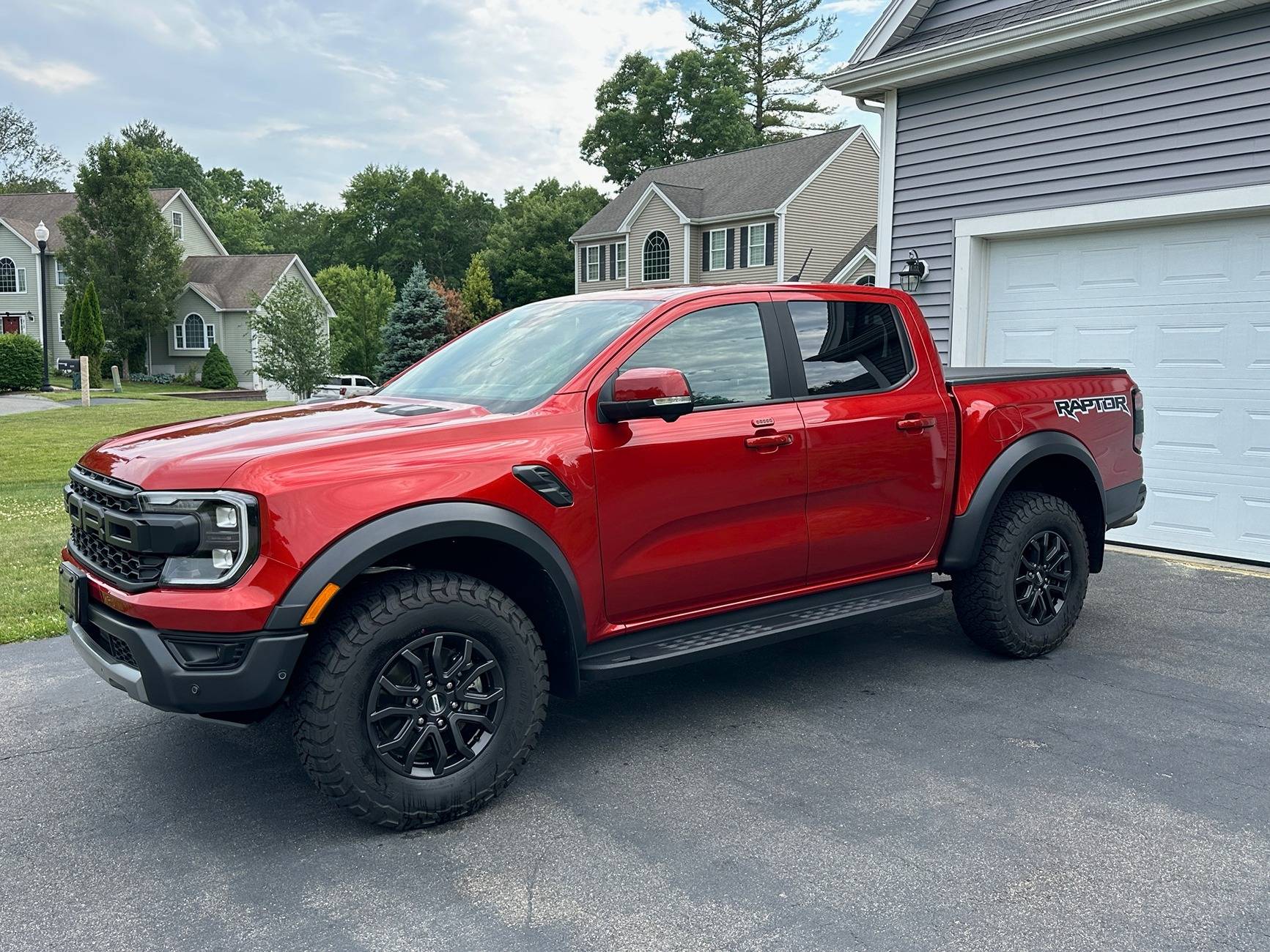

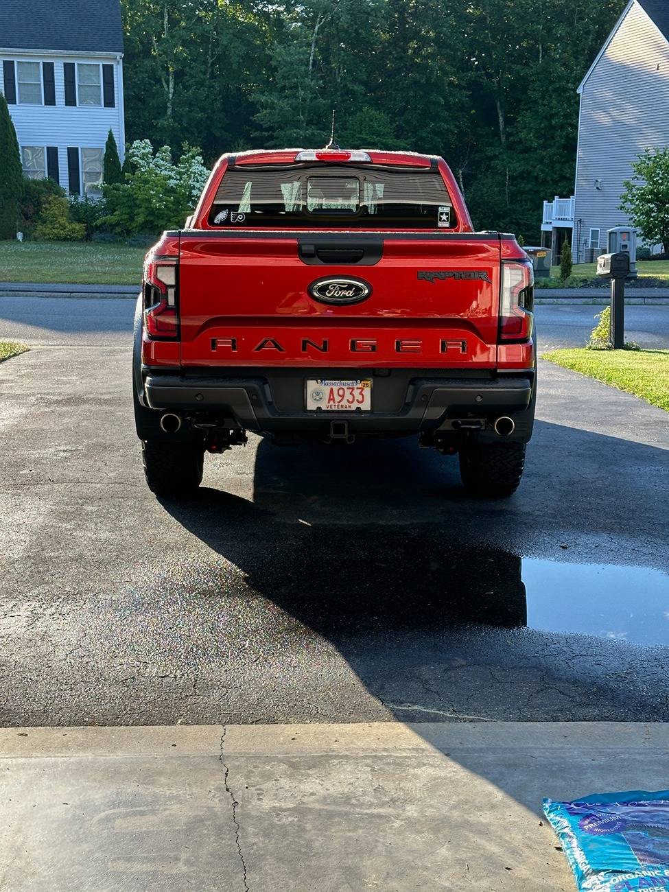

Installed a few things this past weekend...
@GregFoutz Collars, 2.5" Fronts and 2.0" Rears. The combo worked out to right on 2.5" of actual lift in the front and about 1.25-1.5" in the rear. Truck still has about a 2" rake, which is about what I was going for so I don't sag when loaded up.
