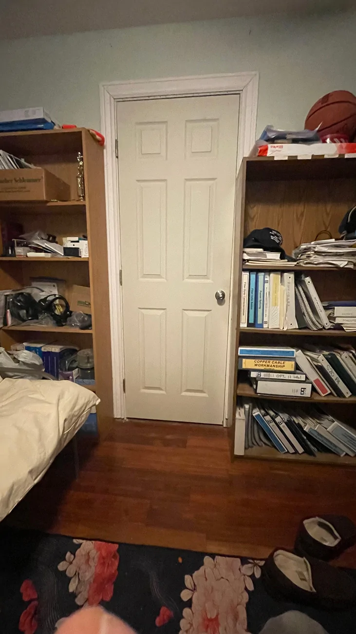

When i got the house, the 3rd bedroom shared a wall with the garage, but to access the garage you had to go through an outside door. built in '58, so i put a door in for easy access. Greatest thing ever. My PC will link with WiFi or Blutooth so i can edit from my PC ..

Dang, attached garahe and no access to the garage from the house? Thsts really odd.
I have a detached two car garage that has no way to get from the one side to the other. Its like two single car garages under one roof. Someone tried to make a pass through but the walls are concrete block, not cinder block, and they caused a large crack to the ceiling so when i got the place, i framed the 24" pass through they put in and closed it back up to try and add support for the second story as there is a low spot in the floor right above that pass through.
This building was built in 1941 the 93 year old neighbor told me years back. She said her dad, uncle, and brothers poured the blocks in the yard and built the house and the detached garage.
So, no fix for my garage but just having a garage was a huge upgrade from living in a mobile home park previously.
