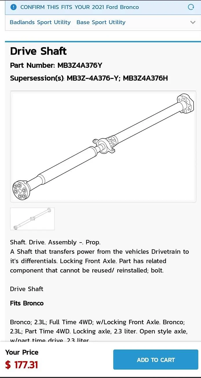

Aside from what I mentioned, I did the same as you and verified it wasn't an engine related issue. I took a video one night to document the noise since it isn't there when the truck is cold (posted earlier in this thread). Sure enough dealer took it out, didn't hear the noise. I showed them the video and explained it needed to be driven. So they gave it to a porter and had him drive for about 25 miles on a nearby interstate. Tech heard it after doing that.
It was most evident starting around 35 mph when decelerating and was loudest between 25 and 15 - continuing all the way down to a stop. At it's worst, about a week after I first heard it with the windows down, I finally heard it in the cabin but only because I had been riding with no radio so I could try and get some more info.
Initially, I thought it might be a bearing or at the very least something in the driveline. So far so good with the fix.
Here's the part that was replaced.

Well magic. Replaced the parts mentioned here and NO MORE NOISE. Thanks Carbon6G for all your help. After showing your posts to the dealer parts ordered overnight and put in today. So day one perfect. It also reduced the front end vibrations as well. Amazing. Thanks again.

Not sure if you have a 4x4, but at 1100 miles had to have the front drive shaft replaced. Only showed up after driving for a little bit, not when cold.

See post #12. It has the part they replaced. They didn't go into detail other than the front driveshaft was the issue. The hardest thing is getting them to drive it so it can be replicated since most of the time dealers blindly drive it and say they can't find anything wrong.
