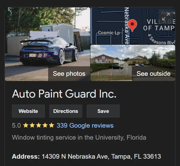

I had Auto Paint Guard do my last vehicle and was extremely happy with the results. They are an XPEL dealer though. Have an appointment with them tomorrow.
