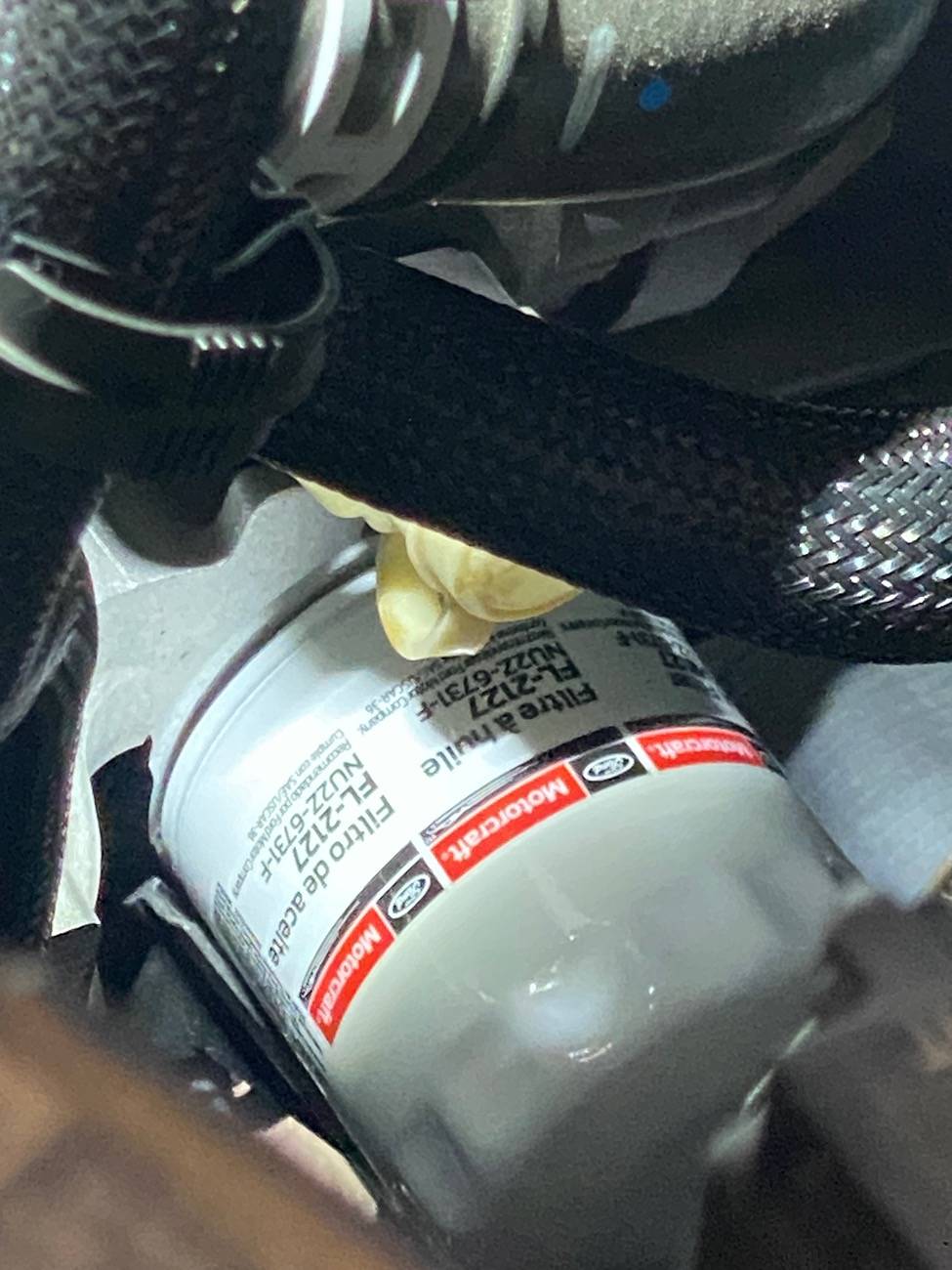

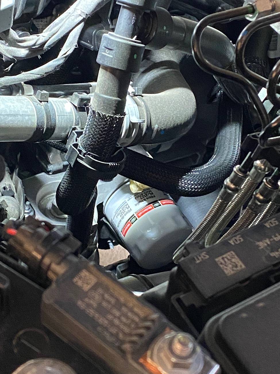

So I’ve already put 7500 miles on my 2025 XLT, and I decided to do my first oil change.
I went to the autozone by my house and picked up 6qts of full synthetic 5w30 and the FL-910S filter that fits my truck, according to both online fitment checks and the autozone guy.

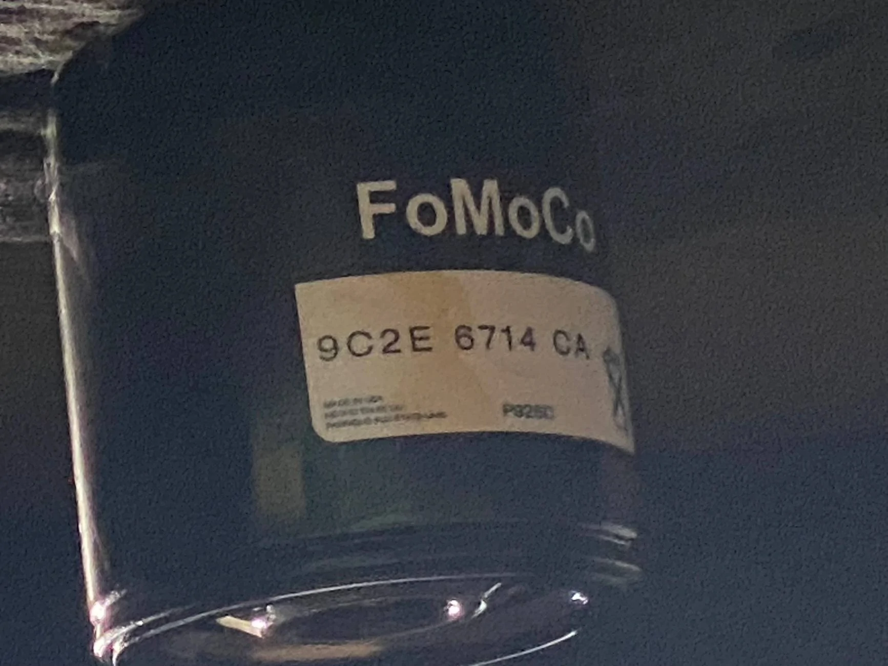

I drain my oil and pull off the old filter, no problem. But then when I go to install the new filter, it doesn’t fit. I mess with it for a few minutes before I pull out my calipers and measure about a 0.2” difference in diameter of the center holes between the filter I pull off and the FL-910S.
I call around to some other autoparts stores (O’Reillys, NAPA, Advance, etc.; didn’t call ford because this was a Sunday and they were closed), and they all told me the FL-910S is the correct filter.
Did some digging by googling the PN of the original filter I pulled off, which is 9C2E-6714-CA, and found people having a similar issue with their Escapes, which also use the same filter.

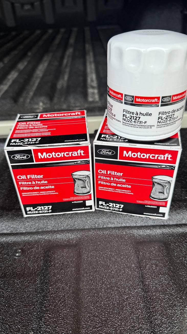

From that forum, I found that the FL-2127 filter is one I needed, despite what all the auto parts stores were saying. I went and picked one up, measured just like the one I took out when I compared them, and it fit perfectly.
Did more digging and I found some people saying the 2.3L for 2025 is completely different than the one’s in the 24s and earlier (despite the 24 having the new body style), and while I didn’t hear this from a credible source, the FL-910S will fit the 2024s and earlier, and the 24 & 25 valve covers look completely different so it seems to be true.
TLDR/bottom line: if you have a 2025 with the 2.3 and you like to change your own oil, everyone will tell you that you need an FL-910S but you really need FL-2127. FL-910S does fit earlier rangers, including 24s but not 25s.

Yep. Welcome to the shit show of misinformation when it comes to the 2025. The online manual also shows 6 qts of oil but the pdf version calls for 5.6. I changed mine out last weekend and put 6 in it. No clear answer really. Don't buy a Mobil 1 M1-102A filter cause that's for the 24 model. I got lucky and my O Reillys in town had ONE FL2127 in stock. Saved my bacon.

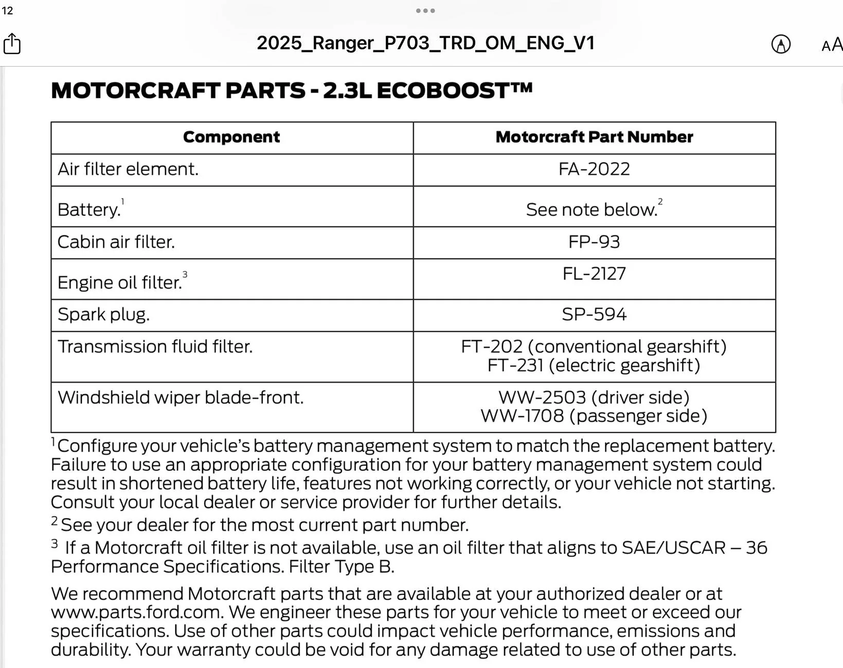

We should normalize looking in our owner's manuals for information, especially basic info like which oil filter to use. Page 462 of the 2025 Ranger Owner's Manual lists the proper filter, so apparently is a better source of info than the Autozone guy.
https://www.fordservicecontent.com/...nformation/2025_Ranger_P703_TRD_OM_ENG_V1.pdf

To be fair, this is my first new car. I upgraded from a 2002 BMW 330i (which I still have and love dearly) that was my only car for 8 years. It has 260k miles and never had an owners manual lol, so I just got used to not thinking about that.
But you are correct, that should be the starting point for most people
