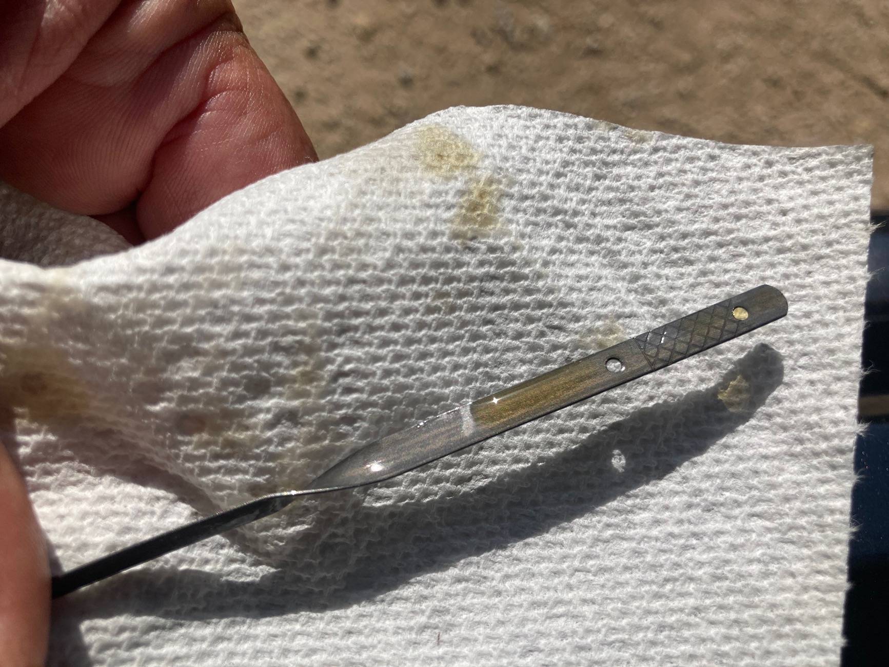

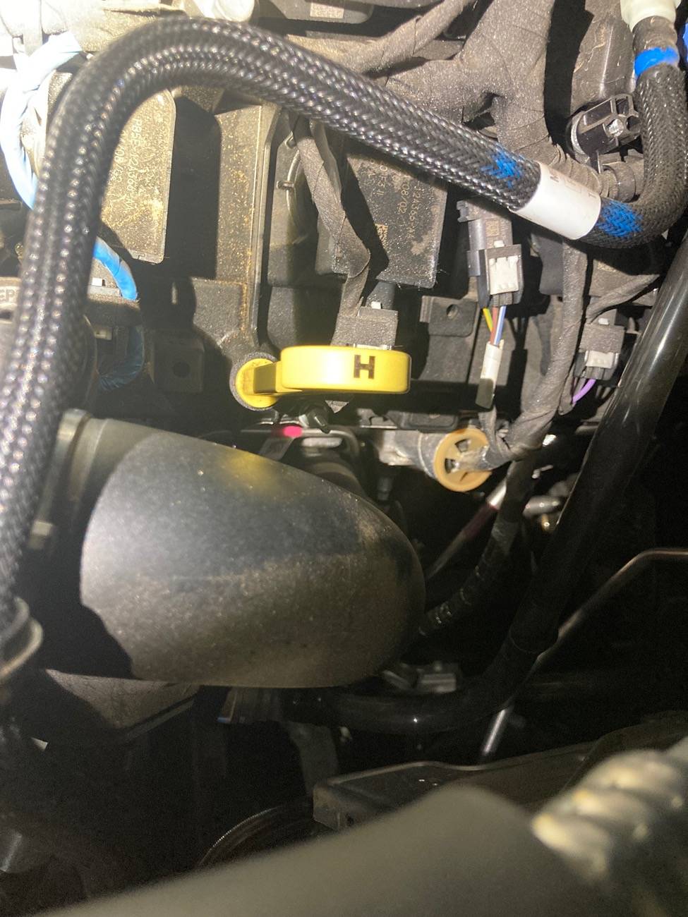

Can anyone confirm the dipstick with the Triangle stamp exists? Or are they all stamped with the H designation?
I’m referring to a 2024 Ranger Lariat with the 2.7 EB engine. The EPN on mine is FT4E-6750-BG. My understanding is that the new triangle stamp is the newer version. If anyone can confirm this I would appreciate it. Thanks to all replies and thanks to the forum.

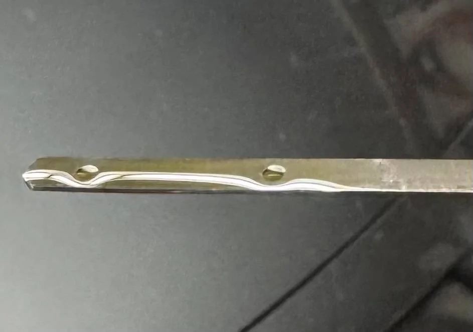

The stamp is in black ink at the very top of the loop (handle). Mine is the “H” stamp, which I suspect is an earlier version of the stick that has since been updated with a black triangle stamp. This would be my second 2.7 engine owned. My 2016 F150 had neither. The reason for my inquiry is the stick consistently measuring overfilled on my 2024 Ranger Lariat with the 2.7. I have measured 6 quarts out, and 6 quarts in, yet it still shows to be over filled by a quart. Based on the endless threads on the Bronco forums about wrong dipstick dilemmas, I’m trying to determine if the “H” stick may simply be the issue. It’s my understanding that the newer dipstick with the triangle stamp may be updated, but still shares the same part number. I’ll try to update this thread with a picture of the stamp.

My 2025 XLT 2.7 built in March has the H dipstick.
