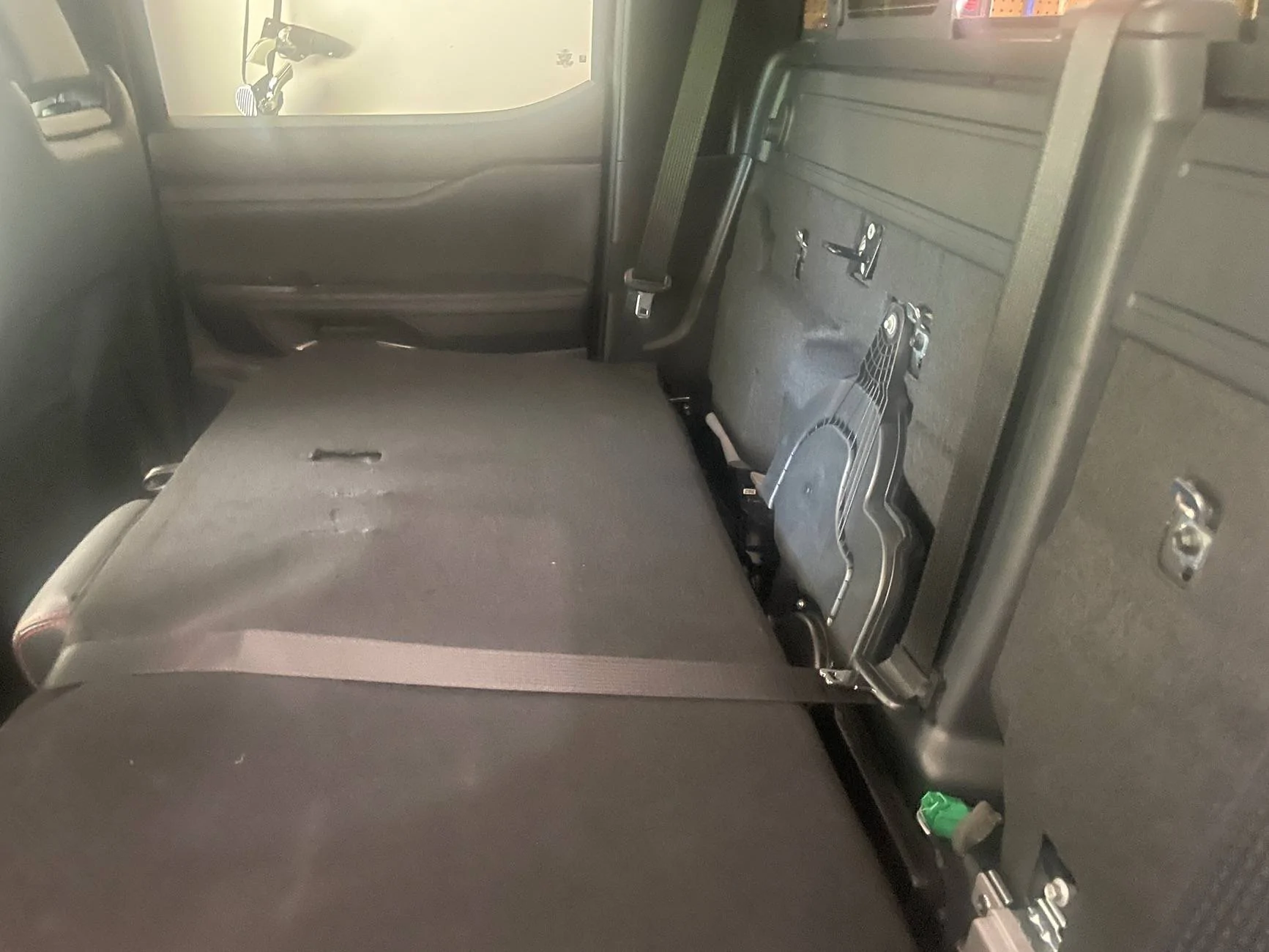

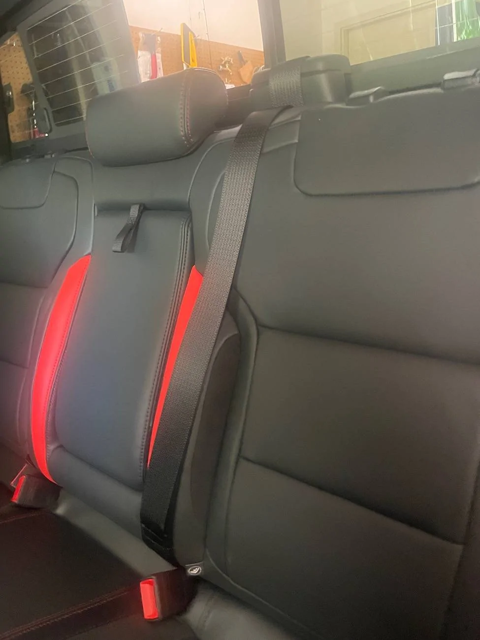

I missed the folding headrests in the rear of my 5G SuperCab, so I asked around to see if they would fit in my new truck. I found a set on eBay and they they're a direct fit. For an XLT with the dark cloth interior, the part number is MB3Z21611A08CC.

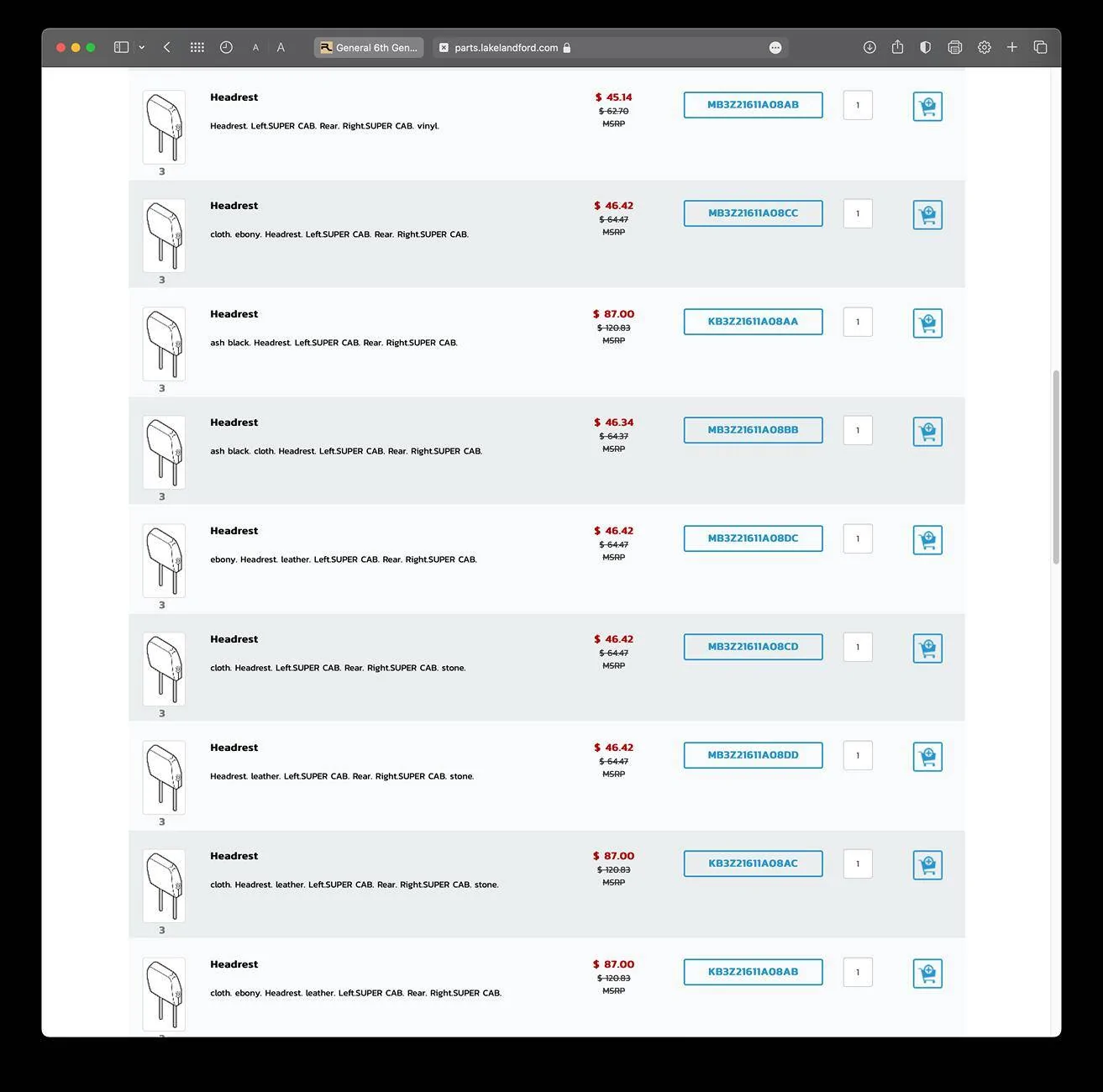

Ebony Cloth matches my XLT exactly.
Ford Ranger Folding Headrests installed Screenshot 2024-07-01 at 13.20.59
This should cover them all. The '21 and up Ranger SuperCabs had a recall that gave them all folding headrests since the non-folding ones interfered with car seats and unlike the SuperCrew, you can't fold the seats down to take them out.

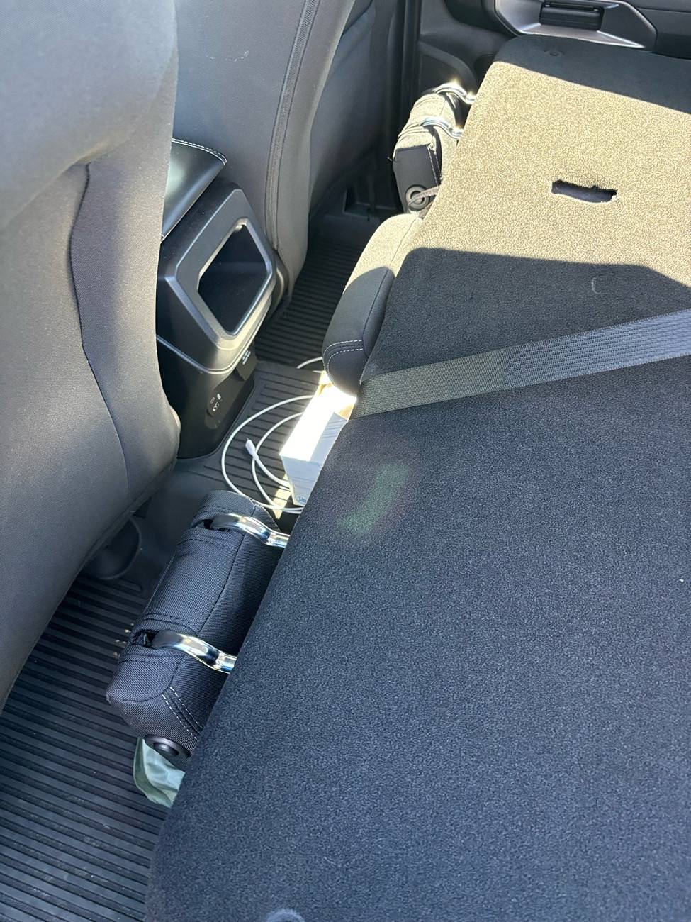

The best part of the a the folding ones is that you don't need to move the seats forward or remove the headrest to put the seat down now. It should have come this way. MY new headrests were $80 through eBay, but are around $100 new from Ford dealers online. Levittown Ford on the 5G forum will give you shipping discount codes if you PM them.

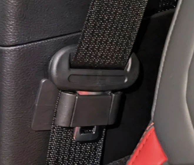

Now find on Ebay something to take care of that center strap!
