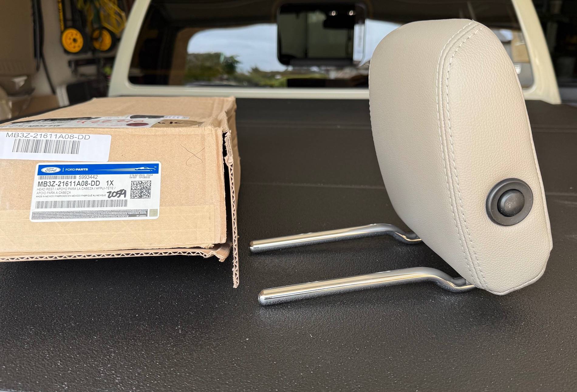

This one is leather
I found out the hard way that not all the leather 5g headrests tilt.
for example this part number does not tilt.
MB3Z21611A08DA

Only the SuperCab versions from the 5G tilt. There was a recall that forced Ford to change them to tilting models since the headrests interfered with a child seat when installed. The non-folding headrests couldn't be removed at all since the seat in the SuperCab doesn't fold down.
