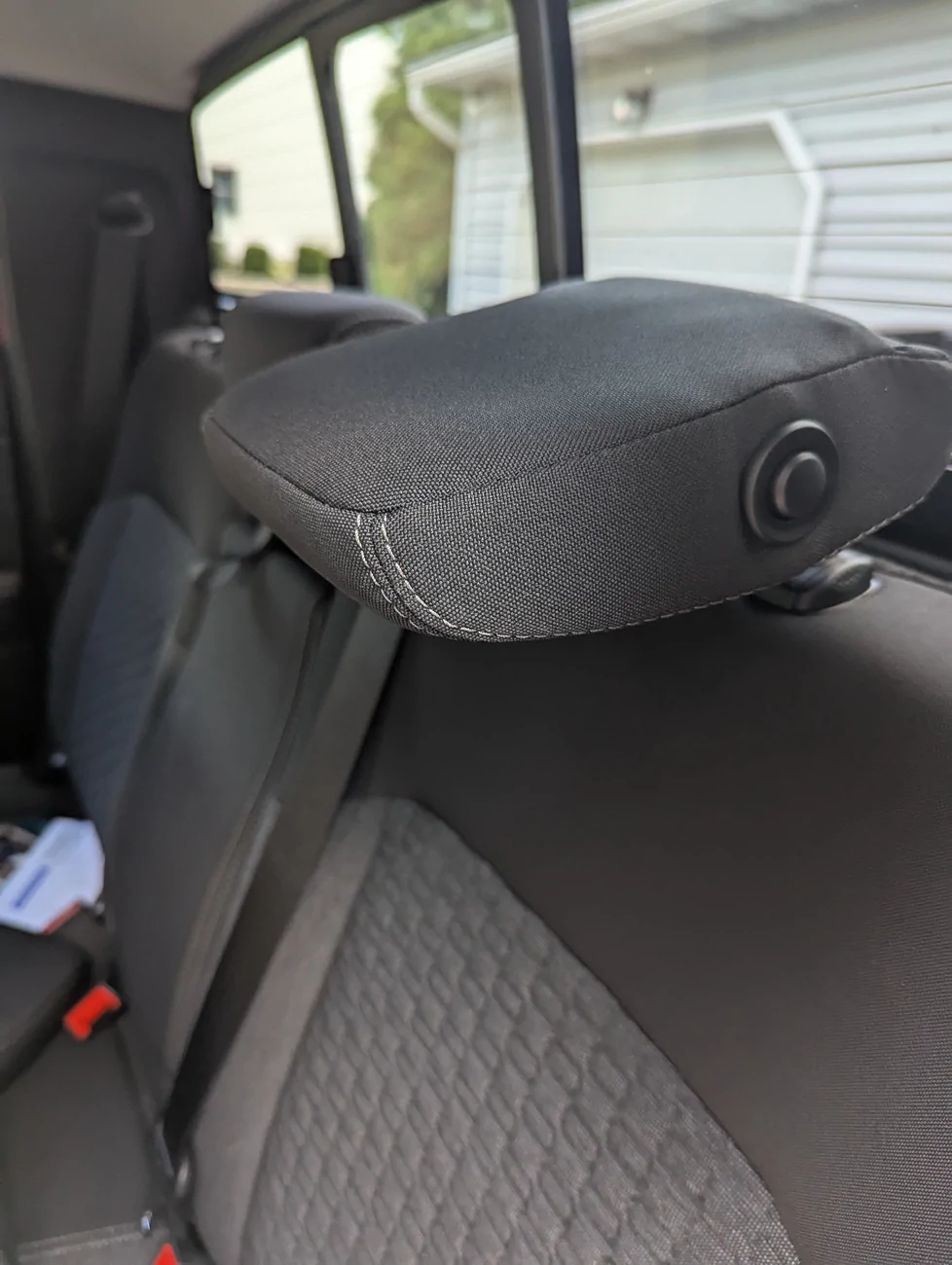

Only the SuperCab versions from the 5G tilt. There was a recall that forced Ford to change them to tilting models since the headrests interfered with a child seat when installed. The non-folding headrests couldn't be removed at all since the seat in the SuperCab doesn't fold down.
Thanks Jedadiah for all of your insight on these headrests. I have a 2025 XLT Ebony cloth and I assume the part number would be the same as 2024. Do you have a link for the ebay vendor that you used? I see that Fastlane OEM has them listed for $39 and free shipping.
Thanks again!

I bought them on eBay for roughly $40 each, so it looks like you have found. good seller. I assume if the fabric name hasn't changed then you should be safe on color.

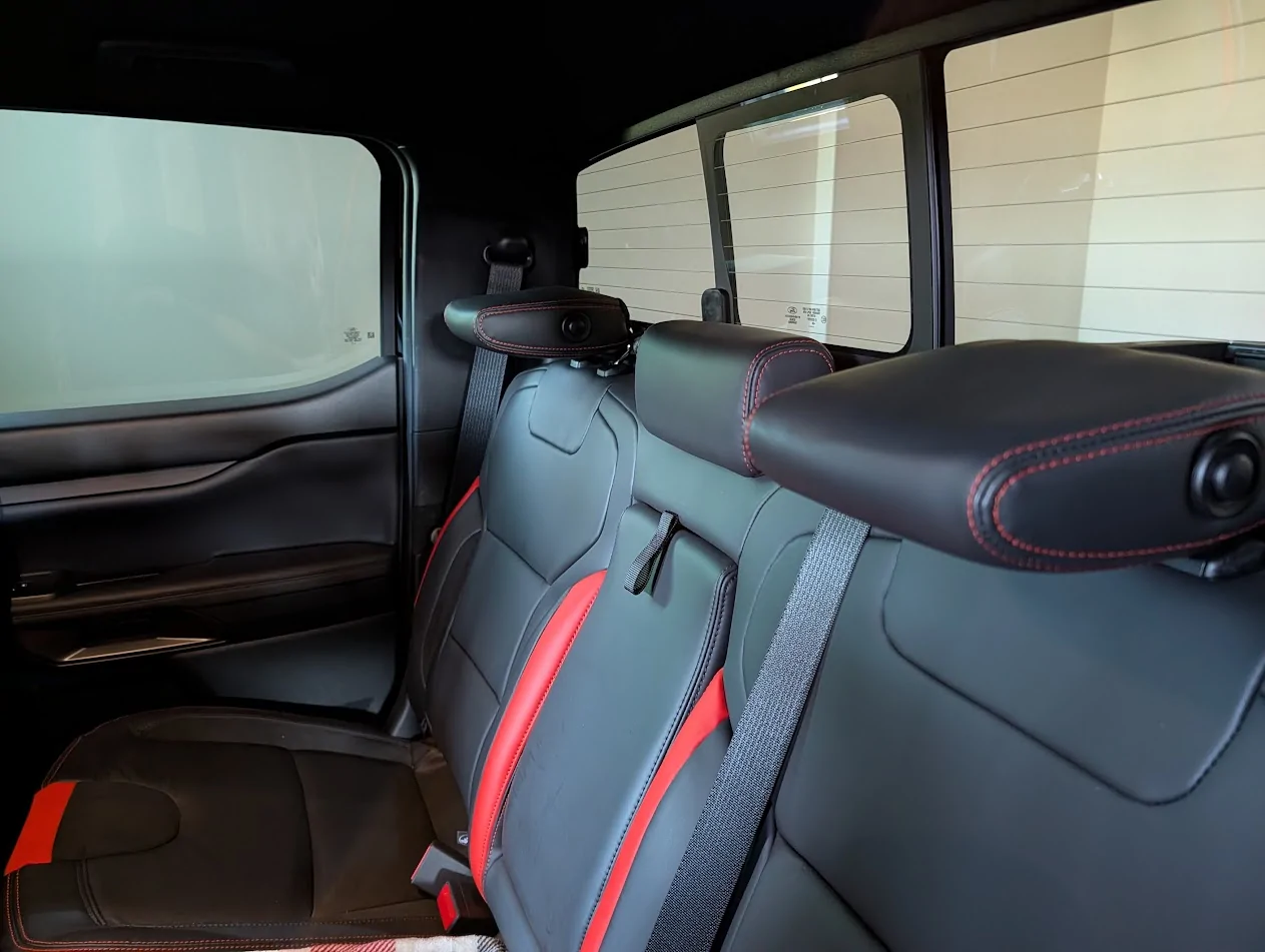

I wonder if you could take the Raptor leather off and make it work with these

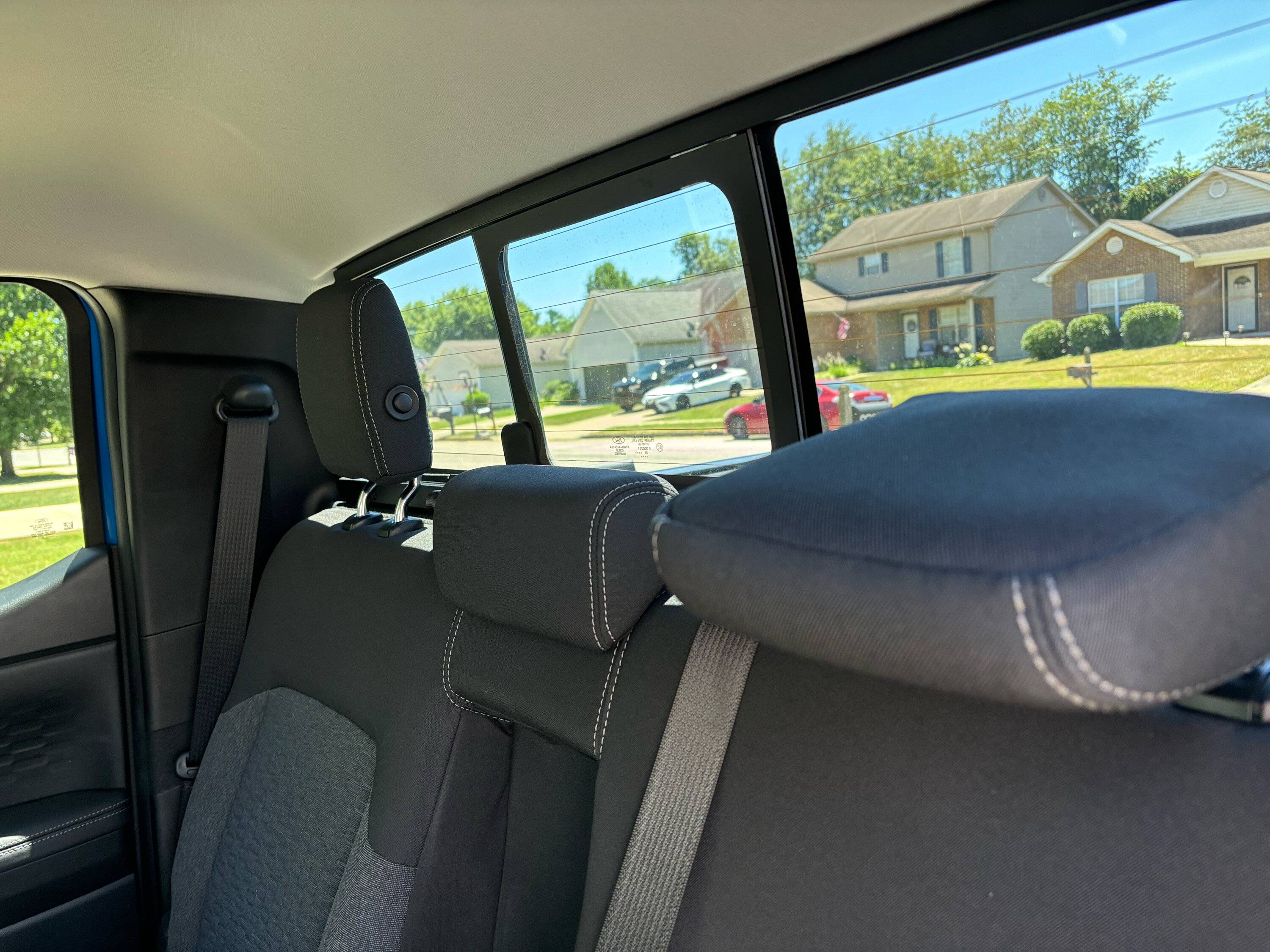

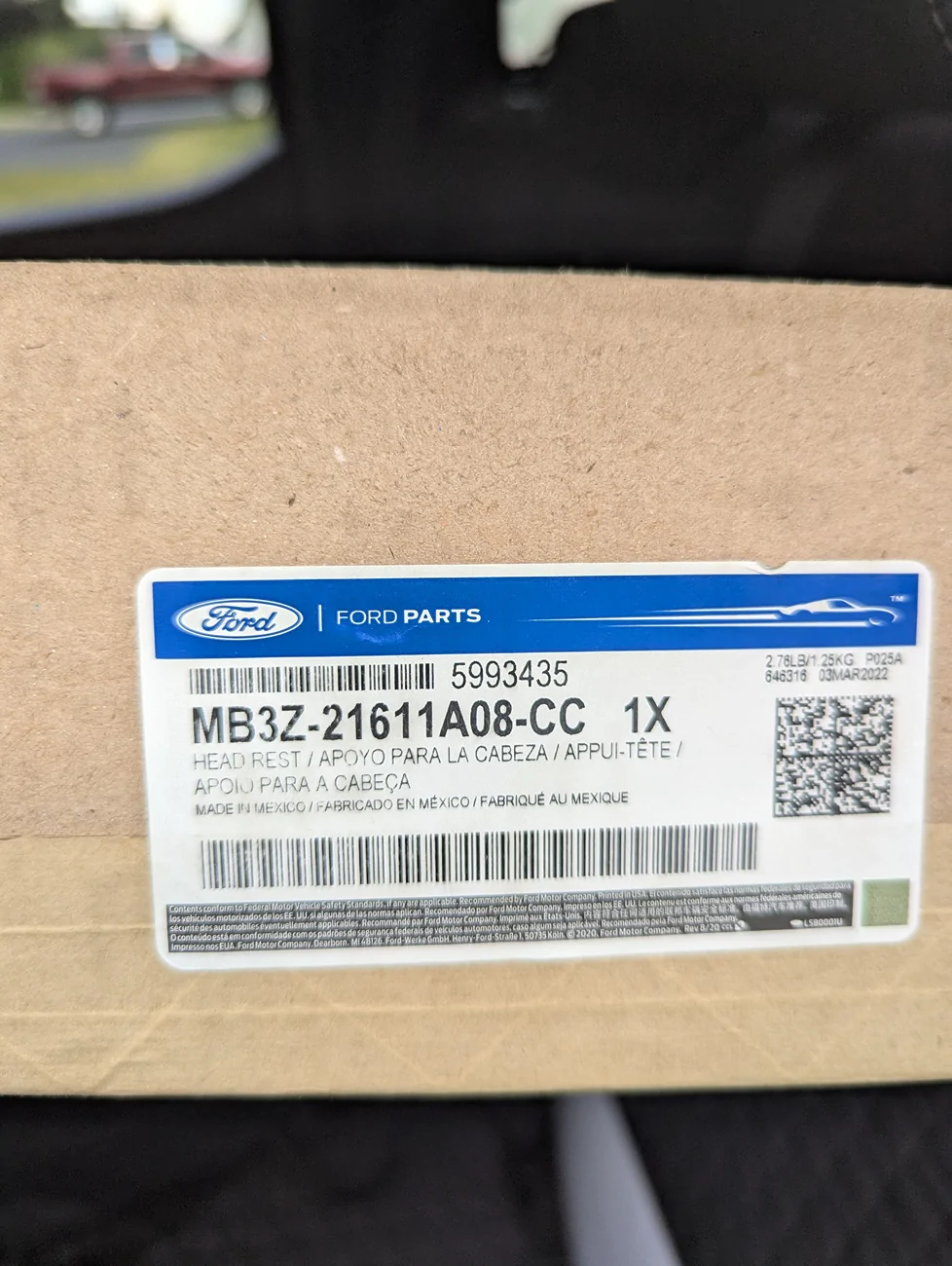

Thanks. My local dealer had a set that I got for $40 each. I can confirm that the part number you listed works on the 2025 Rangers as well. Ebony was a perfect match for my interior. Thanks again for all of your information!

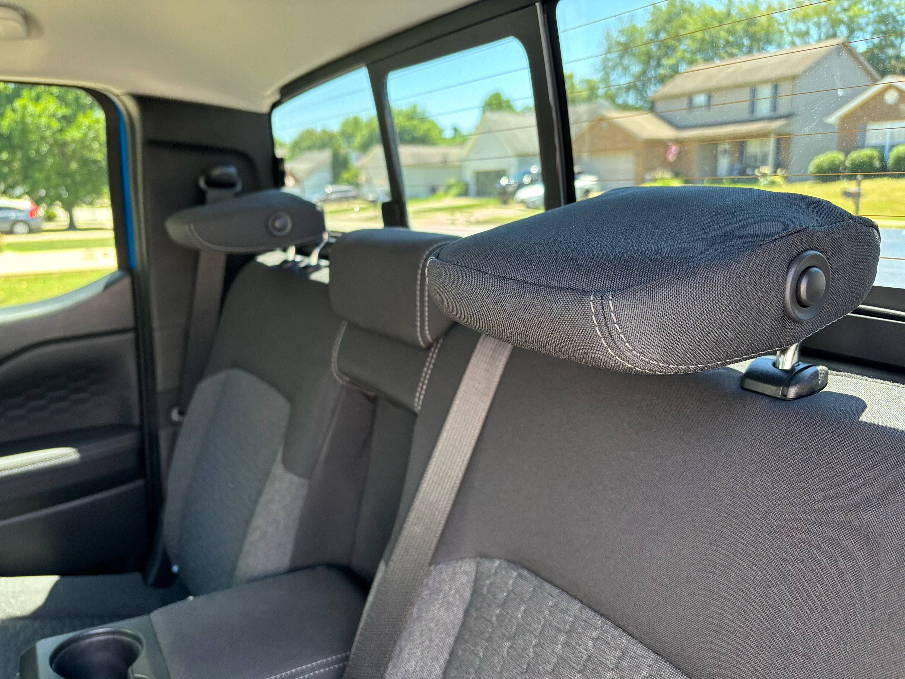

I just found this thread, I was wondering about folding the seats down with the the headrests, that doesn't normally work well on any vehicle and my truck hasn't arrived yet so I couldn't check. This is a good solution and one I can definitely use as with no kids we will be folding the back seat down a lot of the time.

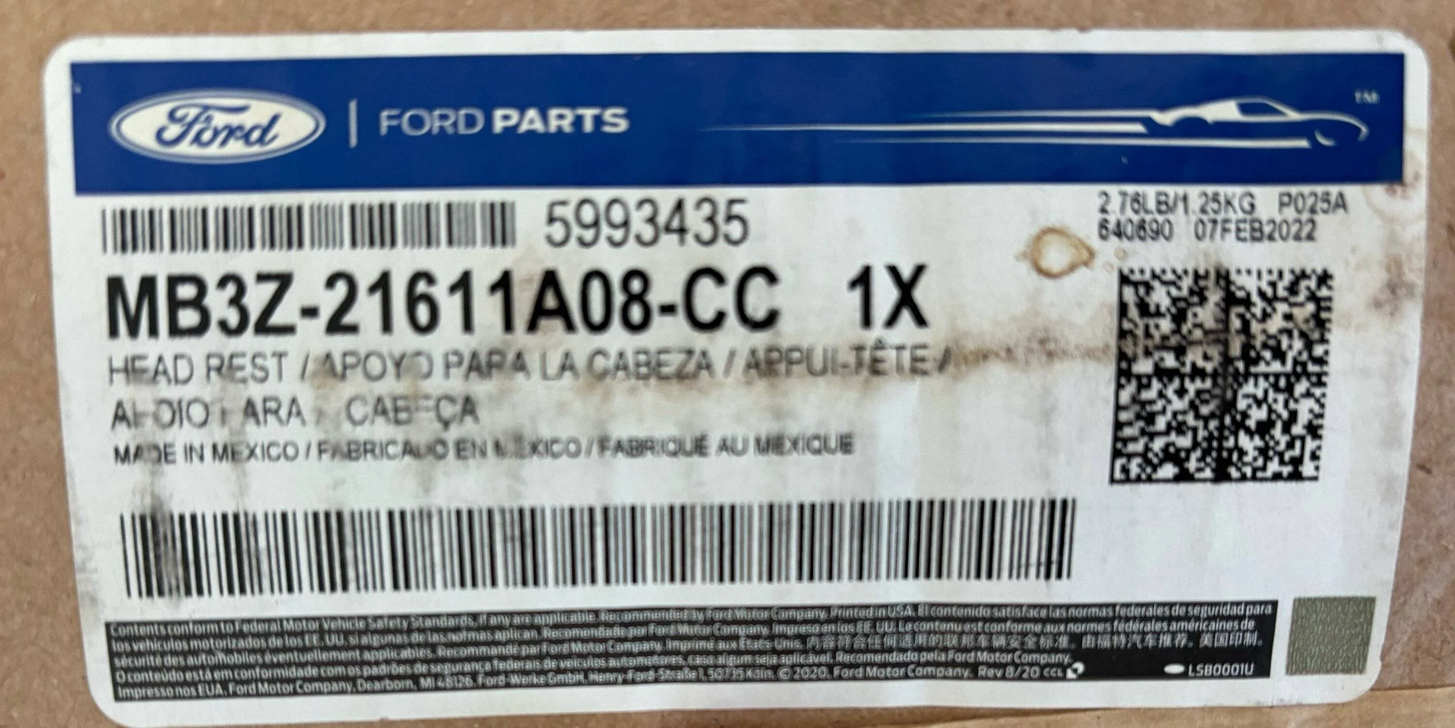

I missed the folding headrests in the rear of my 5G SuperCab, so I asked around to see if they would fit in my new truck. I found a set on eBay and they they're a direct fit. For an XLT with the dark cloth interior, the part number is MB3Z21611A08CC.

Did the folding headrest retro-fit mod. Ordered a pair of MB3Z-21611A08-CC just like the OP suggested. Ordered directly via the Ford parts website. Found a dealer within the service area offering the parts at a ~20% discount and got free FedEx overnight shipping. Long story short.....the folding headrests out of the previous gen. Ranger fit to an absolute "T." The detent functions exactly the same. With the headrests folded down, the seat-back still folds down flat. There's plenty of clearance between the headrest and sliding rear window.....absolutely no interference with the glass or power coupler. And for those with ebony XLT cloth interior the color/fabric are a bullseye match.

Did you swap the leather covers or did you find ones that came this way?
they modified the covers to work with the buttons. i think its in this thread or another one
