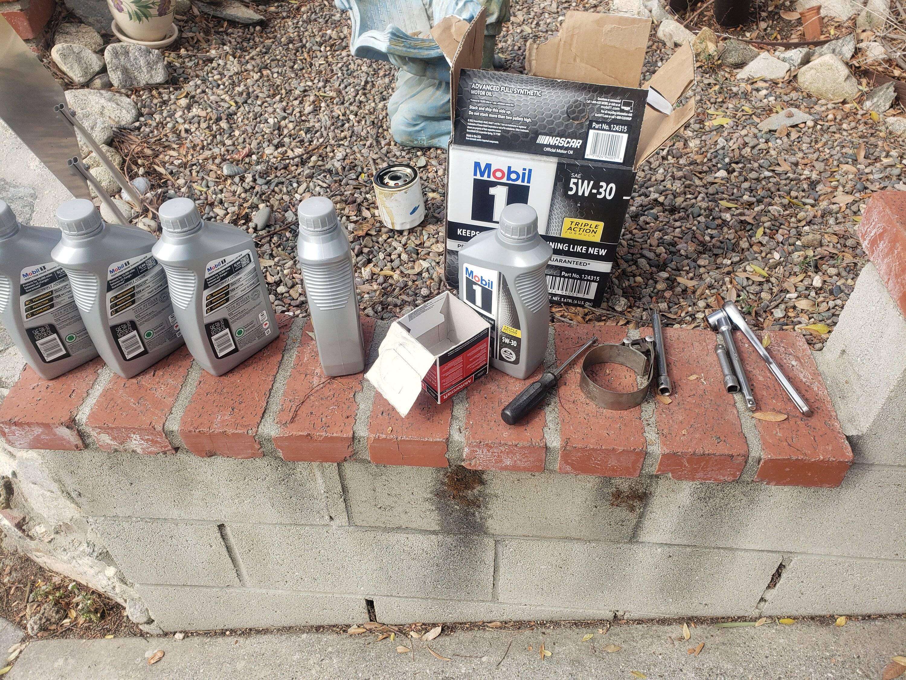

I have always done my own oil changes on my vehicles, and wanted to continue with my new Ranger, but with the placement of the oil filter, it looked like a difficult task. Well, I had already bought Mobil 1 oil, and a motorcraft filter, so I decided to tackle it.
This is what I used to do it.
Ford Ranger DIY: 2024 Ranger 2.3 ecoboost oil change with pictures and details Oil Change items needed

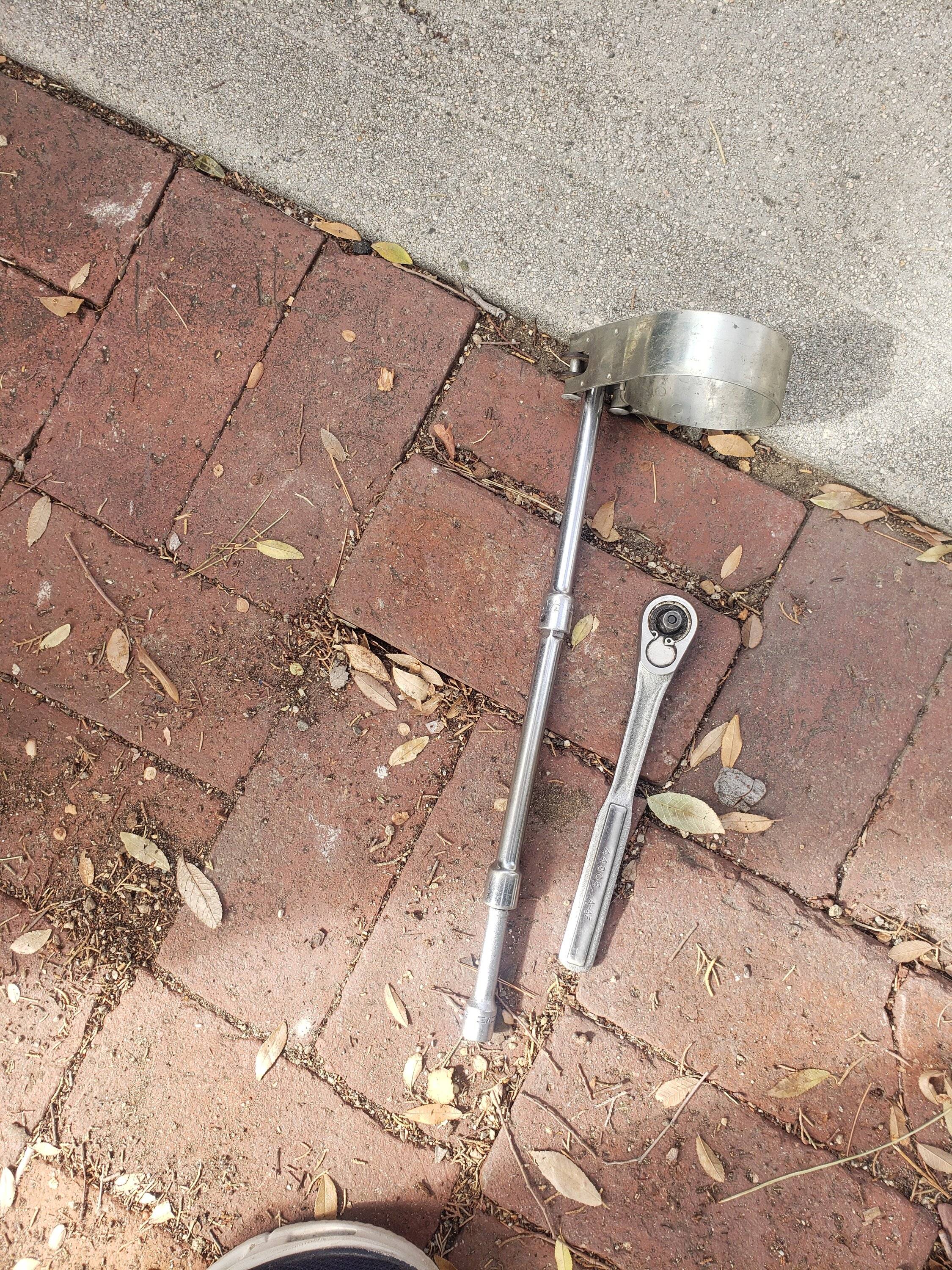

I had a strap type filter wrench, that attaches to a 3/8 extension and wrech, and it proved to be ideal
