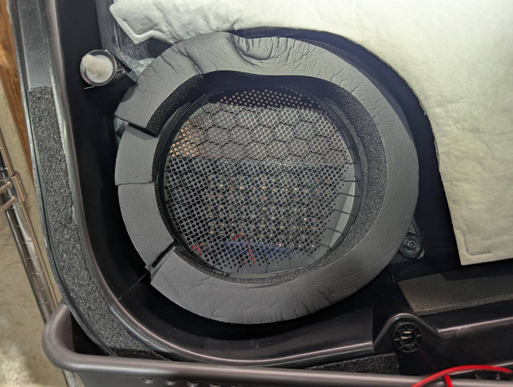

Went back and added some memory foam to the rear door panels to mash up against the speakers.
https://amzn.to/42Ut42S
Cut the ring into pieces to go around the door panel side instead of sticking to the speaker itself. Put in two layers, thickest towards the rear of the vehicle since the panel is tilted that direction and the speakers are flat on the door itself.
