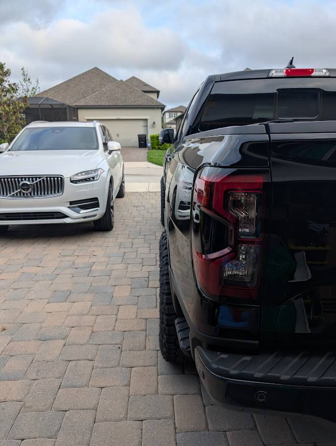

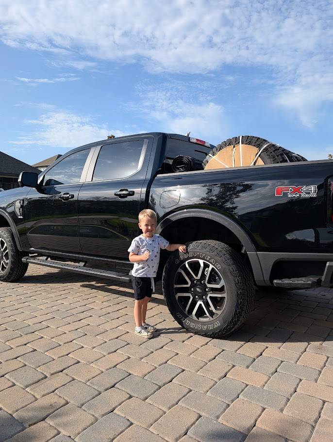

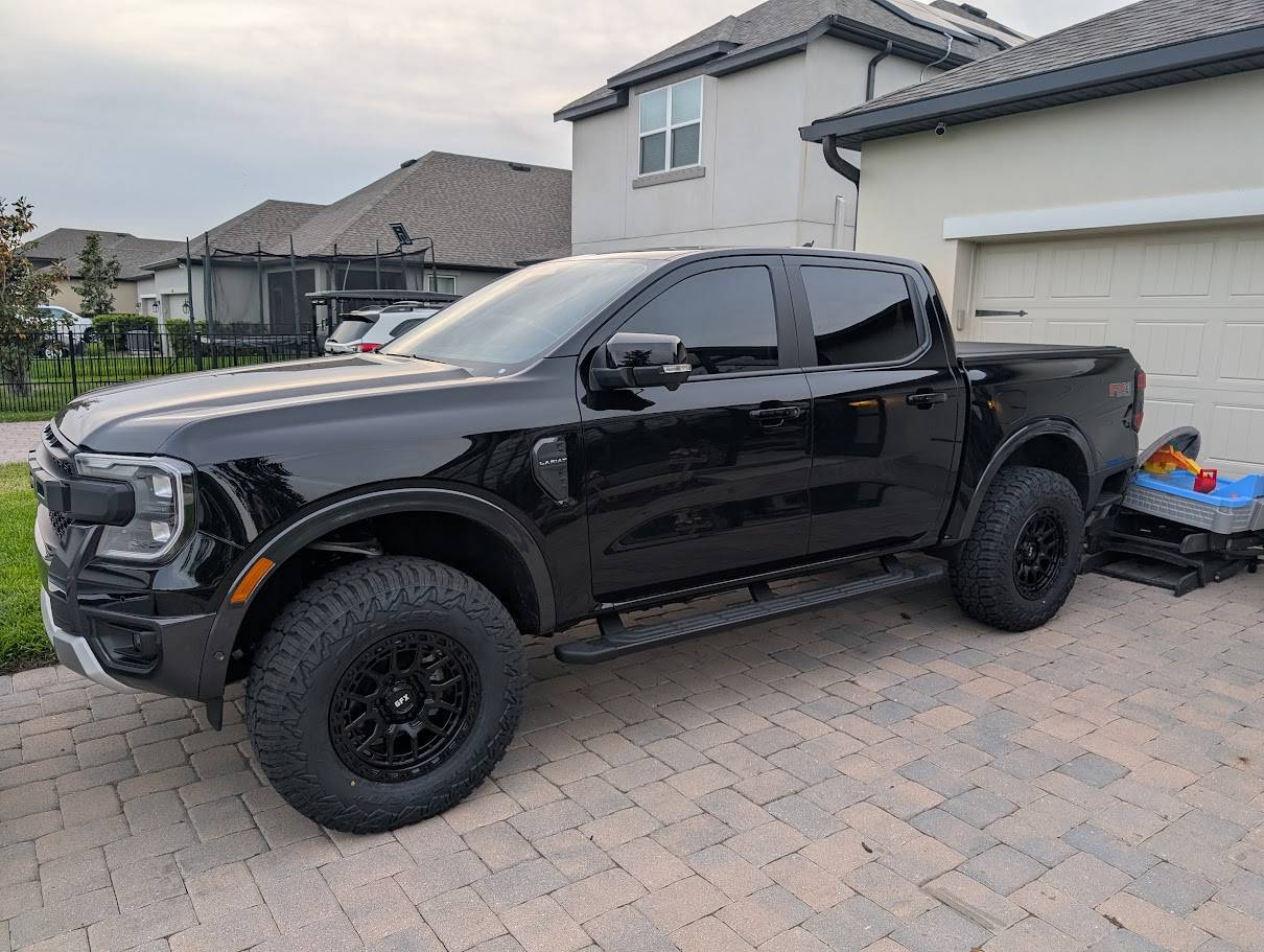

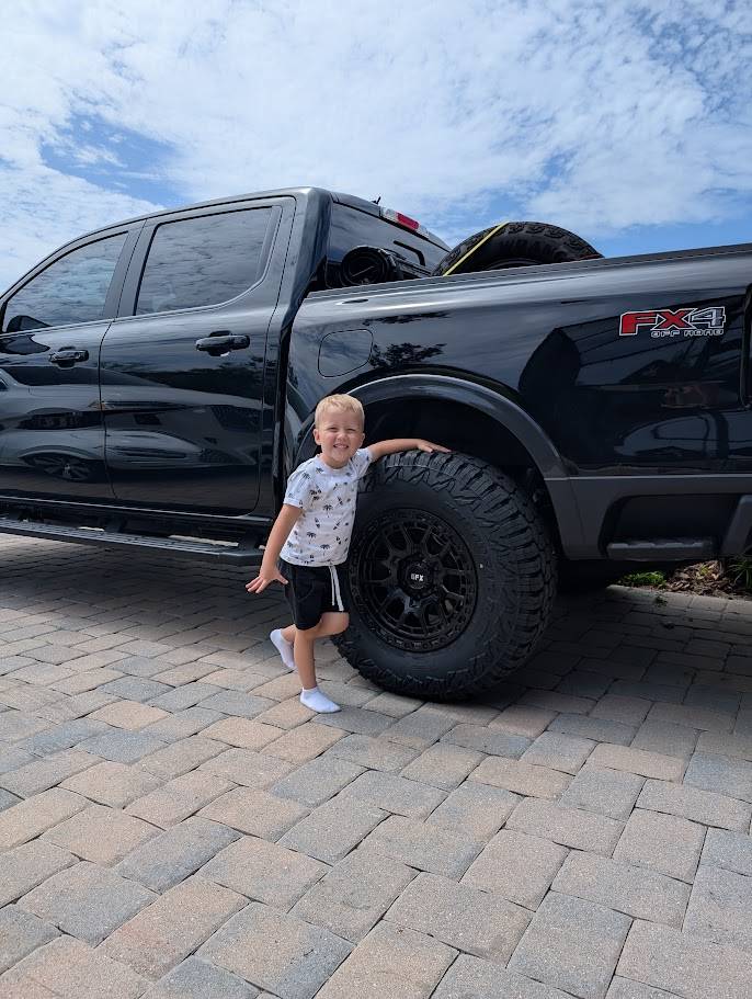

Got a set of 285s on the Ranger. Has the Superlift 2.5" to level it out with the Wildpeak R/Ts on 17x9 G-FX with +12mm offset.
They ride quite a bit smoother than I thought they would. Bit of road noise but not unbearable. Tiny rub on the liner for driver side (small bump out on the liner that can be trimmed on the front side).
Good before and after using the boy for size comparison.
Ford Ranger 285/70R17  Falken WildPeak R/T01 + 2.5" SuperLift installed on 2024 Ranger Lariat FX4 After I
Ford Ranger 285/70R17  Falken WildPeak R/T01 + 2.5" SuperLift installed on 2024 Ranger Lariat FX4 Before I
Ford Ranger 285/70R17  Falken WildPeak R/T01 + 2.5" SuperLift installed on 2024 Ranger Lariat FX4 Outside I
Ford Ranger 285/70R17  Falken WildPeak R/T01 + 2.5" SuperLift installed on 2024 Ranger Lariat FX4 Poke I
