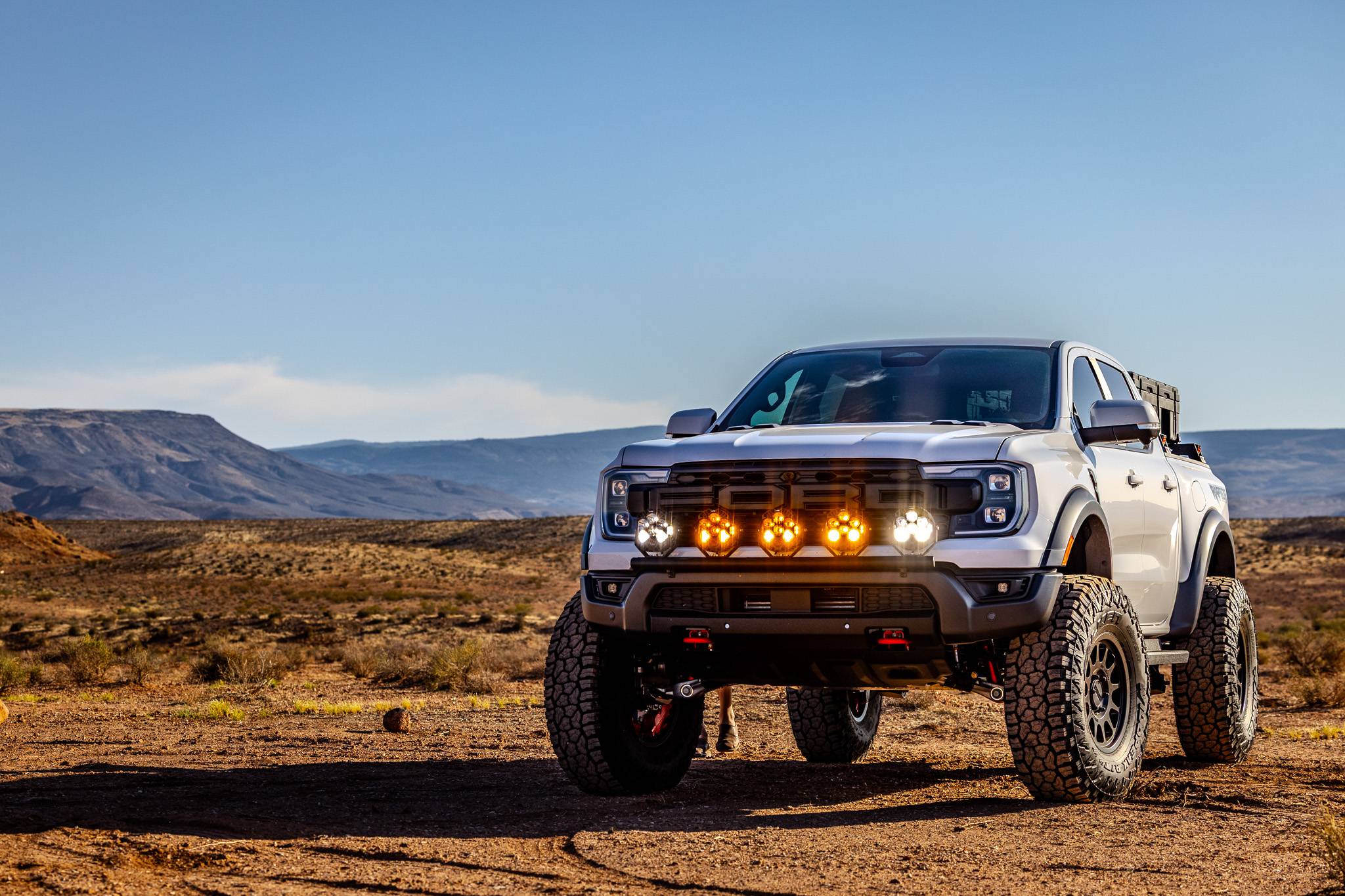

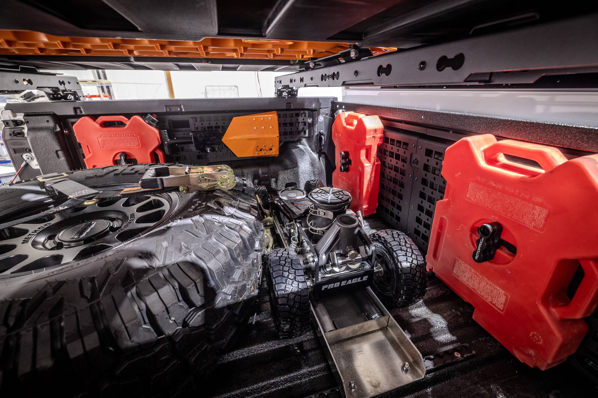

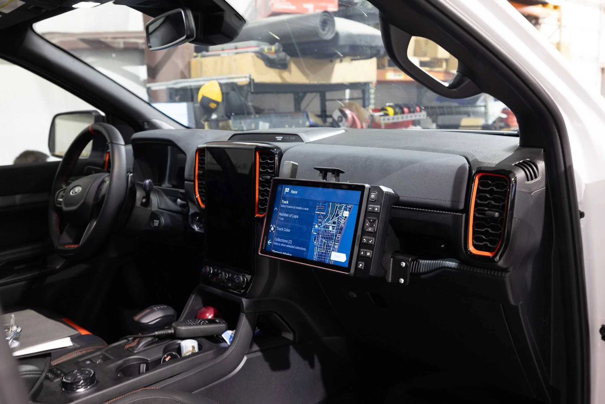

We were able to put the finishing touches on this amazing build today. We were just the last step in the build (bed RAIL system, bed MOLLE panels, jack mount, Garmin Tread XL dash mount, hitch plug relocation, ROAM box mounts, MAXTRAX mounts, and Rotopax mounts. Truly an amazing truck!
The 37's and 74Weld portals really set this one apart. It is also loaded with a few Foutz goodies that look great!
I won't know all of the answers to build questions, but I can give them a shot and reach out to the owner if it's something I can't answer.
He's headed to Baja with EXO in a couple of days on a Raptor run. I can't wait to hear how it does.

Sheeshhh! My wallet hurts just looking at it. Even with portals any problems with the 37s? Looks great!

This is my rig and yes, I'm a lucky guy that my wife paid for 1/2 this build as well as my Bronco @kermitbronco. Both are "dream builds" and wheel hard.
American Adventure Lab have been AMAZING to work with. As Brit says "AAL are in the solutions business" and I trust them implicitly. The low-profile Ranger RAIL rack allowing integrated chase lighting is crazy light but insanely strong! We're gonna beat on it in Baja and I have full confidence.
Only "problem" at this point is 11 mpg so just over 200 miles range. Hopefully improves when we ProCal tune in 2 hours but I see extended range tank in the cards.

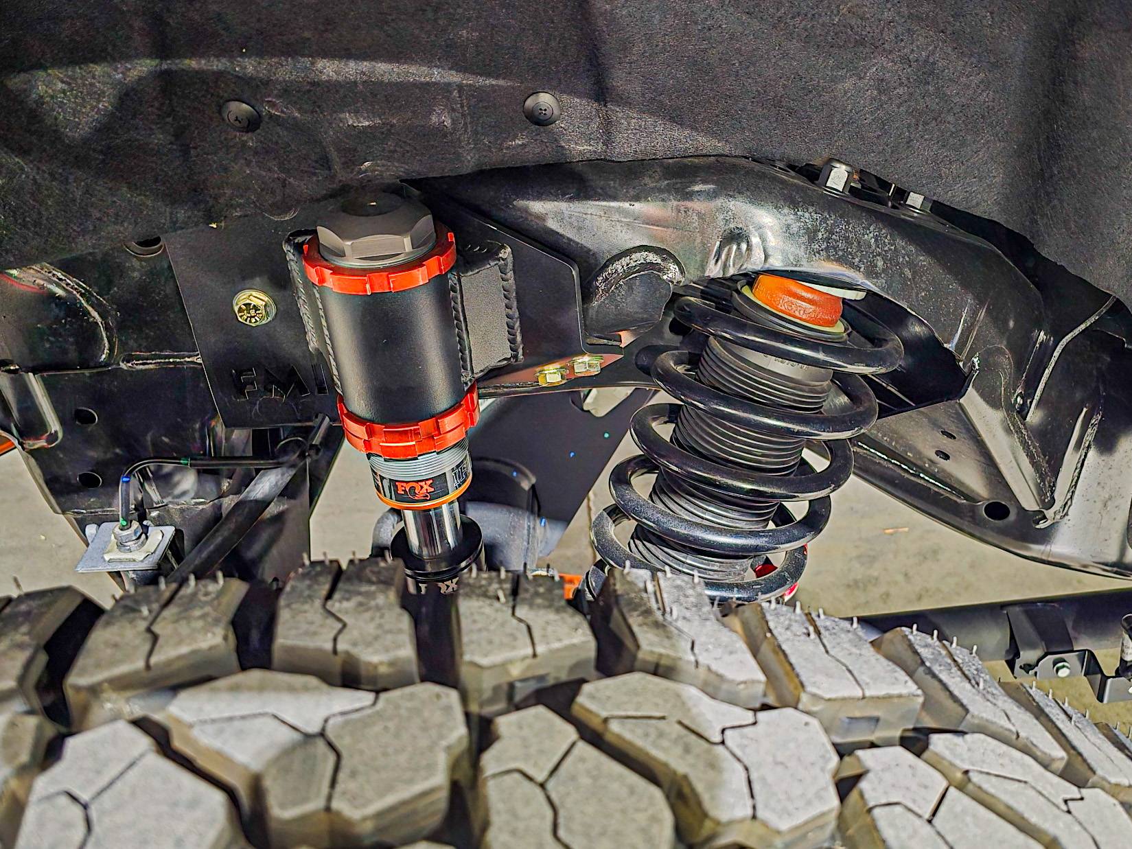

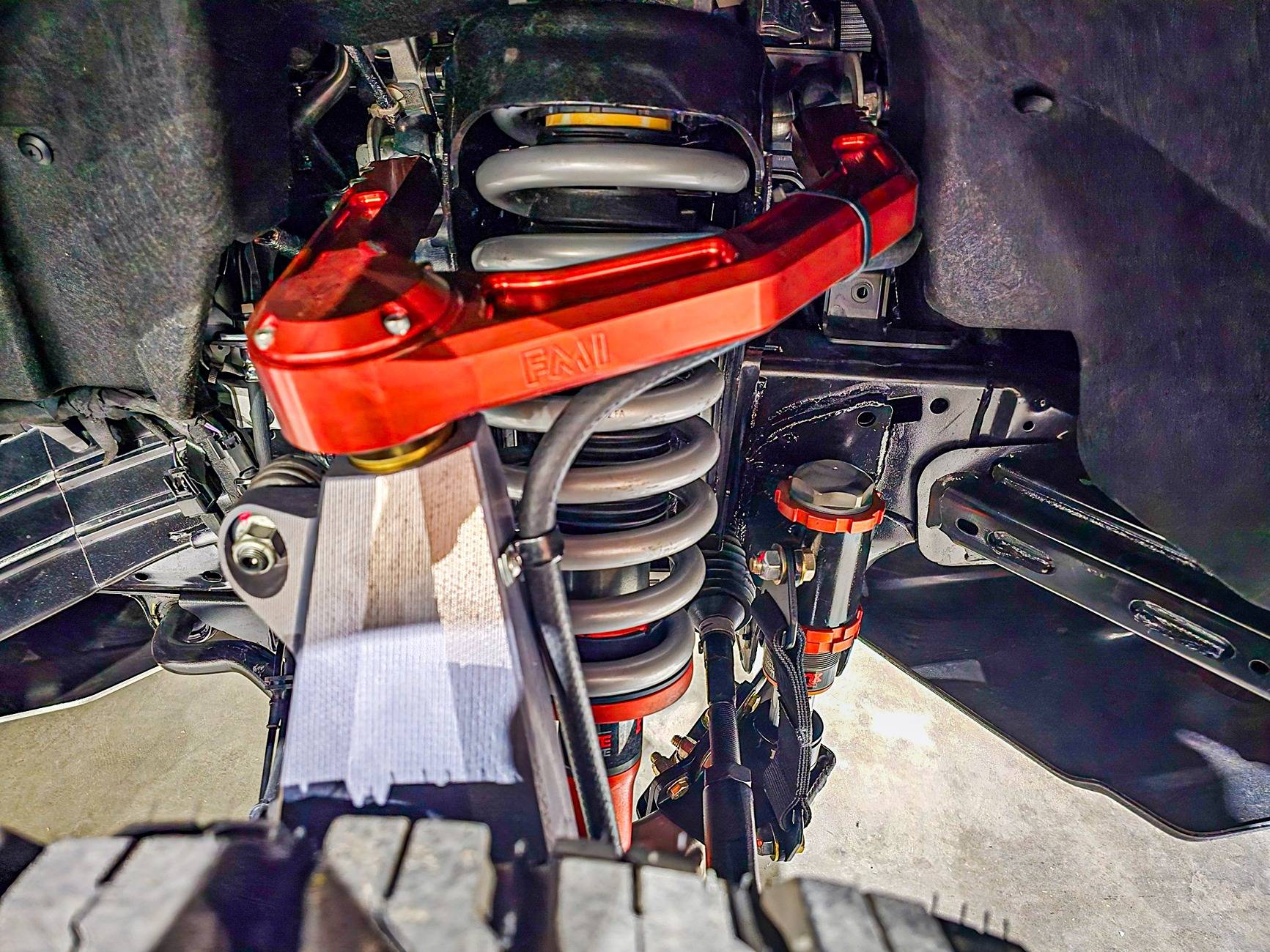

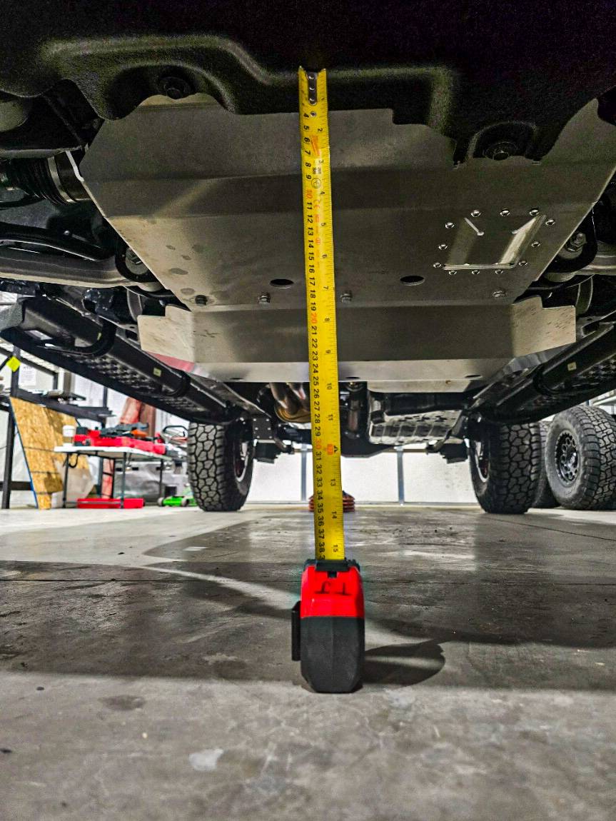

We're using the new Eibach springs with 2.3" extra length on front so plenty of clearance (plus Foutz bumpstops). 18.25" of clearance minimum.
Instagram @bajarangerraptor launching later today and will also be updating the forums as well. Happy to answer any questions.

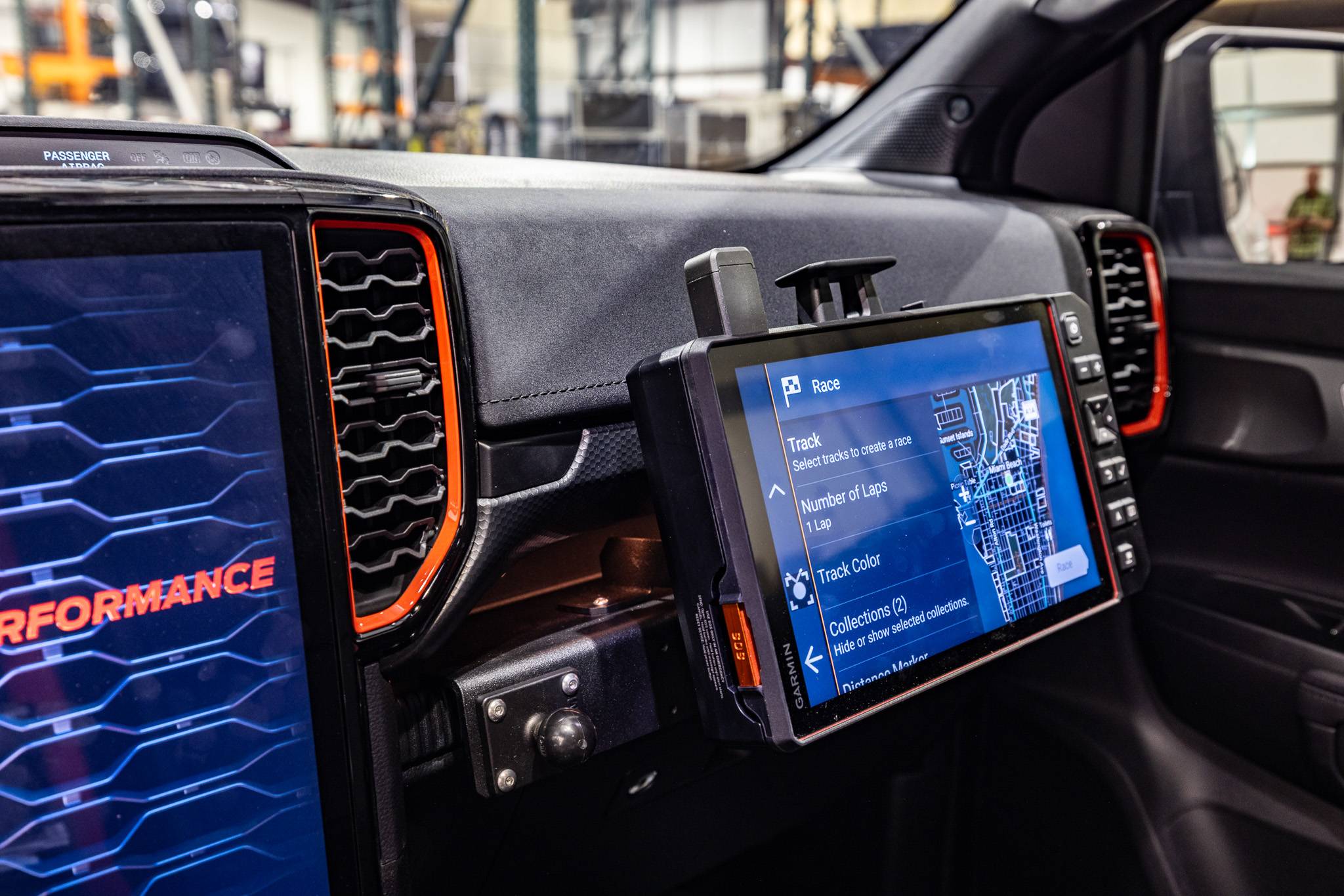

Did you do anything special with the switch setup for the baja designs lights or just the OEM overhead unit?

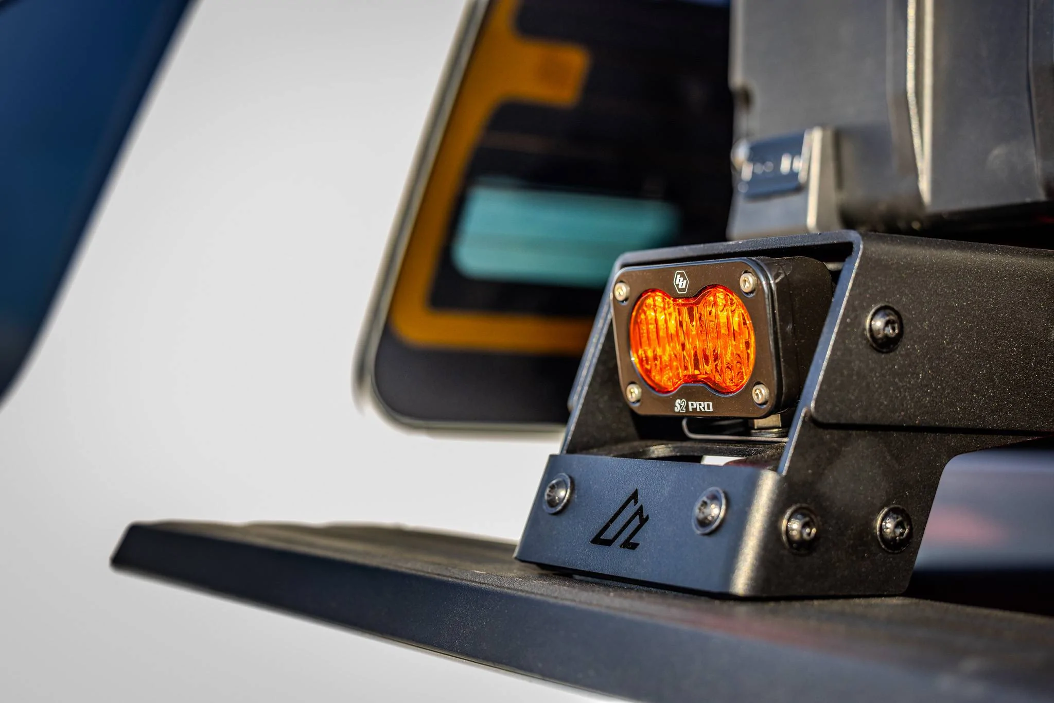

I used stock switches for my Bronco but Baja Designs have low beam that come on automatically with the headlights so we used an 8 switch Switch Pro setup on the RR. It fits perfectly in that overhead panel. I'll try to remember to upload some pics of it.
Having the 6 lights on the AAL Rails is amazing.
