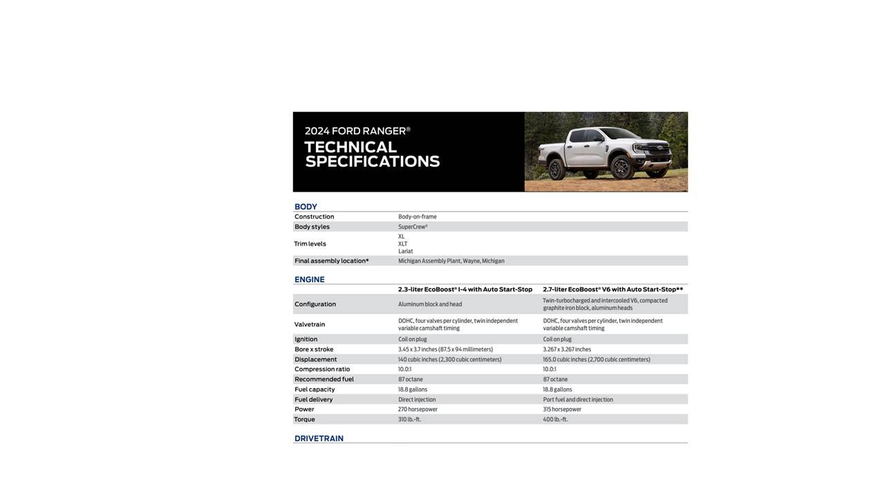

It was 91 octane which is also what the 2.7l requires/is rated with from the factory
Not surprised for the top hp, performance, towing etc. but IF that is a discouragement for any wanting the 2.7L engine but not wanting to run the higher octane gas, according to ford either engine runs fine on 87 octane.
Ford Ranger 2.7L availability 2_7L_Fuel
