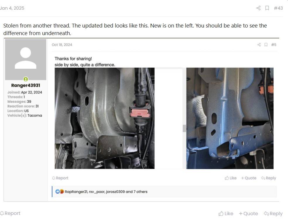

I have a December MY24. I am having trouble finding what exactly Ford changed so the brackets are not necessary. I don't think Ford just put the brackets on at the factory I can't see any. Maybe I am looking in the wrong spot. Are there any posts or pictures I am missing to see how the bed has been beefed up?
Correction: I found bad pictures from different angles. Riveted vs Bonded assembly methods. Still looks pretty weak. I am eventually going to beef that up so I don't crack the bed.
see attached. The left picture shows the updated bed rail support.
