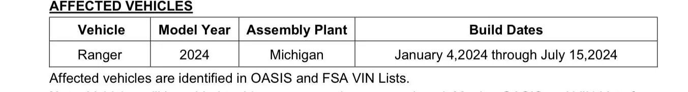

From we can read, Ranger’s build after July 15 ´24 would have the J Brace? as mine was built on 08/12.
Ford Ranger J Brace for 2024 US Ranger IMG_3212
Stu x 4
Stu
Jun 21, 2024
166
246
I crawed under and did not know what I was looking at; have Aug build. Are yours installed?
