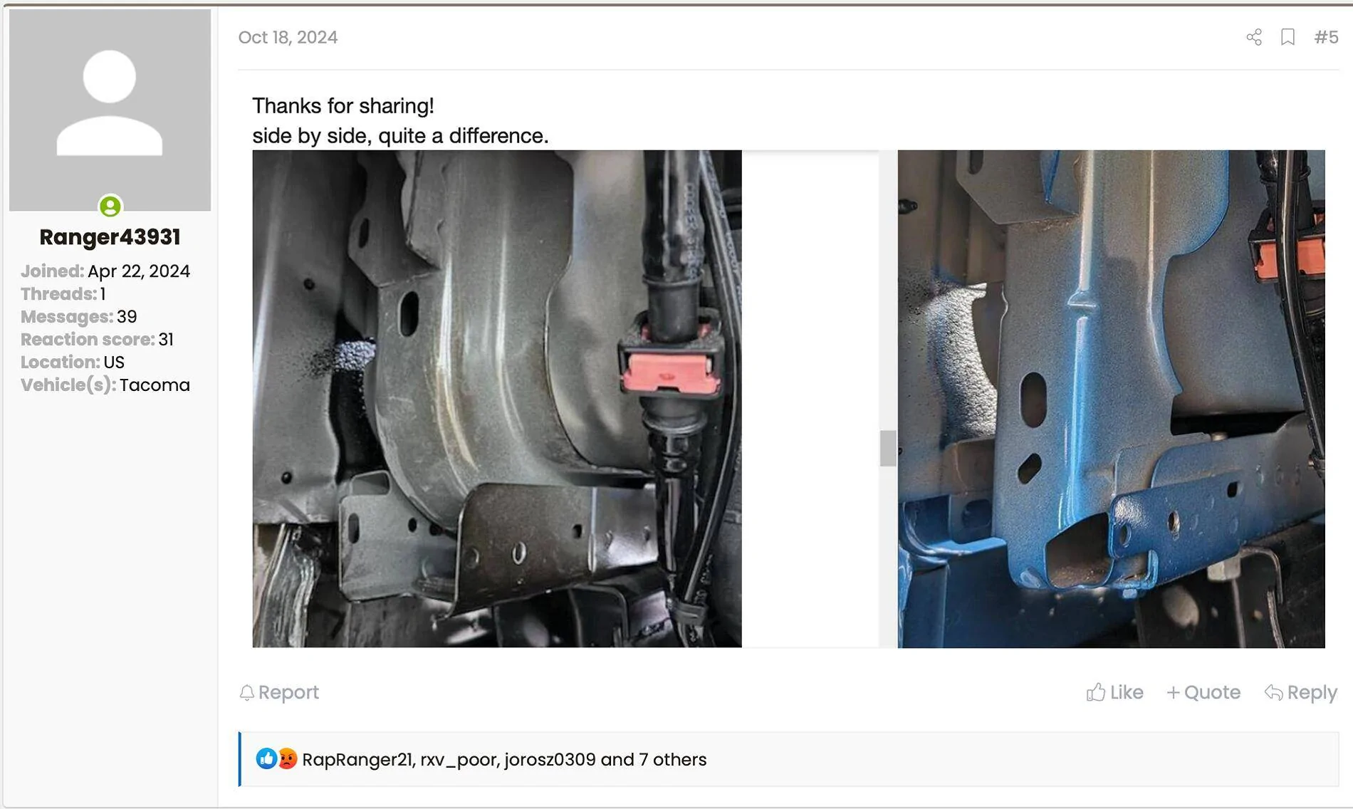

My date is 9/24 as well....so I'm curious to! Anyone have a picture of what the update is supposed to look like?
jedadiah
Jed
May 1, 2023
467
547
Kentucky
Stolen from another thread. The updated bed looks like this. New is on the left. You should be able to see the difference from underneath.

So rounded corner is good... I'll go look for that!
