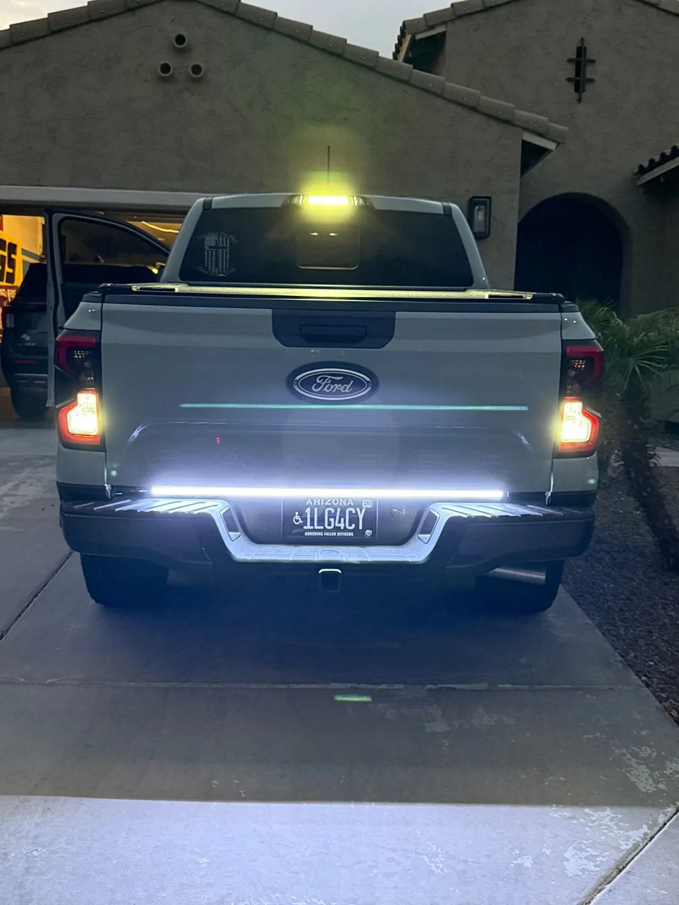

I know a bunch of people have wanted to do this on their rangers but with out a plug and play option out there it’s difficult. If you use the 4 wire plug at the hitch the truck freaks out and thinks a trailer is attached, gives faults for trailer tail lights not working and disables the blind spot/ cross traffic system.
I was able to get my hands on the wiring diagrams from a friend that works at a shop so I could hard wire into the tail lamp harness. If you plan on doing this modification you will find if you pull the tail lamps the harness to them is no help. All the wiring to the lamps is black wires. You need to get under the rear and out each outside of the hitch you will find a harness the you can follow up to the tail lamps I tapped in to this harness
i have attached photos of the harness diagram. Hope this helps you all out.
Ford Ranger LED tailgate light bar installed (harness wiring diagram attached) IMG_4048
Ford Ranger LED tailgate light bar installed (harness wiring diagram attached) IMG_4051
Ford Ranger LED tailgate light bar installed (harness wiring diagram attached) IMG_4196
Ford Ranger LED tailgate light bar installed (harness wiring diagram attached) IMG_4195

nice. i have one of those in the garage from a 2019 ranger. i keep thinking it would be cool on this truck

Does the light bar interfere with the access hole to lower spare tire?

Make and model of the light bar? Is it wired to both the left and right tail lights (for turn signal operation)?
it’s an Opt7 triple row with amber turn signals. Yes the turn signal wires are ran to each tail light harness and hard wired in.

No, the access hole to lover the spare is next to the license plate.
It will interfere with the access in a Raptor, the larger tire required it to be relocated.

Awesome, thanks for posting this. I have it in my Amazon shopping cart, did you use the magnets for mounting? Any chance you have a picture of where you tapped into the harness?

Are you not using it as a backup light? Notice you didn't use that wire.

Did you tap the reverse wire too? Since it wasn't highlighted in the diagram I didn't think you used it.
I am installing reverse lights on my bumper and was planning to just tap that wire (don't need park or turn), and trying to understand the wiring better.
Yes I did tap into the reverse light wire for the bar. Sorry I didn’t high light that wire on the diagram.
