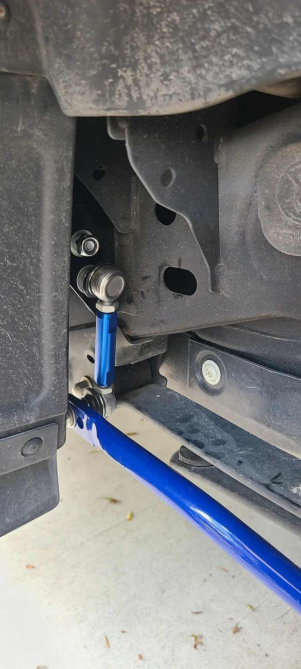

The kit comes with brackets, hardware, end links, and the bar. The parts that are steel are nicely powder coated and the hardware is 8.8 and above rated. It seems stainless but i don't know if you can get stainless rated like that. Whatever it is, its nice looking though. The end links are anodized and adjustable.
Ford Ranger Installing a rear sway bar on a 6g ranger 20250825_122246
Ford Ranger Installing a rear sway bar on a 6g ranger 20250825_130937

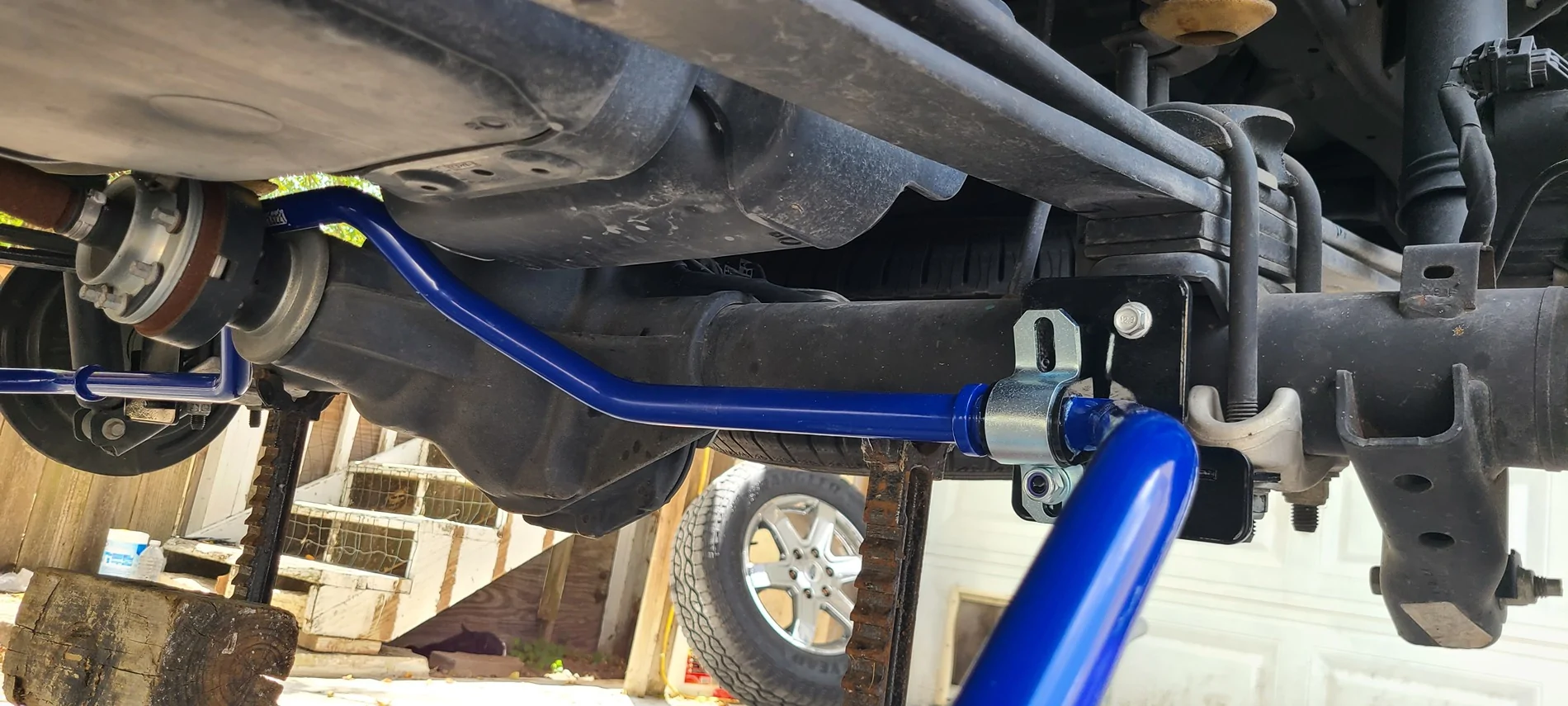

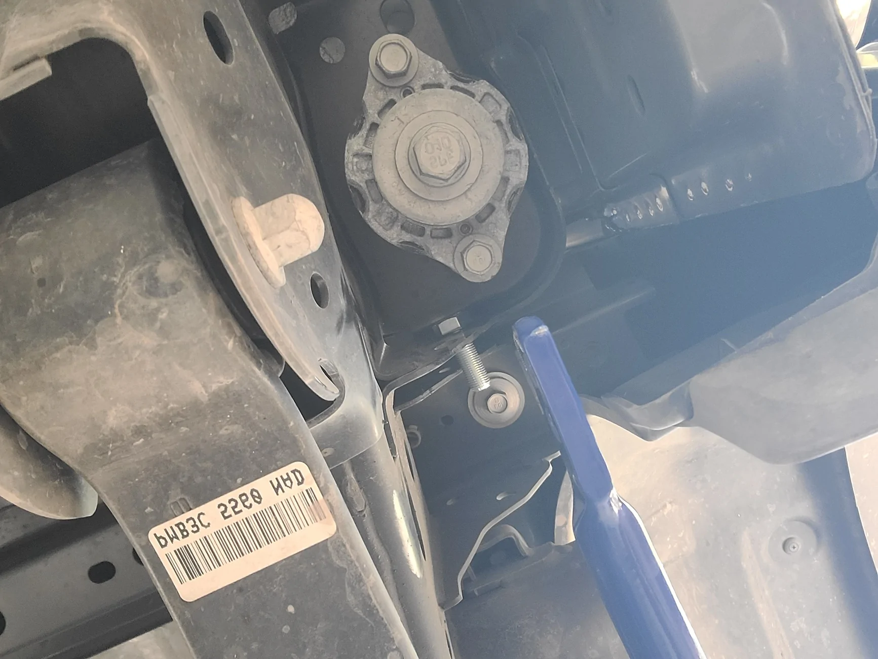

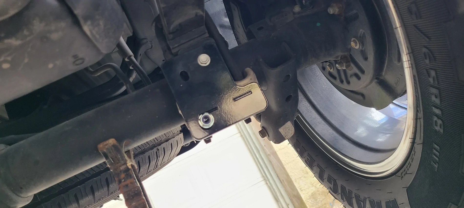

I started off with just lifting the back and putting jack stands to hold the axle but decided later to remove the wheels. You also want to put your jack under the nose of the diff to keep it from rotating when you loosen the front ubolt to mount your bracket.
Ford Ranger Installing a rear sway bar on a 6g ranger 20250825_132235
Ford Ranger Installing a rear sway bar on a 6g ranger 20250825_132353
Its very easy, and being only 100 degrees today, the install wasn't terrible, though i did take my time and pet the dog a bit while drinking water.

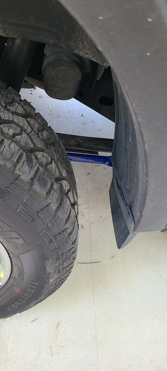

Here is what you see once its all done
Ford Ranger Installing a rear sway bar on a 6g ranger 20250825_140246
