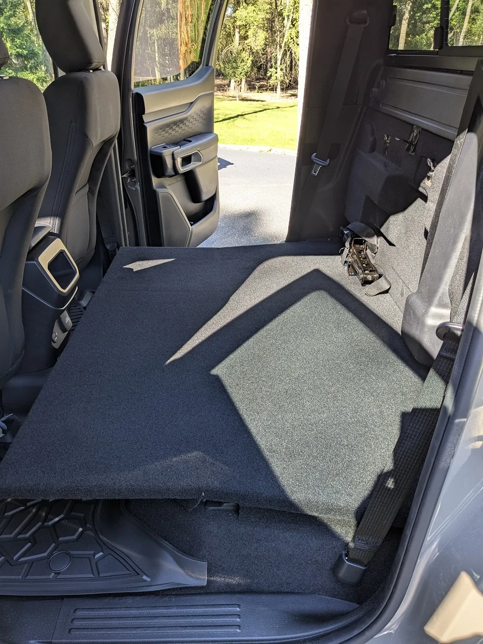

But I really wanted the new 6G Ranger despite the tiny 5' bed which is not good for hauling kayaks and bikes but I'll (have to) get used to it. The good news is the total cargo capacity of the CC is the same as the old SC, its just more goes inside the truck. So to maximize space and make loading/unloading easier a rear seat delete was the first thing on my list.
Within 2 hours of bringing my new Ranger home I had the rear seat out. It's just 4 bolts and it comes right out after monkeying with some elastic seat belt retainers. I haven't seen a 6G specific DIY seat delete but it's not hard to figure out (I did this on my old SC too). Using a 4' straight edge ruler I was able to find the highest point under the seat area, it's 3 raised squares along the back wall that's visible in the picture with just the short plywood piece minus the jack mount, which was cut out to get it as low as possible. I used 3/4" CDX plywood and instead of making doors to access the under seat storage I added a hinge so the whole thing lifts up, which also provides easy assess to the floor. The plywood is pretty stout so it doesn't require legs for the cantilevered part over the floor. You can see the attached underside spacers needed to support the plywood. To avoid any squeaks I glued and then nailed them with a brad nailer.
Tip, don't try and measure the locations for the seat bolt holes, use a template! I spent almost as much time trying to get those right than it took for everything else. It helped that I only had to work with the short section but was still a PITA. I used black auto/marine carpet from Menard's and 3M 77 spray adhesive with a few staples on the underside. Don't be shy with the adhesive.
I was planning on a plywood back wall too but now I'm just going to hang a moving blanket there and call it good. Not adding a back wall allows for maximum space too. I placed the jack upright and slid it under the back wall overhang so it's pretty much out of the way. It's secured with a boat battery strap but it needs stronger anchors. Not that I'll ever need to but this platform comes out as easy as the seats, just 4 bolts. There's no noticeable increase in road noise either but I might add some insulation to the back wall later. I think the total cost for materials was $75.
All the stuff I had in my SC under seat storage fits, even my 4 way folding tire wrench that's too long but fits under the plywood. My dog loves it too. I'm going to add some anchor points for securing coolers and plastic bins back there in case of an accident, or "gasp" a rollover.

I love me some 3M super 77 and I really think the shelf life is incredibly long. It's one of the things that is real useful to have around. I really like the design and implementation for the seat delete thanks for sharing the details.

Dude, you did a really nice job on this. The angles, the depth, the cleanliness of the finishing work/carpeting and the functionality of it all is just spot-on.

That's some very nice work, I might do the same with a 2/3 x 1/3 split but your idea is the inspiration!

Very nice work. Seems pretty well finished and quite good for your dog. Outstanding work, man. Congrats.
I will try that but with a split, trying to hide it under the seat when put down.
One question. under the seat, at the sides there is one post, each side, like long bolts with rubber Grommets. They get into a hole in the metal base when seat is put down.
I just can't imagine when are they used... Are they for preventing the seat rising up in a crash by grabbing the holes in the base?

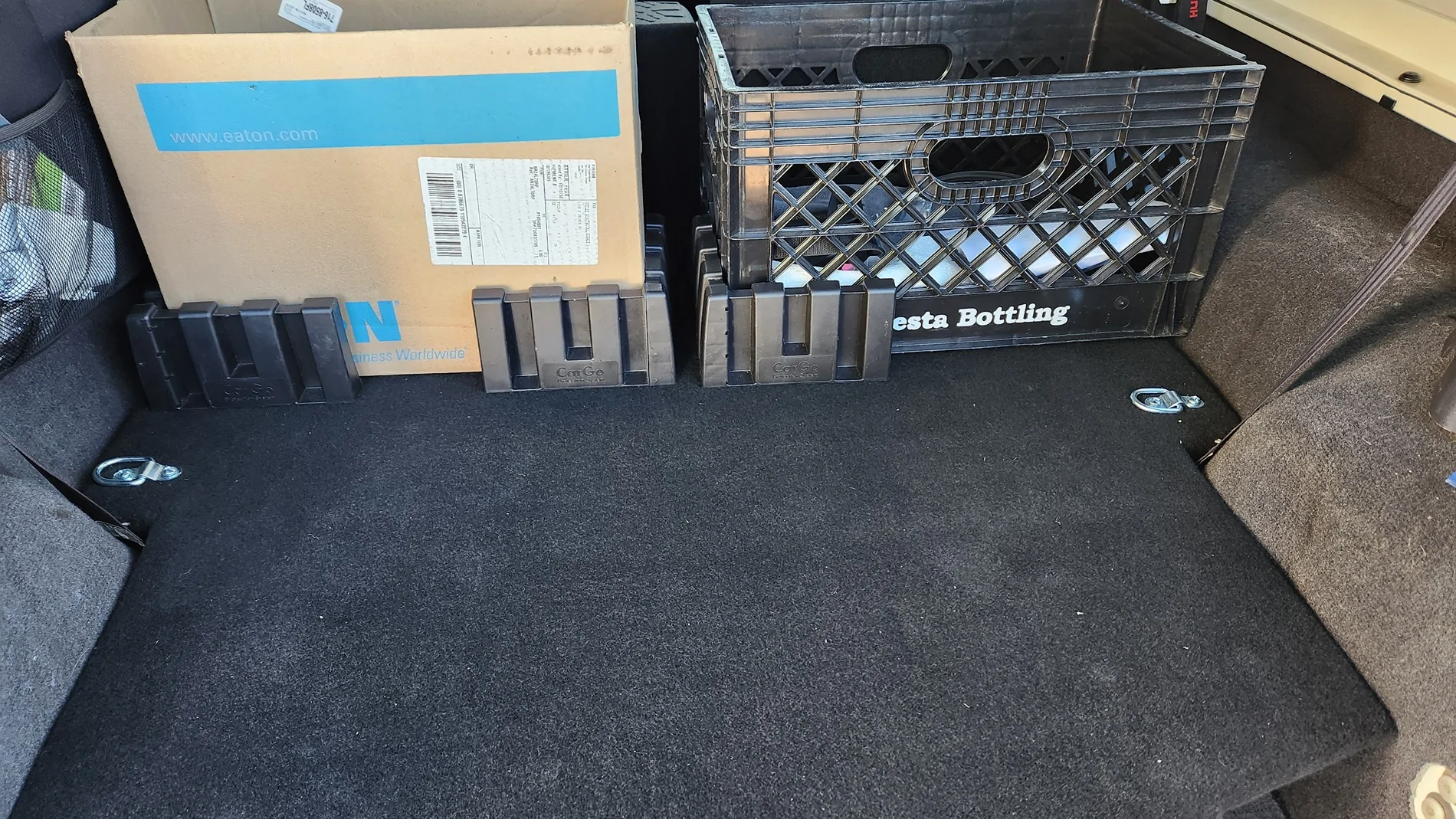

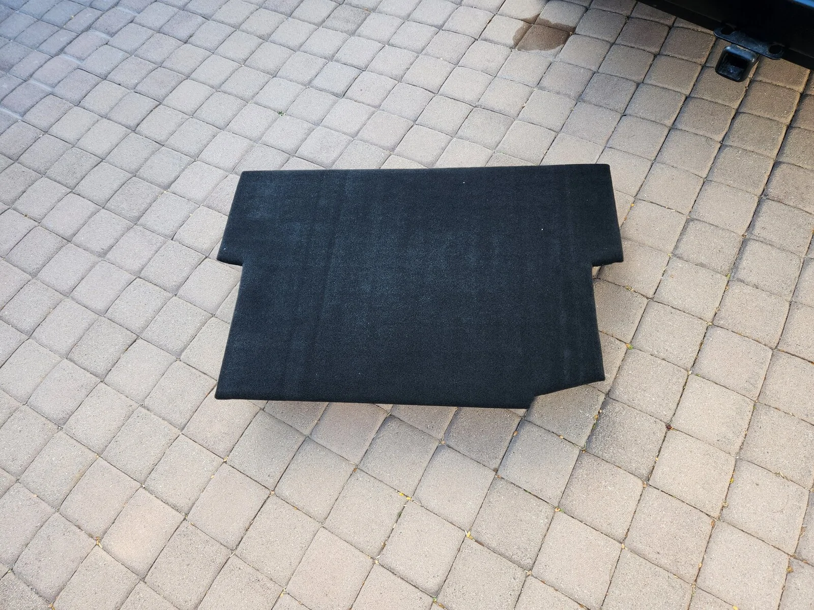

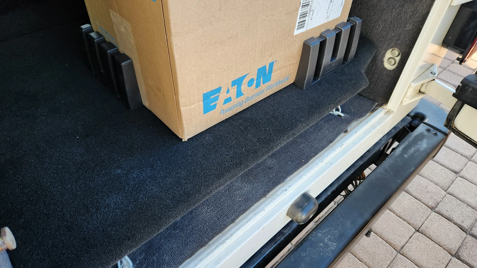

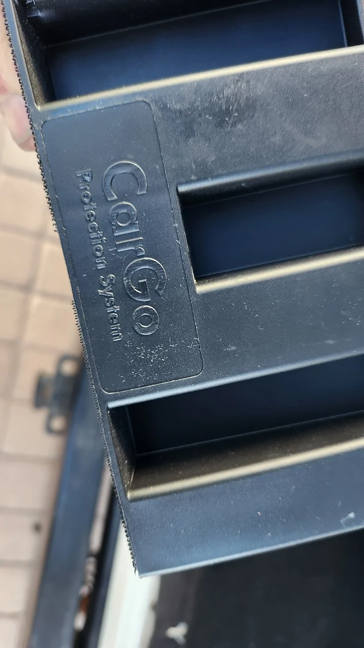

Nice work! I did a similar thing with my Jeep. I suggest you look for some cargo blocks. They come with some cars like VW wagons but you can find them on ebay. They stick to your carpet with Velcro to secure items like boxes and coolers from sliding around.
I use D rings to hold the cooler in place and cargo blocks for the smaller boxes and stuff.

Did you use hinges to raise it? I assume you did, but I didn't see a close up of your mounting boards in your pics.

Guide posts to help align the seat to the cab during assembly, most likely.

Thanks Pablo.!
So i think i could remove those posts and not make a hole into the DIY platform base.
I will try to get a Trunk Floor tray from a SUV (the Fiberglass or plasticky type, they are somewhat lighter than wood) and make it two piece with a hinge in the middle so when It should be hidden, the half piece folds towards under seat and hopefully will fit snuggly under it.
And to access the two under seat cargo spaces it would be difficult to hinge both pieces to fold up together... What could go wrong!

Looks nice! Short bed truck storage is a challenge without adding a shell. I did the same with my previous Tacoma, adding some sound deadening helped with the road noise you gain when the seats are removed.
