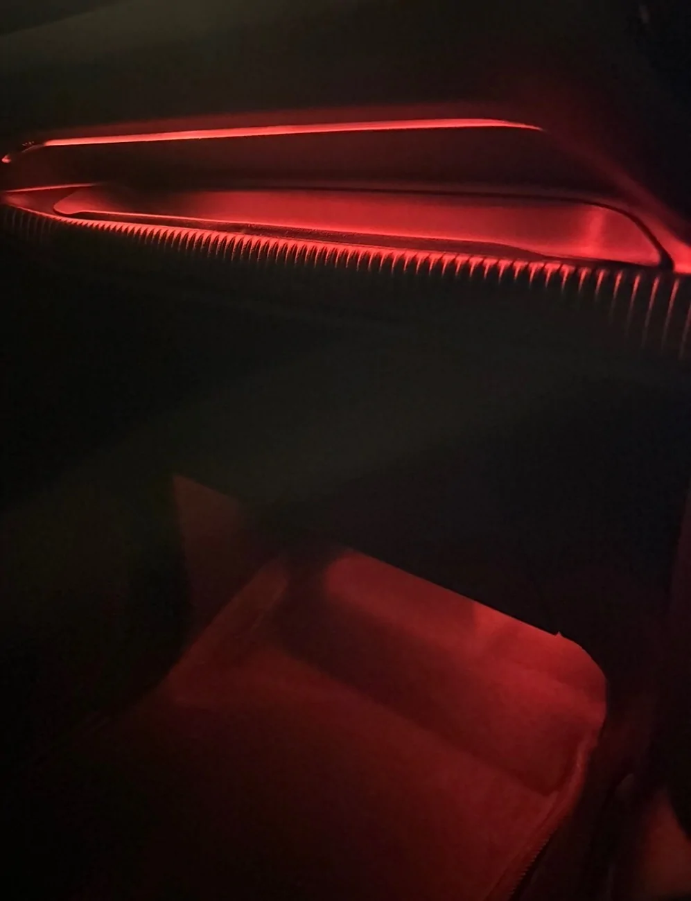

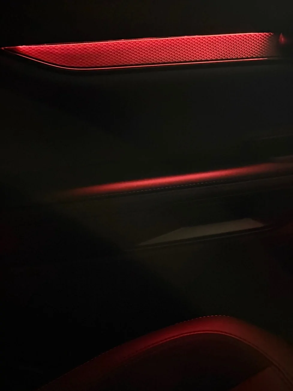

This was something I did a while back and wanted to share it.
Replaced all the existing orange ambient lights with ambient lights that are capable of 7 colors. Then used forscan to enable the menu to let me choose from the available colors.
I knew this was done on the f150s but didn’t know the process to do it on this.
This seems to be somewhat popular in Southeast Asia. I contacted few of them and I bought myself the parts (It was wiring and led bulbs)
Disconnected the battery and then started prying majority of the interior dash. The one that took a while was the light next to the wireless phone charger (under the infotainment). The others were quiet straight forward. Also routed two more lights to the footwells.
Anyways, I guess it was kind of worth it. I mean doesn’t really add much and I could definitely do without it but it’s nice to have.

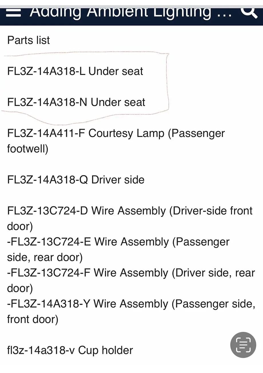

So there’s two options. You could either order the parts from Ford parts. You just need to find the part number. I don’t have the part numbers unfortunately. There was a post on the bronco forum about the same thing but I’m not sure if the same parts would work on the ranger. I have attached the parts they listed on the bronco forum. Again not sure if they would work.

Yeah red looks good. Also about the orange in these new lights, you can still choose orange but it’s not the same orange as stock. It’s a darker orange, almost like a red. I’ll post a pic later to show what I mean.

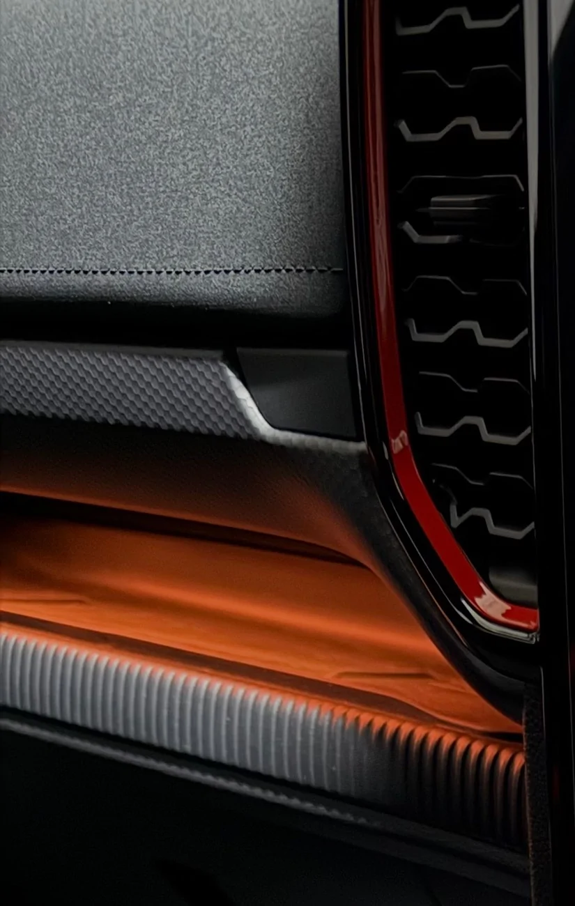

vaetryx
vaetryx
Nov 29, 2025
Abyss
This is what orange looks like with the replaced lights. The lighter orange is the stock light.
