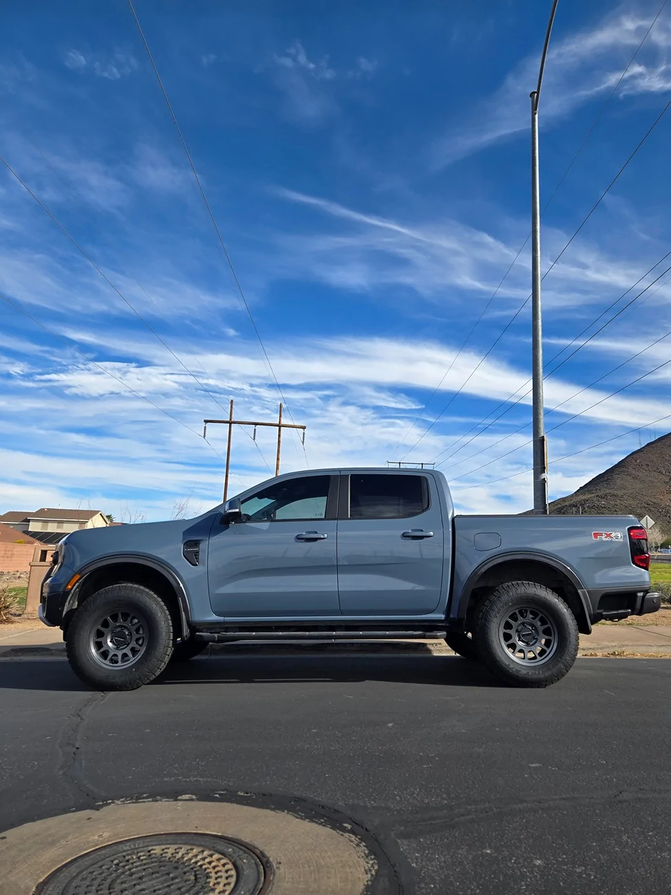

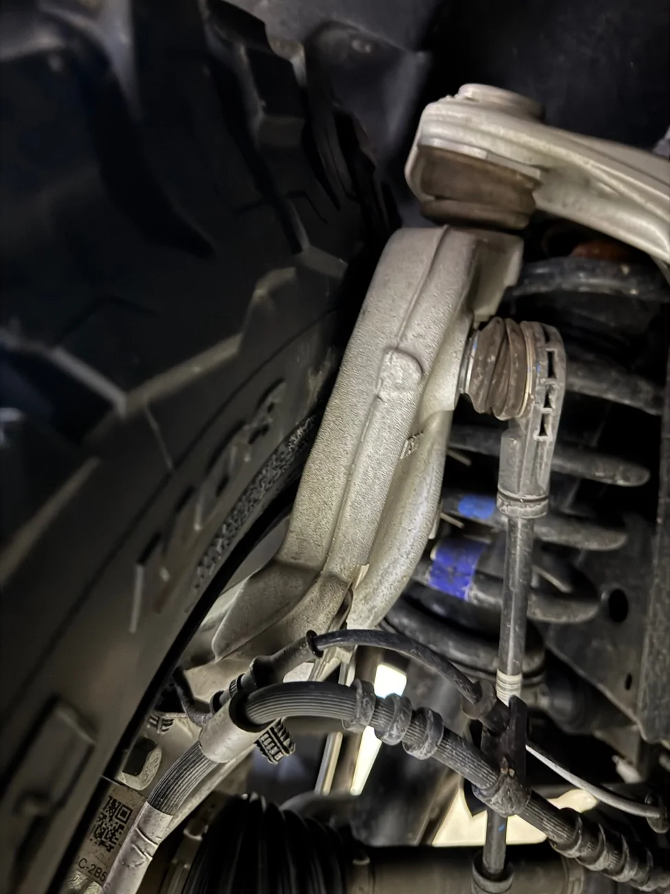

Dude, thats perfect! Close to the UCA, but look great!
Thats more clearance then you get from a 255 tire on a +55 stock offset rim.
+55 stock offset with a 285 clears but it’s crazy tight. Those +35s look like they have more than enough clearance .

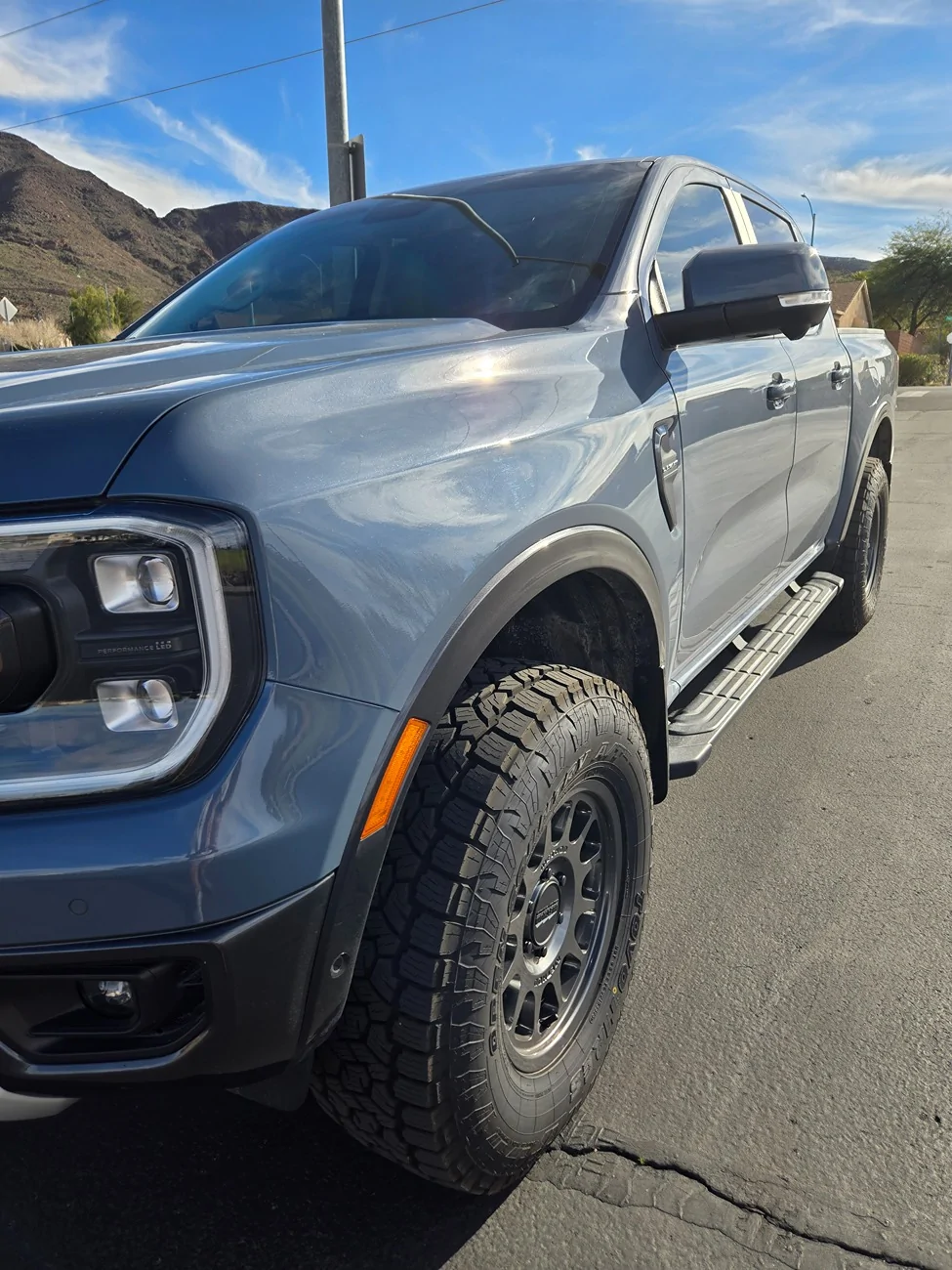

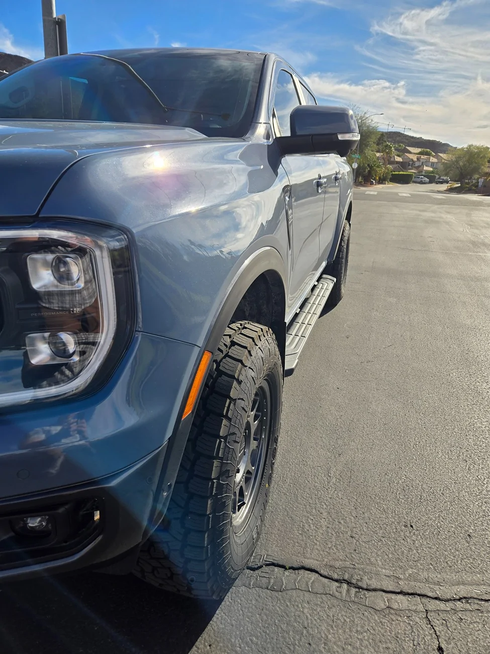

Yes stock height no spacers and stock +55 rims .
The wheels and tires are off my Black Raptor .
+30 would be better.

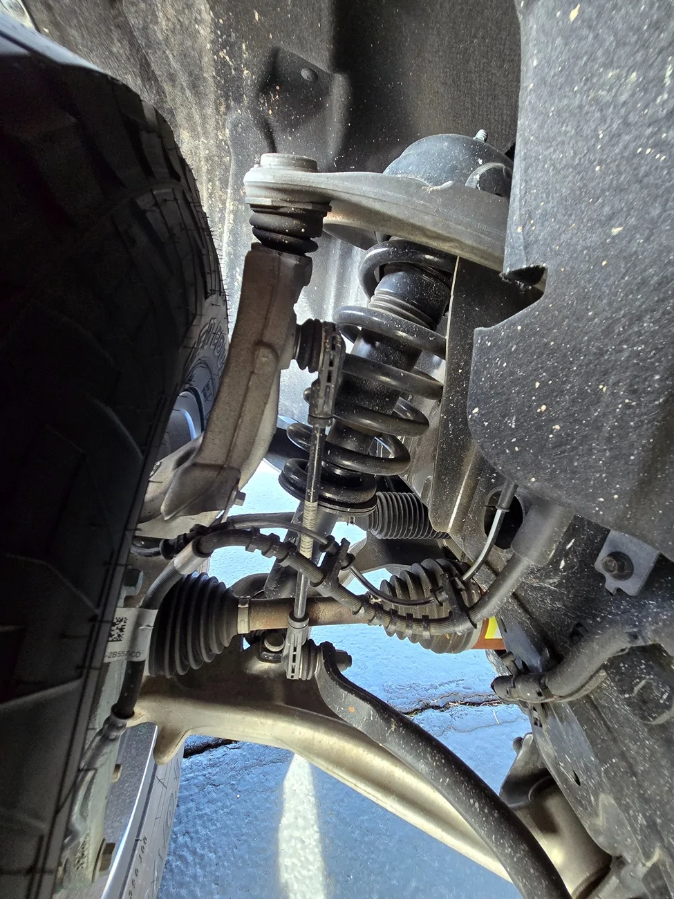

You would for sure need to remove your crash bars to have a chance at clearance that combo at stock height. I do have a very slight rub at full lock reversing only.

It would need lifted and still might need at least the front crash bars removed.

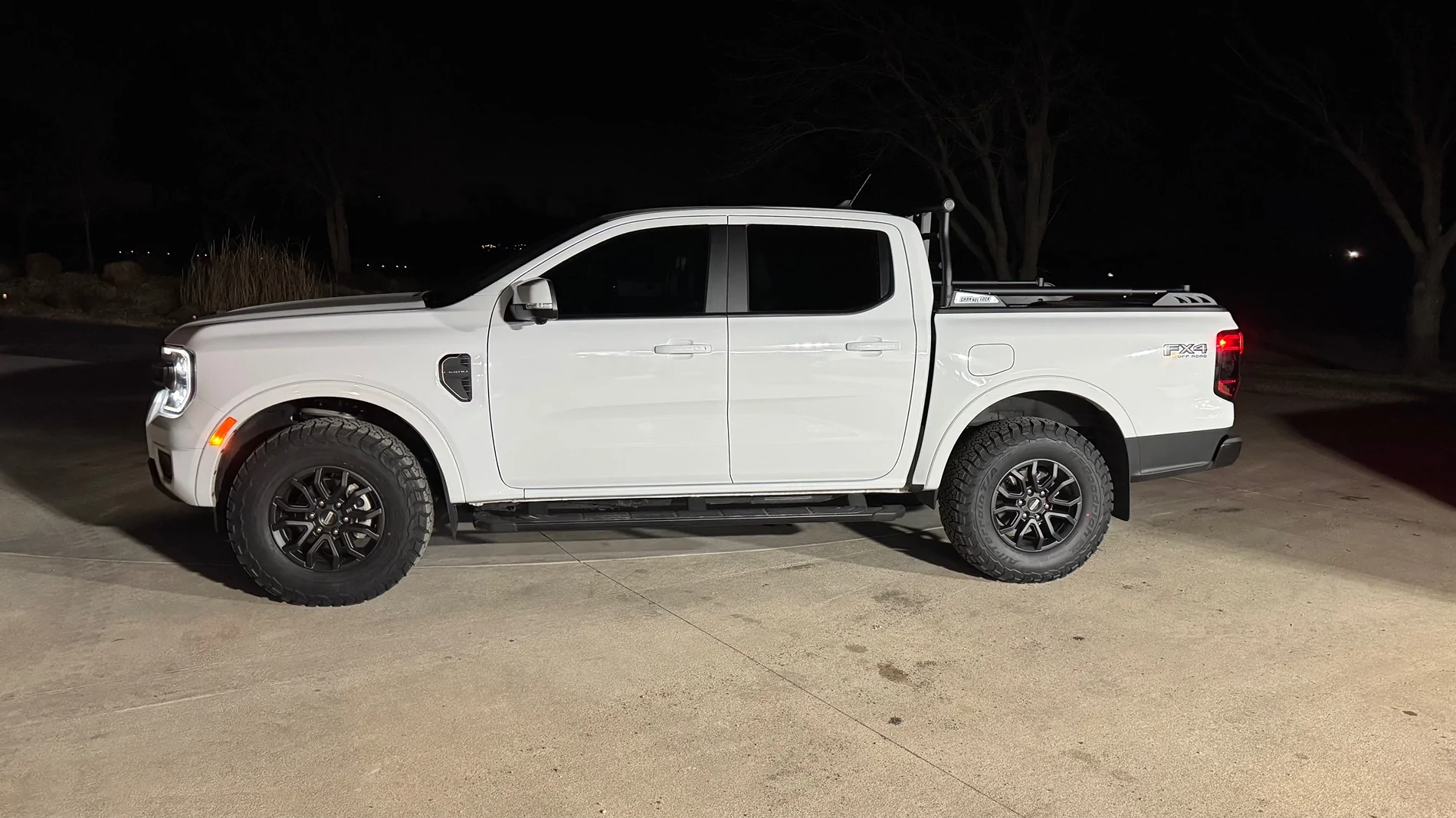

285/70 r17 toyo open country with stock 17" wheel size (from a bronco) and 1.5" level. Only thing different from what you want is mine is a 2.3 not a v6.
Looks great!!!
Any idea if they'll rub without the level?
