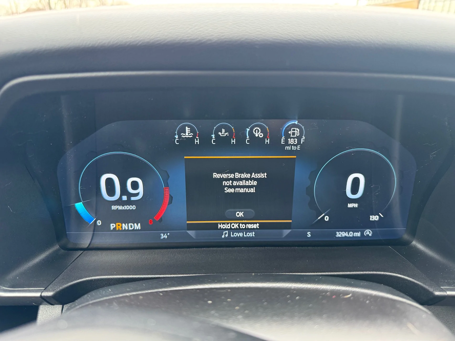

i have gotten this twice in the last week.
"A “Blind Spot Assist System fault” message may also appear on the dashboard."
i wonder if its related to this deal?

Yeah, I just read about it to and came here. I figured word was out. People may complain that there are so many recalls. At least there are recalls getting things delt with.

I have actually had this happen hauling a uhaul. I thought it was bad wiring on the trailer honestly.

thats what i would think also /\

Awesome news! I get that dang fault every time it rains even when no trailer is even hooked up
