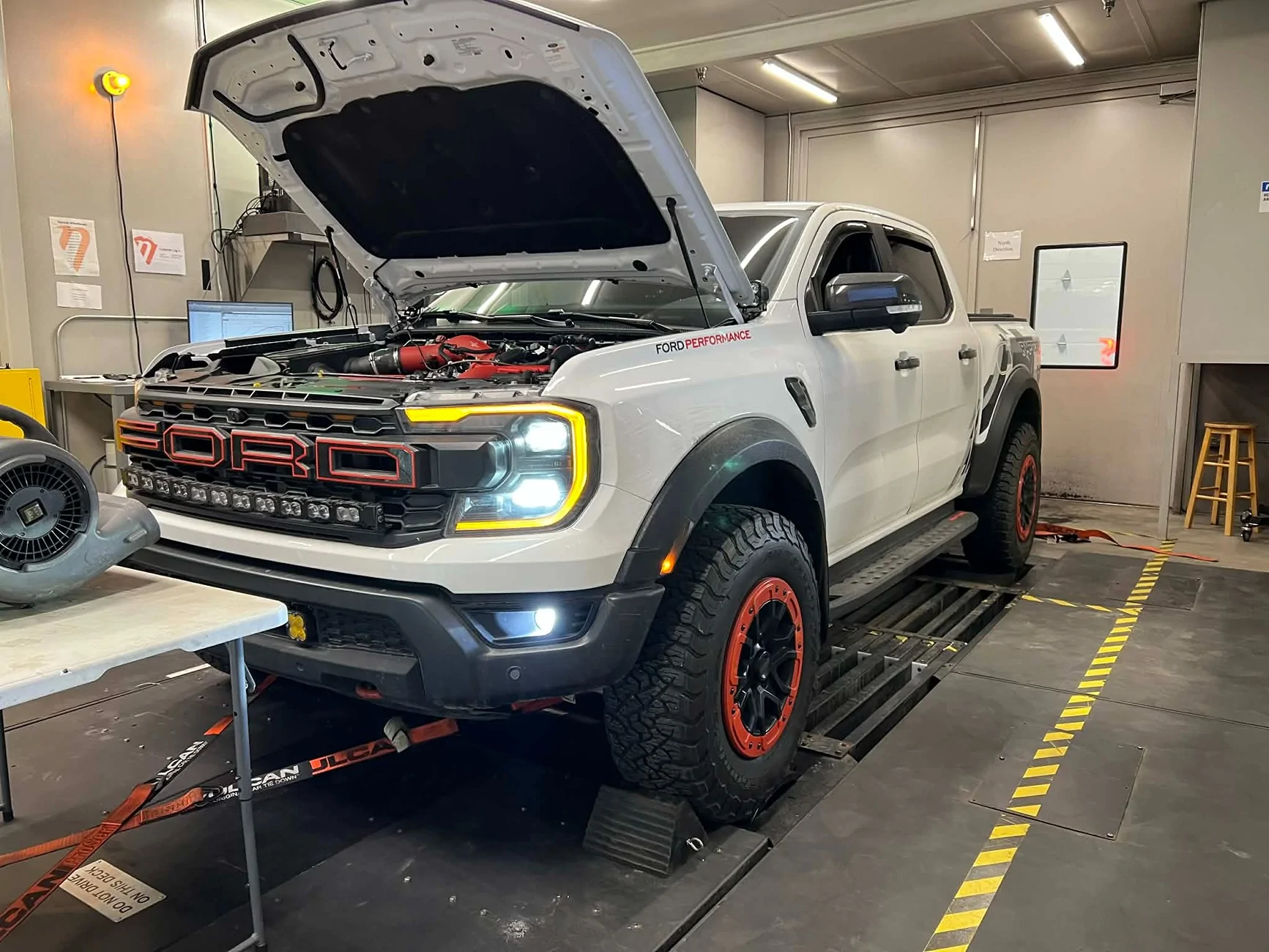

This past week I had the opportunity to get a buddy on the dyno at Nostrum, in MI. @FlyGuyRR
He had been planning on a big turbo setup, built trans, fuel system, and supporting mods to get it done for over 6 months now!
@DirtDerrick has his spec turbos out now, which is a modified Garrett Powermax turbo set (I can let him tell you more about them). But this is what he decided to do.
The Garrett Powermax turbos are not that much bigger than stock, so they are a mild upgrade, not a HUGE upgrade by any means. He wanted more power, less boost/stress/etc. That's what the modified Garretts offer with a little bit more lag than the standard Garrett turbos.

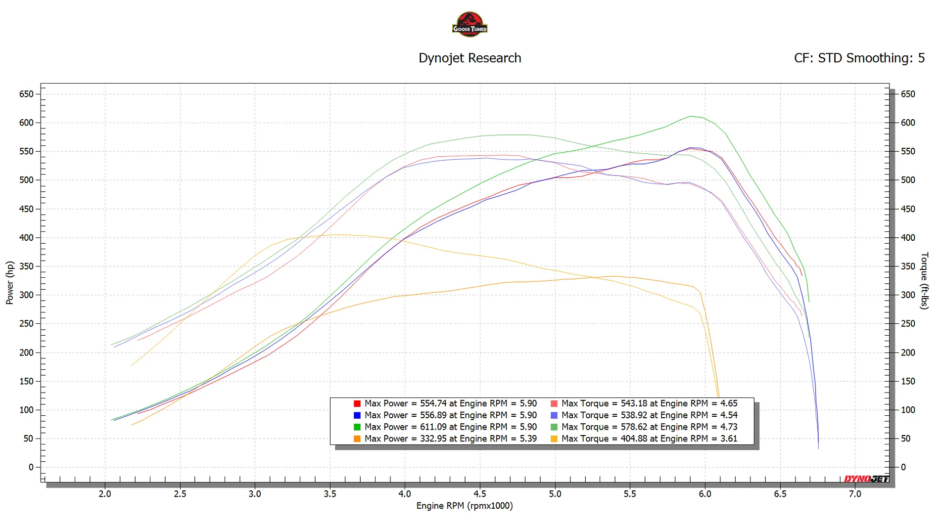

Here is where things get interesting! He was able to crank out 556whp 538wtq on 93oct with no additional ethanol! 10% ethanol! These are great numbers!
After finishing 93 we added ethanol and got it up to 65%. We ran out of fueling capacity/time to test other settings. He initially wanted to do the standard Garretts which the stage 3 kit would support, but after going bigger turbos and keeping the Stage 3 fuel system, we found right around here to be the safe limit.
611whp 578wtq was where we left it until he gets more fueling!
All in all, he's making almost 300whp over stock (as you've seen us do before on other trucks).
We'll be back with more fuel, and more power! Until then he has planned Baja trips coming and other cool things, so it's not just a street truck. He'll be in the dirt!
The RPM scale is off a little bit due to gear ration calc on dyno. Redline is 6500. That does NOT affect numbers.

Orange (stock) 332whp 404wtq
Red/Blue (93oct) - 556whp 538wtq
Green (E65) - 611whp 578wtq

How much more headroom do you think those modified turbos have with more fuel? Im assuming with the nano architecture of the 3.0 they can handle the power, but ultimately after fueling, power may be limited by the integrated header/head/turbine-inlet design.

This should make 50-75whp more, safely.
I don't push for max effort, so anything you see me do always has some sort of padding built in, unless specifically stated (which will likely be on my own R&D vehicles first)
