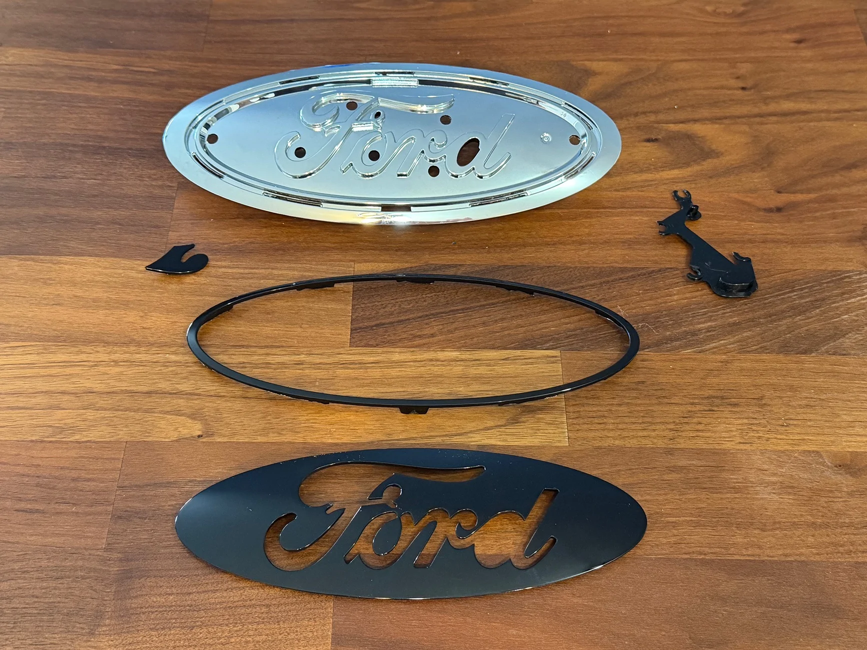

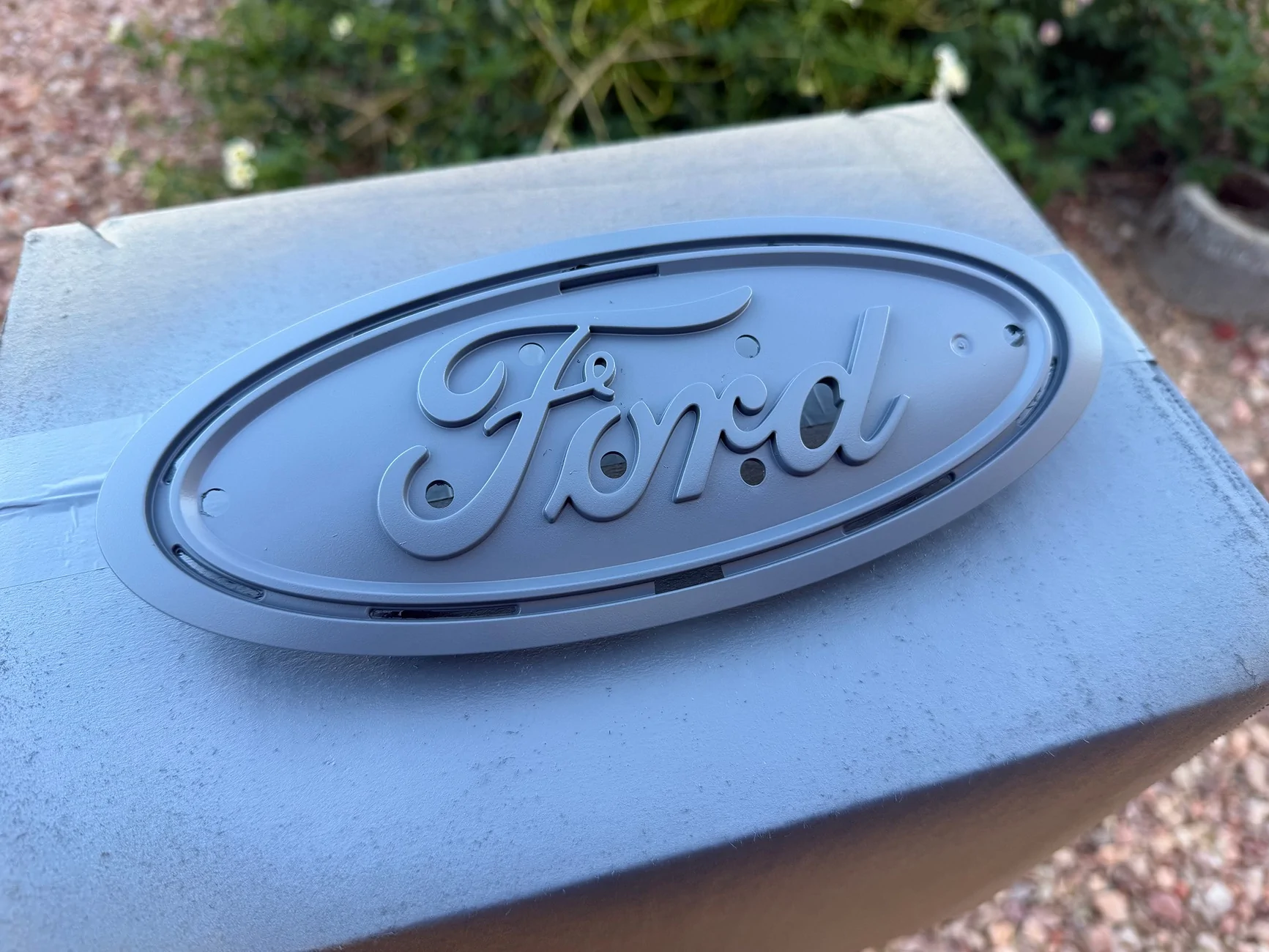

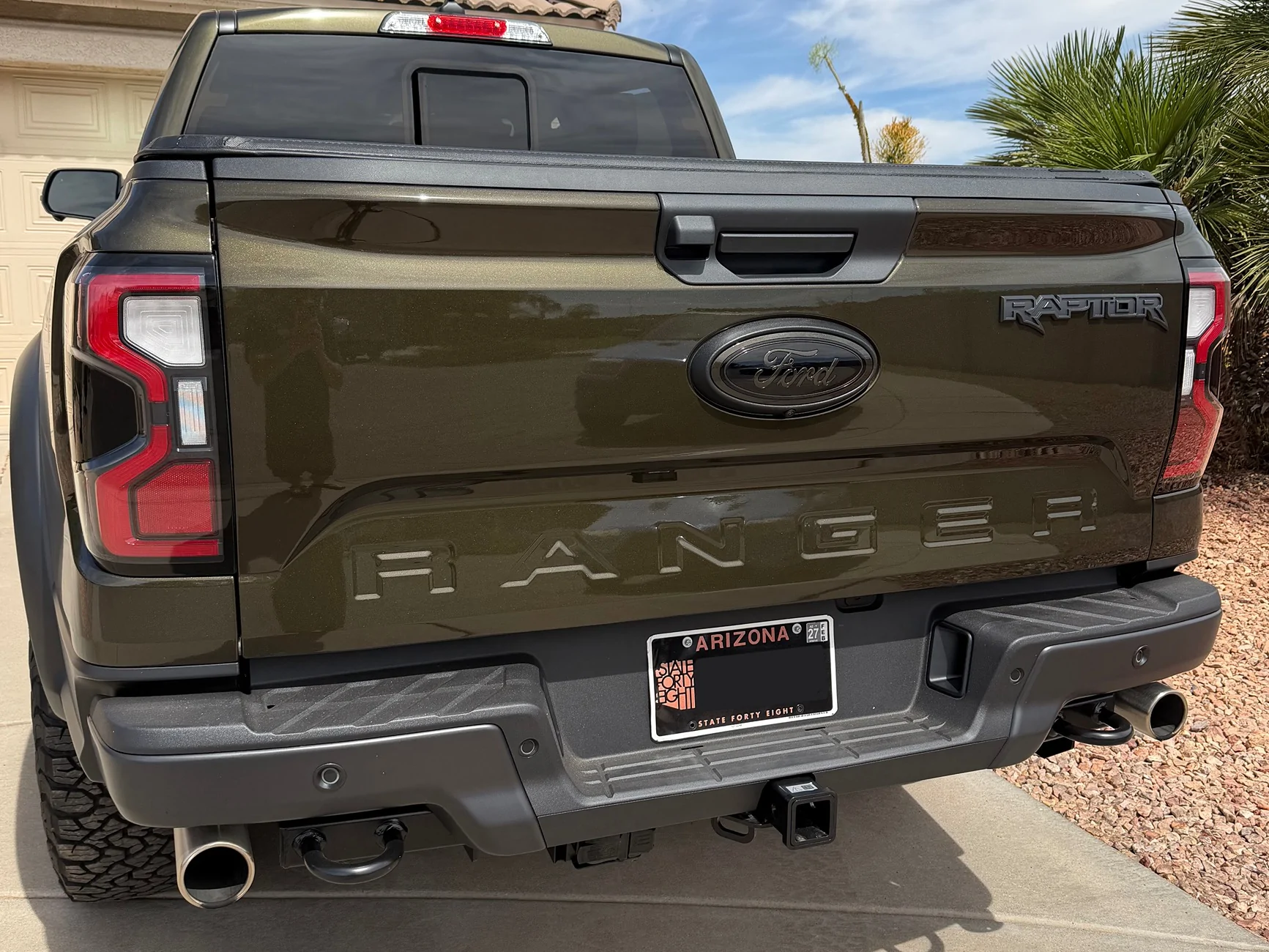

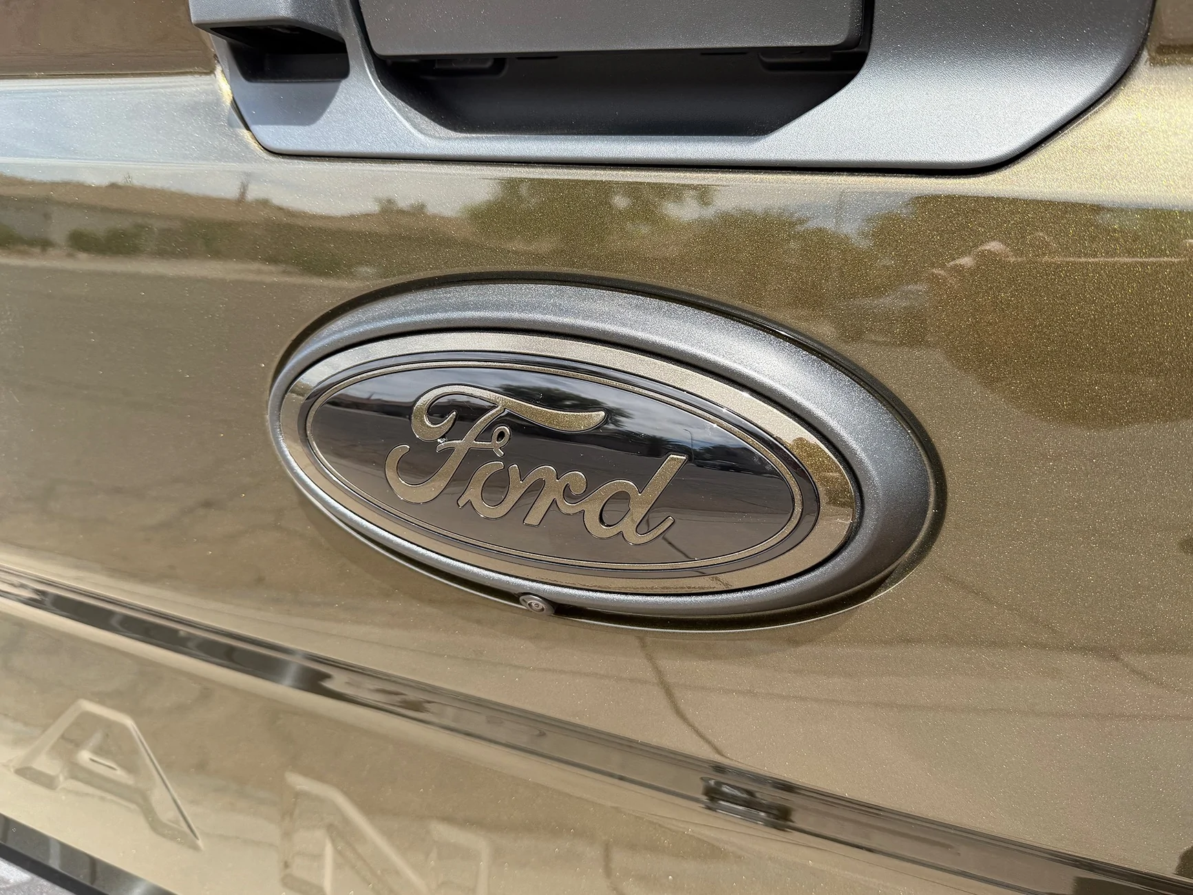

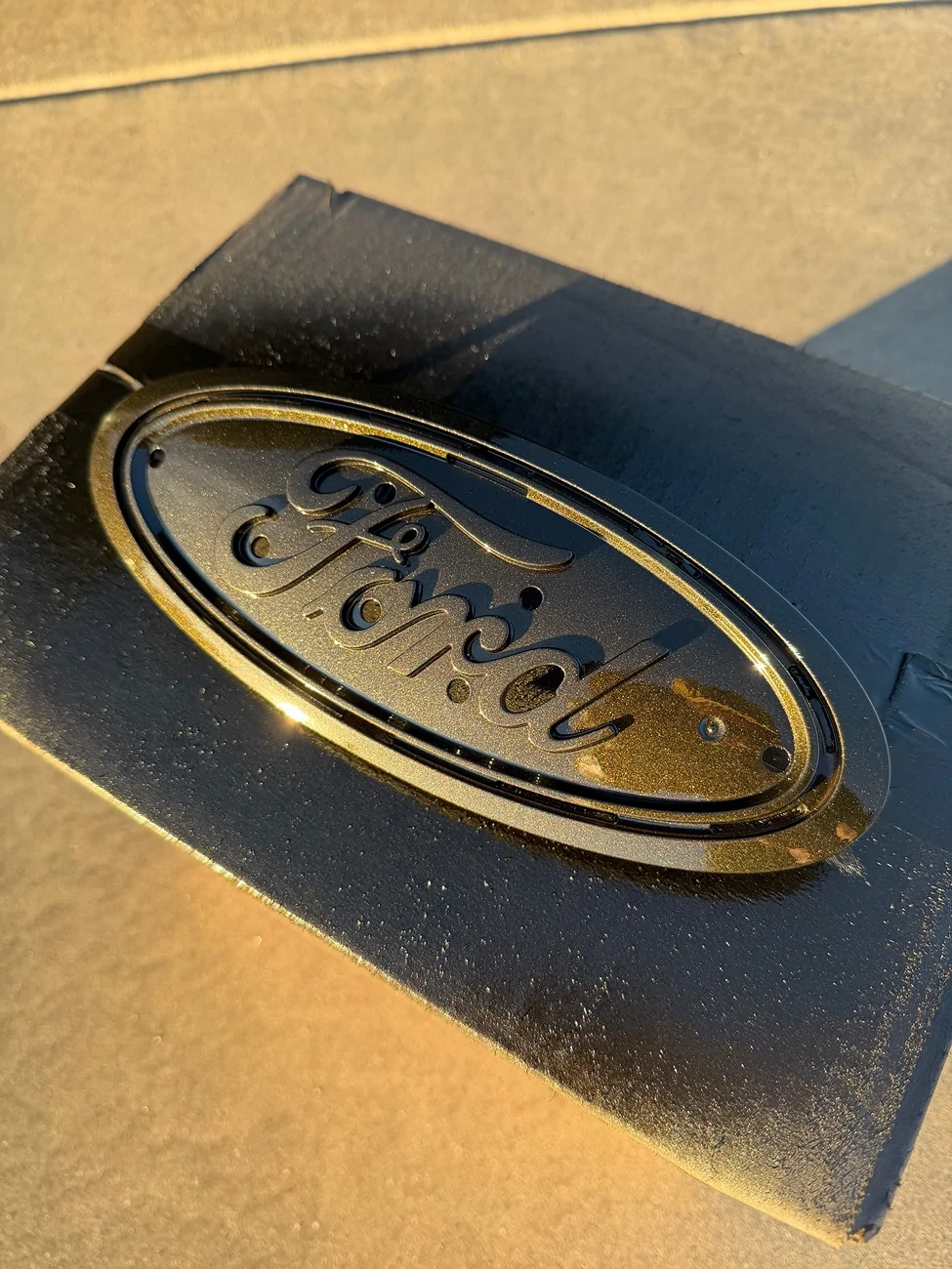

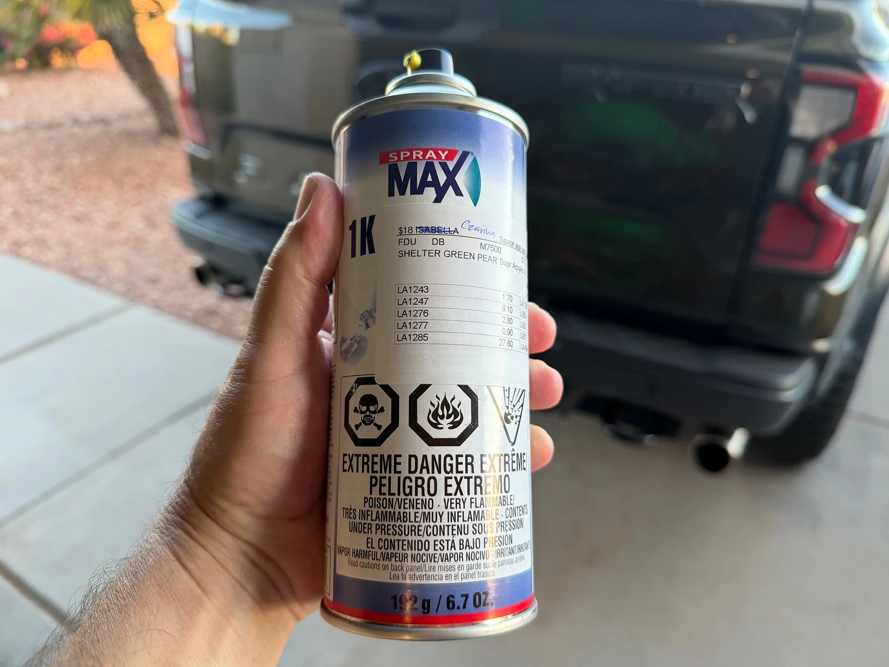

Noticed some painted emblems on Ebay but cost way too much. Figured I would DIY it. Had some time this weekend to remove the rear Ford emblem off the tailgate. The chrome was driving me nuts. Went down to a local automotive paint shop and they mixed a can up for me in Shelter Green. Everything cost me $45 for all materials.
Once removed you will need to Dremel out the black tabs on the back that holds all the pieces together. Just be careful some areas break easy. I learned the hard way pulling too hard. I scuffed up the chrome as good as I could. Paint never sticks great to these surfaces. Primed and painted and put back together with black silicone.

As hot as it has been in Phoenix already this year, that nice looking paint job will bake cure real fast. Really looks good on your truck.
No joke, its been pretty bad lately. With 105 for the high over the weekend it helped for sure. The mornings were perfect to spray!
