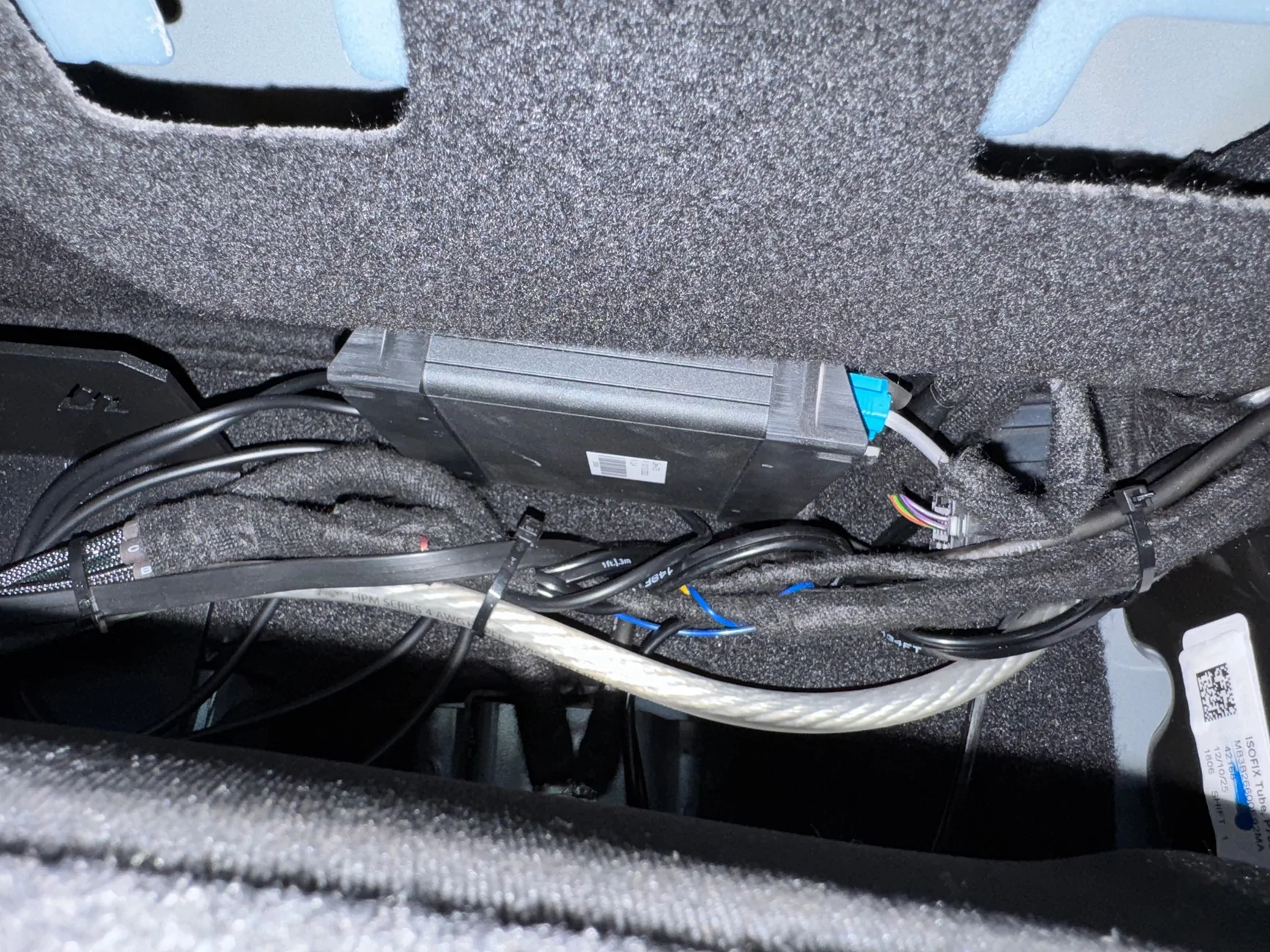

I bit the bullet and did a complete sound system upgrade on my 2025 RR.
My local car stereo shop did the installation. They recommended running the head unit in stereo mode instead of surround sound, which is what I was already doing anyway. Since its in stereo mode, they disabled the center speaker and rear door fill speakers.
Here is what they installed:
Audio Interface: NAV-TV ZEN-F25 (2.0). They recommended this unit since it has excellent audio quality. It converts the factory signal to digital and sends it via TOSLink to the new amplifier.

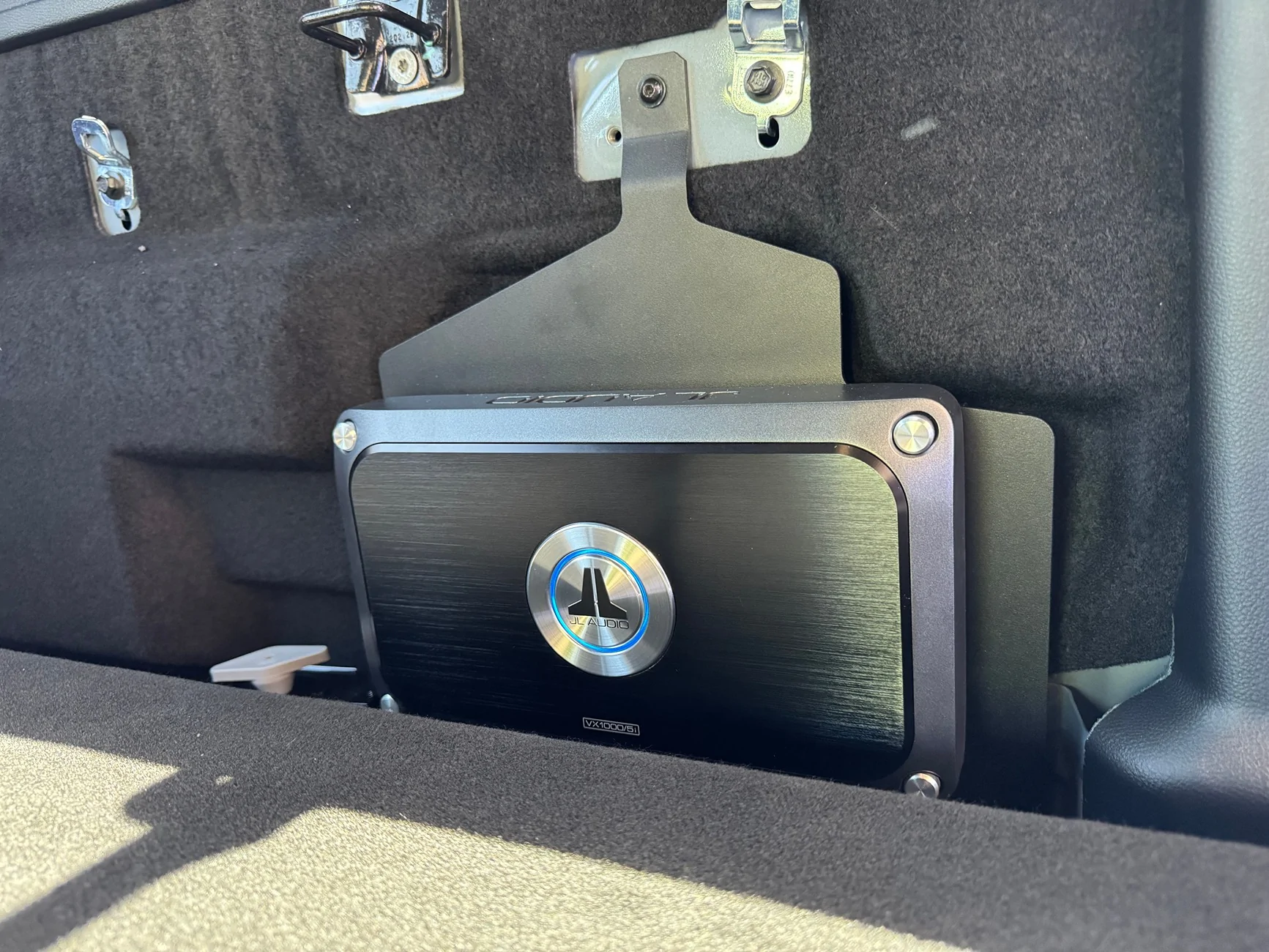

Amplifier: JL Audio VX1000/5i. They also installed the DRC-205 amp control knob. The amp rack behind the seat is from American adventure lab.

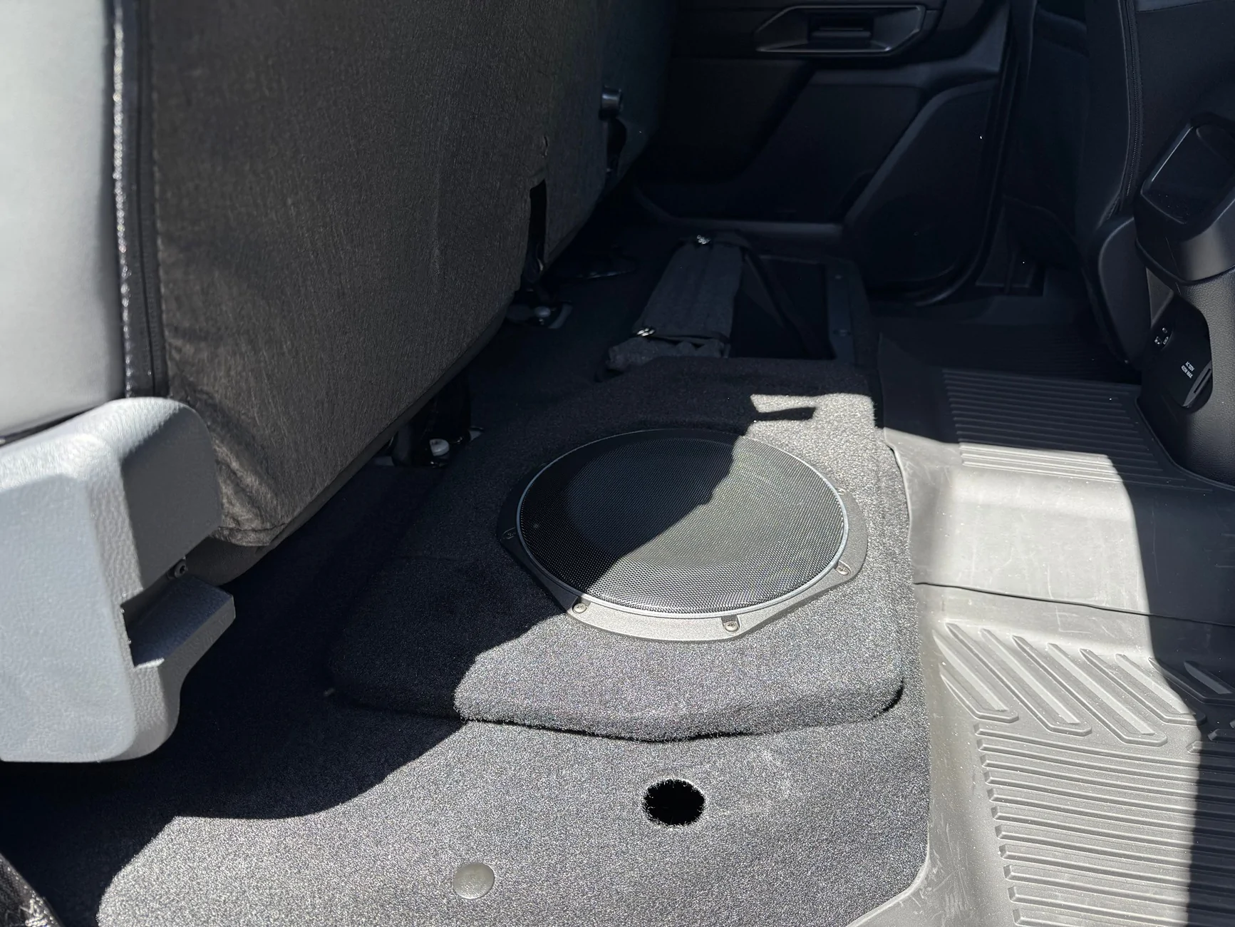

Subwoofer: JL Audio Stealthbox.
Speakers: Focal ES 165 K2E woofers in the front doors and tweeters in the pillars.

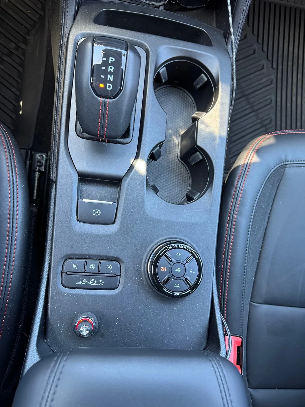

The installer set up 3 tunings that I can toggle between on the amp control knob in the center console. 1 tuning for driver plus front passenger. 2 tunings for driver only which have time correction.
I'm super happy with the results. Here are some photos:

Looks super clean and given the parts list you provided and the professional installation you sprung for (I would do the same) I'm sure this is a killer setup. Very well done OP! Enjoy your rolling symphony.

Everything looks super well integrated. The subwoofer is installed in the perfect place. You could run with the rear seat folded up and the thing will sound free and tight. And the sound taken from a digital source, oh my. Great great setup. I guess it sounds quite well.
Thanks! Good idea on running with the seat up. I will try that.
It sounds great. I took my cd collection and ripped it in itunes to create apple lossless files. I put those files on a USB stick and plugged it into the USB port on the truck. So the source is the best possible.
