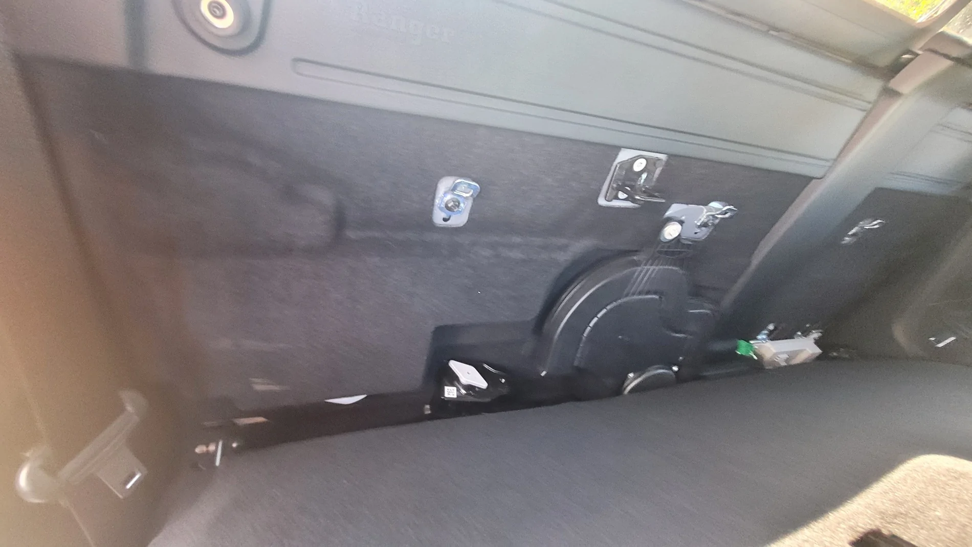

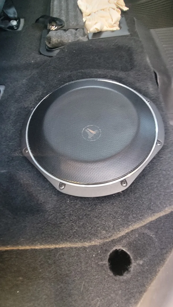

I just added a jl stealthbox, jk 300 mono amp, kicker key lock w/ sounds good adapter and tuning. Combined with door soundproofing, focal is690, kicker ks350 and focal acx165 rear ot sounds amazing. The factory B and O amp push the focals nicely. Getting rid of the factory sub and replacing it with a quality 10" sub is a game changer.
Very happy with the results.
Thank you to all on this forum that provided information so I could make a well thought out purchase/installation. My truck sounds perfect to me.

I did the Focals and sound deadening today, It makes a huge difference....Sub install next weekend. Good to hear the sub is worth it. I'm doing a Hertz mps 10" with their DP 1.5 and the SGS kicker key lock. Did you take your rear seat out for the install?
